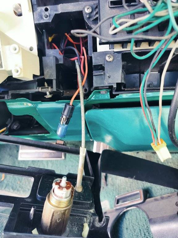

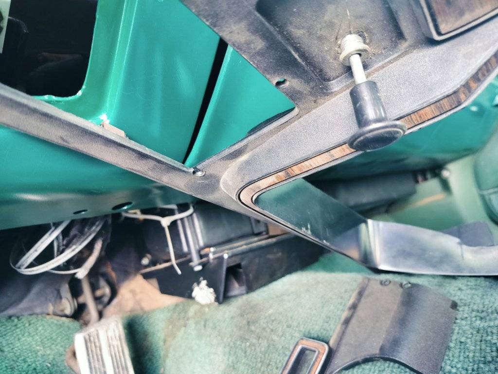

Here is an image of the choke
How do I remove it?
It's going to depend on how it's hooked to the carb, but yea... Basically unhook it from the carb and and pull it back through the dash. It looks like the nut that holds it in the dash is missing so that makes it easier.
