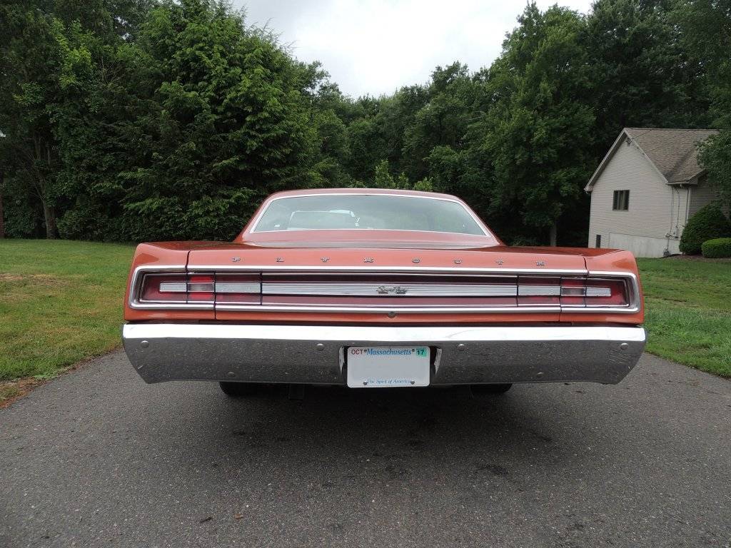

Hi all,
I have been working on my Fury for 1.5 years now. Yesterday I drove her on the street for the first time ever. What a great feeling!
I was thinking maybe someone could advise on a couple of things.
Hot start issue... The car sat 15 min and as you can see in the video - it did not want to start with throttle closed. Edelbrock Performer carb and Edelbrock Performer intake. Since I don`t have much hood clearance (only 3/8") I cannot put a thick spacer. I was thinking maybe 1/8" gasket and thin aluminum heat shield?
Heat crossover is not blocked - is there a need? What is the down side? Really don`t want to pull the intake, but if I have to - I will.
Second thing I am not happy about is exhaust drone. 2.5" dual exhaust with h-pipe and Summit turbo mufflers. I am looking at Dynomax super turbo mufflers and Flowmaster 50 or 70 series... I am afraid those might sound similar and I will waste my money... I do not want loud exhaust, in fact I prefer it on the quiet side with a noticeable tone. What do you folks think?
Love the car.
