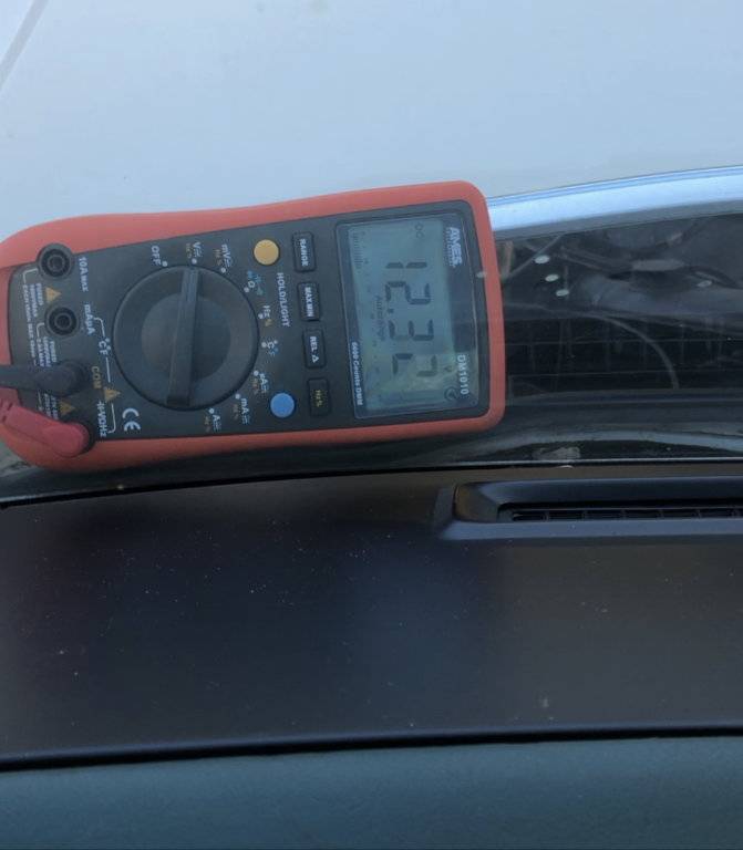

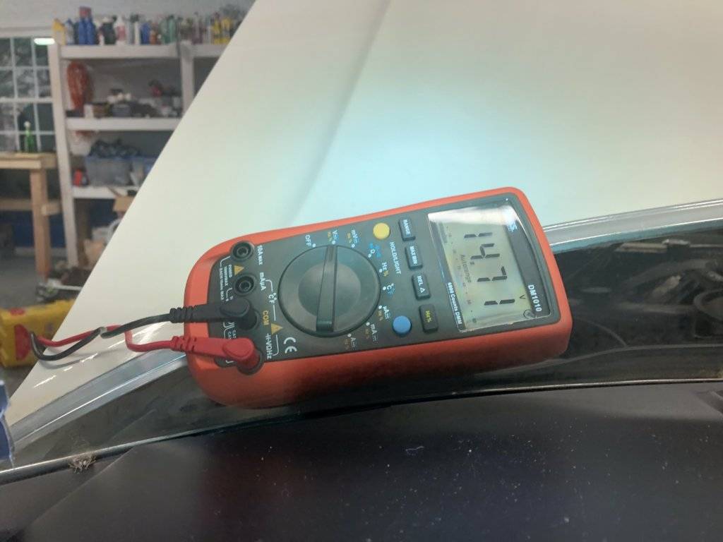

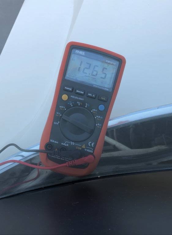

    Out for another nice drive today since it’s sunny, in the 50s, and I needed some bits for the house from Lowe’s. I spent a few minutes taking some measurements from the battery terminals with the multimeter while I ran some accessories and put some revs into it. Looks like there is indeed some things to be sorted there, but illl do some reading this week and then get back after it next weekend.

    Yea, if those readings were on the running car; you aren't charging properly.
    I pulled a handy FSM and you should be seeing (depending on temp @ 80 F) 13.9 to 14.6 Volts at the battery with engine operating at 1250 RPM and lights/ accessories off.

    That matches what I started to read. 12.6 was at the terminals with no accessories. 12.32 was with lights and blower going. This will be my first go with hands on electrical troubleshooting , so it should be a learning experience.

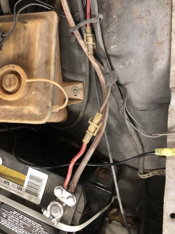

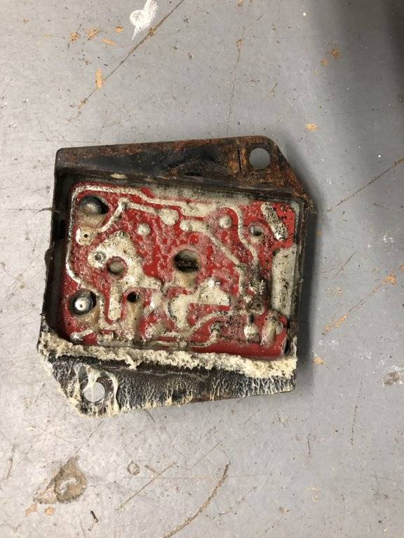

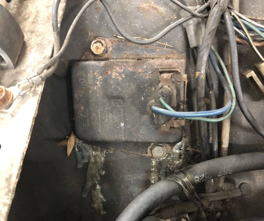

    Started by inspecting connections and boxes, found the voltage regulator leaking goo and a not great fusable link connector off the positive battery terminal. I don’t have anything to fix the fusable link so I swapped the voltage regulator. Seems in line with spec now, but bad weather is preventing an extended test drive. Good progress for today.

    Now you're cookin'... Good work! Don't worry too much about the fusible link connector...they are often brittle/ broken by now. You'll know if the connection there is bad, because the car won't start.
    I'd say you're fixed.

    Location:
    Atlanta, GA
    Yeah, I think I’m set. I either need to tape the connectors on that link or replace them, because the snaps are broken and it’s only being held by friction. Hopefully NAPA has whatever those connectors are called and I can swap them so I don’t have to deal with it later.
