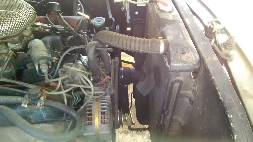

Background:
OAOMMXevVChLTYfBuVrQ_DBSD_cI56bjGyJ_n6pZXKpdMmG6BXTgDATSp4urCRiTh63WcCT0BX5_cKJ9jo=w1286-h723-no.jpg
I've driven Tilly for 2 previous summers in Tucson, AZ with fairly stable thermal behavior. Normal running temperature in peak heat and traffic conditions gets to ~ 210 F tops, and cools down to ~ 195 F as soon as I run in some open road for over a minute. This past winter I began noticing a slow increase in running temperature up to 220F, which has been mostly alleviated by thinning down from the ~60% antifreeze mixture for the winter to a summer mix at about 30%. Be this as it may, the old radiator, a 22 inch Mopar #2524984 made in 1965 with numerous patched leaks and much stop leak holding them, was overdue for

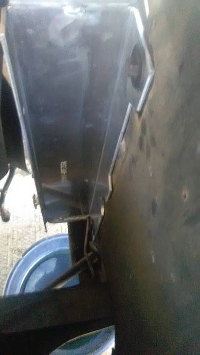

Center to center, the vertical distance between the attachment bolts is ~13.5 inches. Now look at the Cold Case radiator when I bolted and C-clamped the old and new radiator back to back to mark where to drill after measuring how much further down the notches for the lower bolts are on their radiator:
SMDp9qAee4szwfmodc_nE1hEgE7wIo4pZXejFcRVLPlW73JHVvDqR0XWFC0K9HaRJ7hgsb-WfdFfU3g9PPIbnMFPkfN-wfRcI-yyG4LcEbm_UB9oIDb6tGYJ_GX5NZzT8IYSrnZ6_l1JBLM7yQwIzD0q4wMPJsewaqXSTMiDKbJsgipRO0SD_1G3Kco1ZyFfGnnG7Du-tc42abKCbjYveHbIgX5F4d3KR1kau2NLDmPoql2GiQ-tVOBKFqsBSoZtmFgJglUVgCufnAHqePaJafHcbCWIHW0ku4tl0amIntp3q57Hy4T-SN0XEsp0fHUHrnL5iHGiOjgbdOLEl3vphG6HxBwwhV7U-7TNX7tnkkeBZ02LXEHqJ2uL0ywuAfK5g247HMoHu6xAn2Br9mA4BgITTSVOCBnm6s9hkLvNzc4Vlfsfqh-j4hLn3rXEm8zz7iIUWn_9Tf70DohcKZ4QYc4KoDlcJCTmNSEm3YQTJlyy2lbMH6nX6eDXwmzyUdbIYdsR7jOcefxBe6iVMNHVqc08iEgDBeBB2AKyYb0-iNn7pvG7PimfIh4sjTq7JB5K-A9sFvdUmf2Nn-611EmWAIc1bIGp0JhreT8KYG0=w407-h723-no
bsKytLv6PbxKw7TILti73iqHelts3kgiyOSLqGfMn7_DuRlIImZNKtucKfUXYSwKU8g8_WglPNMYBQzoAEf7AsEkgwxOqiEgeHmzysTOgbW0jI91YuqXoE36zU3W3xiR2E_mQR1tv2BR04P0oXaADQzk3qq7q5MN0pfsxEgwAWNBddm6P_T2x61wizBRYGvDhdw8Ng0bIOvTOUmi6I0EpK3oihNh-OqLPgmrXhGhuU15G9uXYZQb7Vm7Q0zV6TuzqRJkirfZrK6lr68AL06ECSqiojQxwggO7yh3ttfBPo_z-iokmlNqQc-J4XAMuYJ_ogl5yUOsAKhPhEpYL0EjPiuzDzuiwHSj8X55tzL01dQhFgCjz0FtBxjqFYDvUG41iDeshqBq6PlCZ5NnswzzAdWqKyfFukw2m8ARfzjWSOG4WTarQ-XQb_DI2XQAG4ug8aZgKGJ69ENswXsJgP3nGaWgDhl_qq3xre5RkcAw-dOF25wXhSH8_JmmcwyRqamnBn6FlO1G8SxG3kXwEWyvDs_7wfeiuhElfUUcba2IJsp0hOM-sJwdmBDV2I3dlFN_zK6I5F9o-B6Pt0wTyH4vNk59KdOVAJe7FMki01c=w407-h723-no
You can see clearly how I traced in with a Sharpie the old radiator's notch onto the new one's flange. Part of the new notch at the bottom of the Cold Case flange can be seen here too. This and the preceding pic show how exactly I bolted and clamped the flanges together before drilling a 9/32" hole top dead center of my notch marks on both sides. Only with this alteration could I then bolt the Cold Case radiator in, hook everything up and take it for a test run.

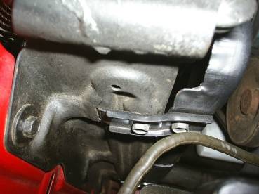

3. I LOVE the flanges for modern shrouds on the engine side of your radiator, but study how the old Mopar shrouds attached more closely and see if you can run a row of bolt holes down the sides of your radiators which will allow the old shrouds to bolt on directly. I now have to get creative with my shroud, though not until I get it painted. I have a NICE old STEEL shroud from a ~65 Imperial which has brackets just a little different from what a Newport needs. I'll doubtless make something with angle metal do the job....

My pleasure to be of service! I now need to contrive a good method for attaching the shroud I obtained last summer. Your shroud flange actually gets in the way of the old style brackets, BUT I think I see how I can easily attach the shroud to the flange if I eliminate the brackets, using a flat piece of suitably drilled metal on each side, then attaching to the flange at the corners. I will revisit this thread when I get this together.

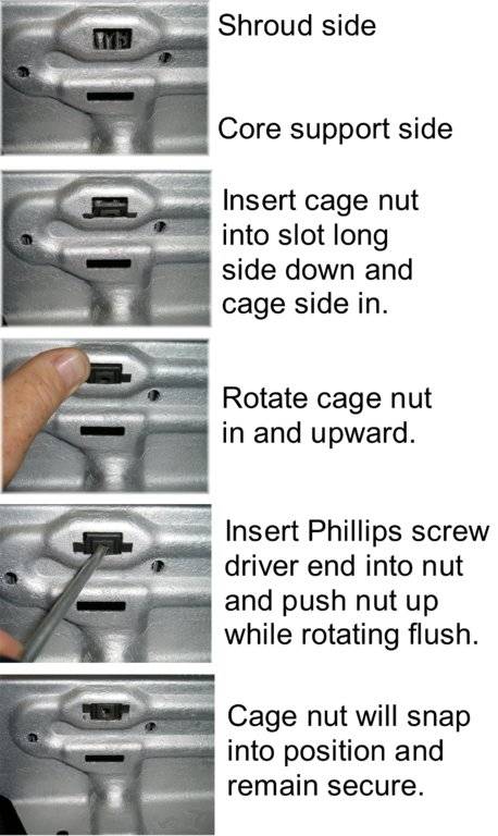

Cold Case, if you can cut those original styled slots in the sides to hold the cage nuts, and get the height increase,I will order my radiator.
It shouldn't be hard.

View attachment 184754 View attachment 184755
Unfortunately, this would be outside of our comfort zone. Adding stamped slotted side caps would be cost prohibitive for us and then for you as the consumer. We are primarily a performance radiator company. Although we like to make our radiators have that original look and we want owners to be able to re-use their original shrouds when possible, our feeling is that if most owners want to keep that level of originality, they will also want to keep the correct stamped tanks, the correct stamped part numbers and probably the correct copper/brass tanks.
Our solution is to provide a great resto-mod solution. High performance, OEM looks at first glance and an easy way to re-use the OEM shroud. To accomplish that with this 22" unit, we'll have to put small brackets on the shroud side of the radiator so the shroud can be mounted in an alternative method.
