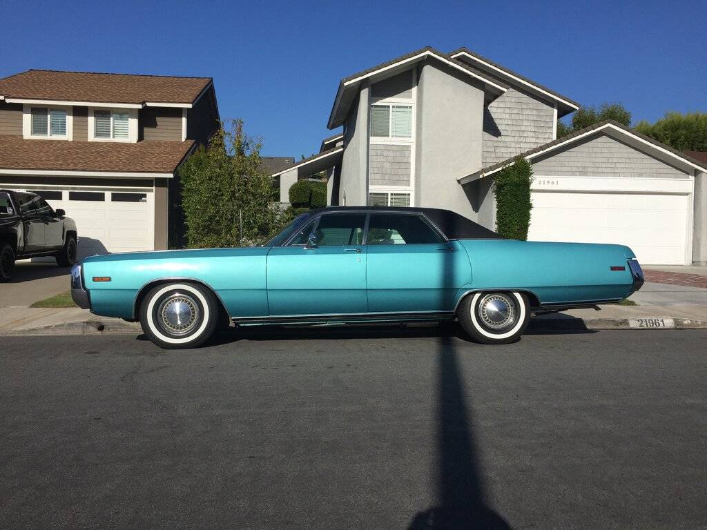

Hey guys, I have a 1970 newport 4door hardtop 383 engine with 727 trans, and 8 3/4 rear end. I'm trying to freshen it up mechanically so I can daily it. The engine runs great and trans is in good working order. Before I go through the headache of buying the wrong parts, I want to replace the the following and need help sourcing the correct replacement parts.
I'm looking for:
new gas tank and sending unit
fuel pump and fuel filter rubber fuel lines? or braided?
power steering pump
brake hoses for factory front disc brakes
brake hoses for rear factory drums and wheel cylinders
voltage regulator
belts hoses
other than this thinking of keeping it stock, not in a hurry to ditch my points distributor for electronic, all works well at the moment, just want to fix the items above and give her a solid tune up and roll!
