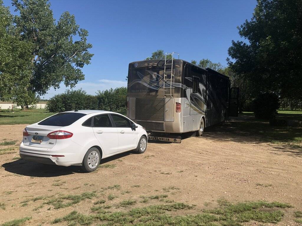

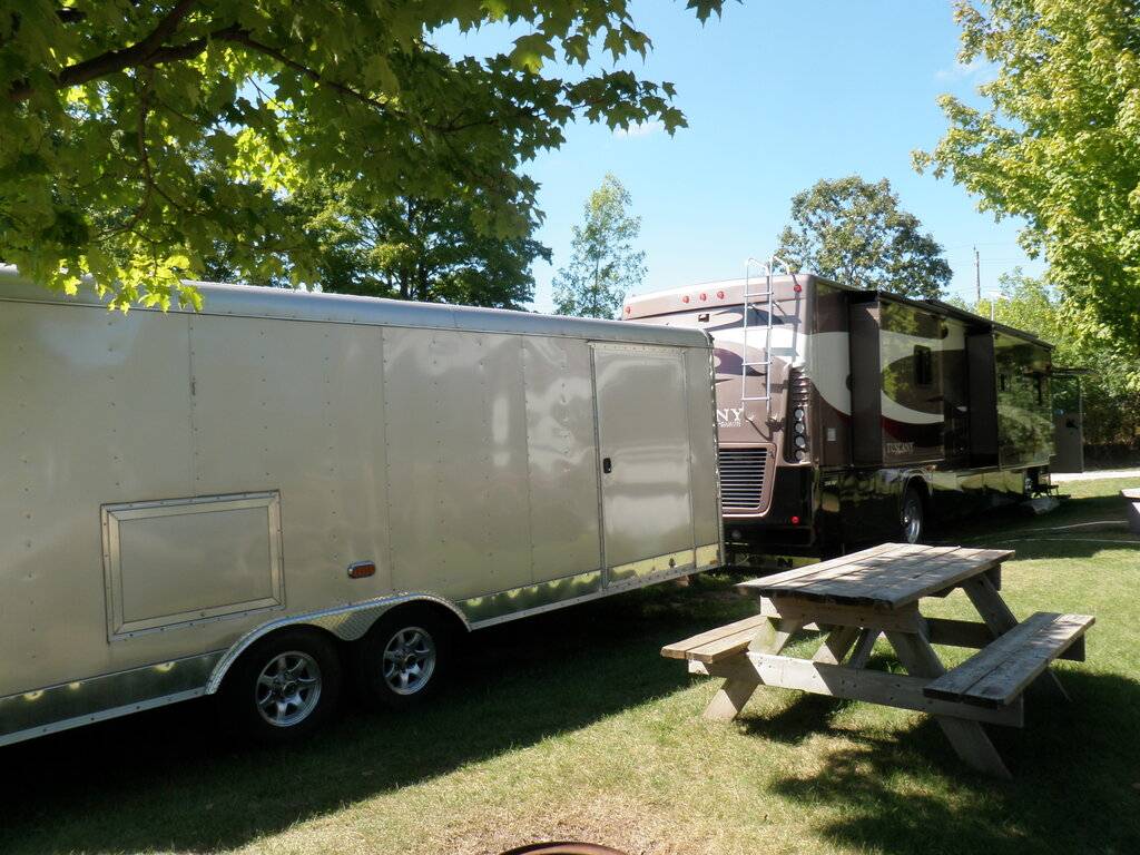

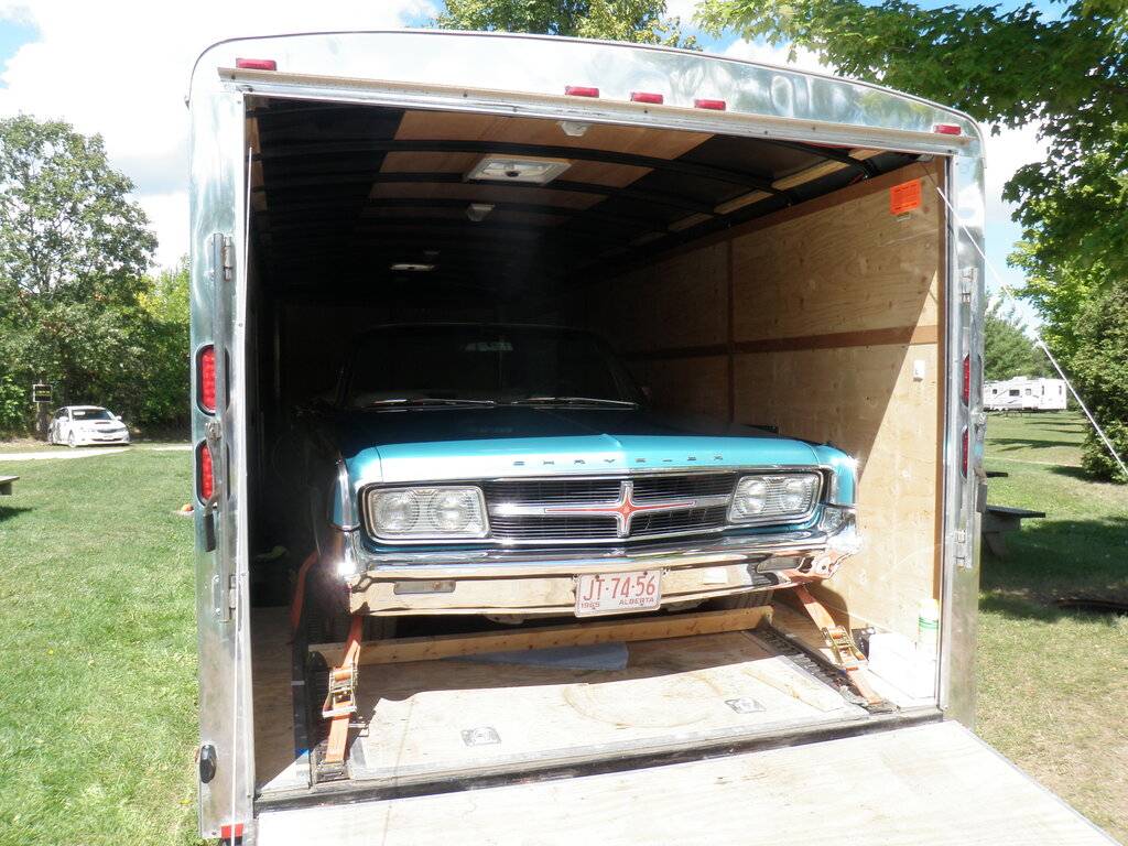

I am thinking of getting an enclosed trailer that I can use to take my 65 Mustang to the track and for other vehicles, or pull Farty, a 2015 Ford Fiesta, that’s already towable.
A C body is way to large and heavy to flat tow safely. Don't even think about it!!! A trailer, either open or enclosed is your safest bet.

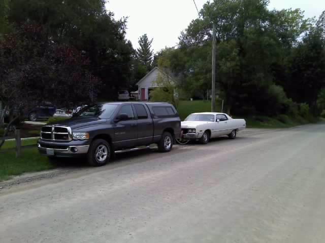

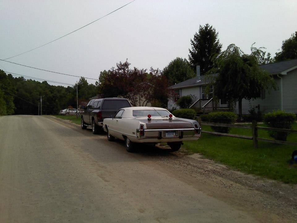

Had no problems flat towing mine south years ago (car wise). As mentioned, disconnect the driveshaft, unlock the steering wheel, and unhook the battery. I removed the grill as to not mark it up with the tow bar. Borrowed an old tow bar from a buddy.
One piece of advise, don’t go cheap on magnetic brake lights. Used some harbor freight specials, magnets not very strong, and moved around the trunk. One ended up flying off at one point.
We ventured at night so not much traffic to contend with. Had no issues doing 75 down the freeway. Car actually did great.
Truck on the other hand was not as happy. Had a clogged up radiator so was overheating. Made it to GA from MI. Had to unhook and drive the car rest of way to FL. If the radiator hadn’t of clogged up truck would have been fine….
