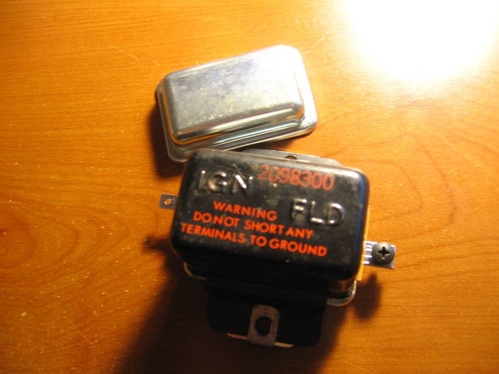

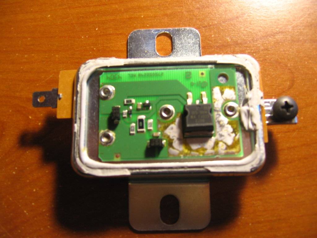

If the problem is due to a marginal VR, you should check with @FURYGT . He sells a really good and stable electronic VR that is not expensive. I run one in my '66 convertible.
Nine times out of ten it is the points inside the mechanical regulator hunting, an electronic one will cure most of it, I have also seen a bad ammeter gauge contribute to this problem, (I have to replace the one in my 66 300). good luck.

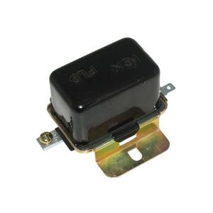

From Autozone get a VR706 regulator. Fully electronic and can handle the 60 amps.
Your old mechanical regulator cannot handle the 60 amps.

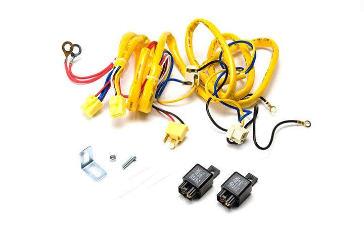

Headlight harness with relays.
Heavy Duty Wire Harness & Relay
For our C's I use part #230004HW
Plug n play and really works taking a load off the headlight switch and foot dimmer switch.
