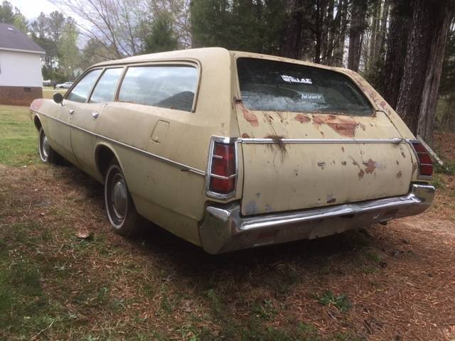

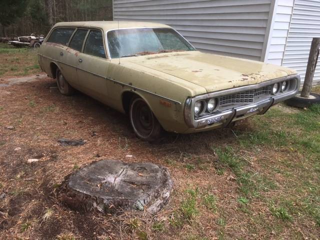

The floor pans I ordered from Year One came in today. They are for the 72 Dodge Coronet wagon I bought a year & a half ago. Been slowly collecting parts. Plan to remove the seats for a better inspection of the rest of the floor. Then take it down to Woffen's shop & he is going to install the pans, clean & treat the frame sections under the floor, and install weld in sub frame connectors. I've been down to Wollfen's shop twice & seen his work & was impressed. The car is for sale also.
What's your overall plan for the Grocery Getter?
440/727 mild build. May try the new Toth heads or the E-Street heads. Or Stealth. 480/230 cam, gear drive, 8.75 or 9 inch. Buckets, ratchet shifter, manual/auto valve body. 3.55 sure grip. I've already got a lot of these parts. Also I think it's the perfect canvas for some paint tricks I want to try. I'll play with it untill someone comes along with a pocket full of Benjamin's. It will be great for the Nostalgia shows & races

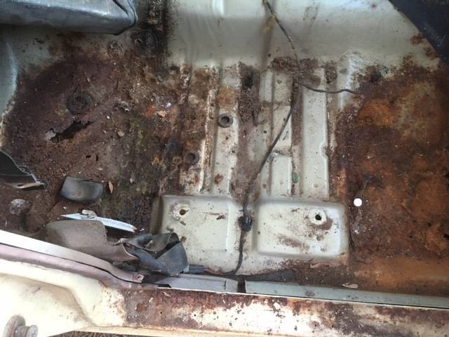

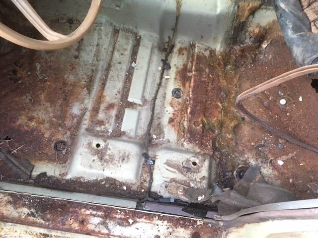

Got the front bench seat out & the floor under the seat looks good. Next I need to pull the back seat out & see how she looks under there. Also wanted to pull the gas tank. Anyone pulled a tank out of a 72 ish Wagon. How hard is it

Pulling a tank out of a 70's wagon is not easy.
Basically you have to drop the left rear leaf spring,shock,and hang the axle out of the way.
Front pans will fit,but anything further back will have to be fab to fit. Wagons have a different wheelbase compared to sedans and 2 doors.IIRC.
