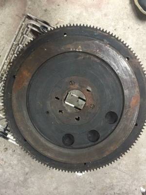

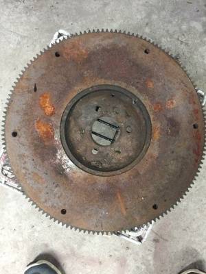

    Speaking with a guy about buying a flywheel from him and really would like to know if it will work for my application. There are no numbers on the flywheel. It is the larger (140 tooth, I
    guess that's the correct number) flywheel I have attached pics which he sent me. He said it came off of a 440 but did not know what year or whether or not it had a forged or cast crankshaft. Can anyone Identify it?

    By the large balancing holes on the back I'm going to venture non forged engine.

  4. max1196
    max1196 Member
    Messages:
    125
    Likes Received:
    33
    Joined:
    Sep 21, 2016
    Location:
    Swift Current Saskatchewan
    130 tooth or 143 tooth. Start counting. Besides, sure looks like a 360 from here.

    No manual trans cast crank big blocks so that flywheel with the holes in it is from a cast crank small block probably a 360 truck if it is the big one.

  10. max1196
    max1196 Member
    Messages:
    125
    Likes Received:
    33
    Joined:
    Sep 21, 2016
    Location:
    Can you get the guy to measure the diameter of the 3 holes on the back side? Page 224 Direct Connection book 383-400 and 440 CAST crank 12.9 in.-oz. spaced 2.5o inch apart to a diameter of 31/32 at a depth of .660 inch . 360 is 1-13/64 diameter holes at .660 deep equaling 19.79 in.-oz. Anyway this is cast crank stuff (external balance) stuff in the picture.

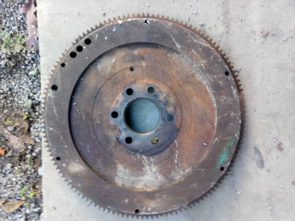

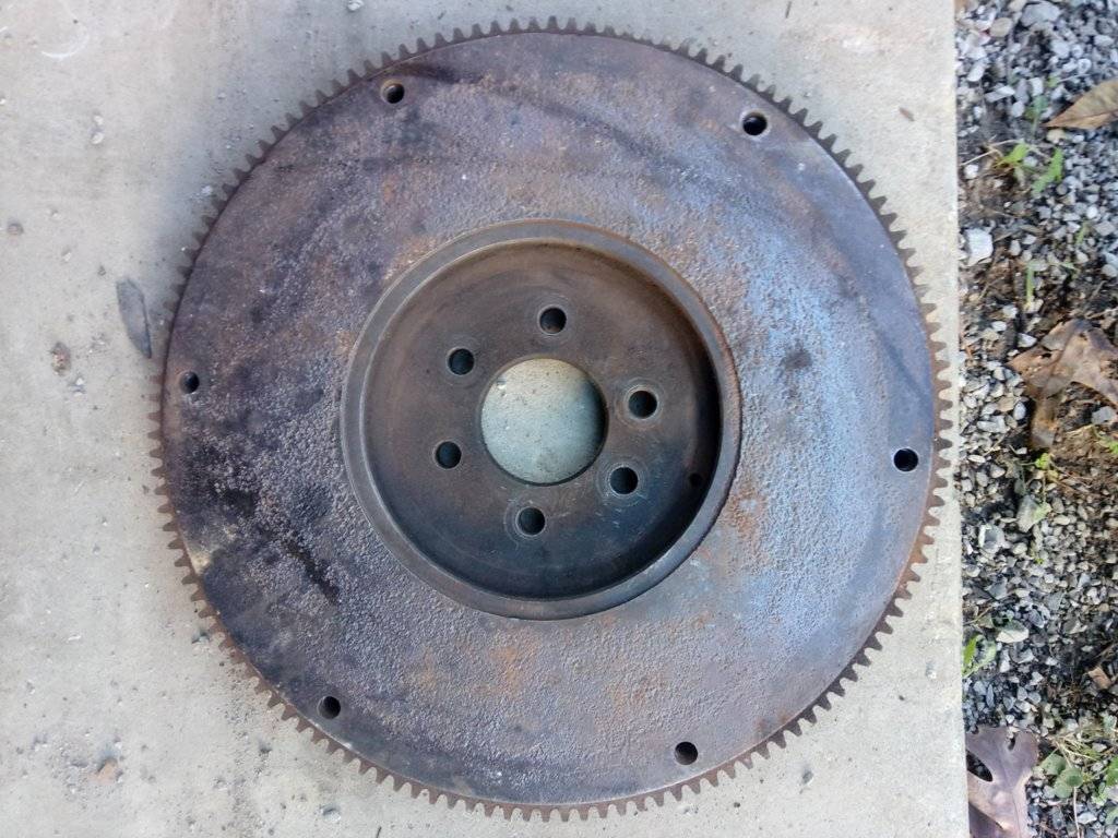

    Andy, didnt you say you have a good 130 tooth setup already?
  13. Andy Blaisdell
    Andy Blaisdell Member
    Messages:
    138
    Likes Received:
    20
    Joined:
    Aug 4, 2017
    Location:
    Marion, KY
    Yes, I have a 130 tooth flywheel but not sure what engine it works with. (Pics attached) It came in a parts car (65 Fury III) with a junk 440 just sitting in it bolted to the back of the engine but the installation of the 4 speed stuff on the 440 in the car was never completed. I also have the bellhousing which came with the car as well, part number 2468370. All of the 4 speed stuff came with the car but was never installed completely. This flywheel had an 11" clutch disc on it under the pressure plate. 1018171627_resized.jpg 1018171627a_resized.jpg
  14. Polara_500
    Polara_500 Senior Member FCBO Gold Member
    Messages:
    3,076
    Likes Received:
    1397
    Joined:
    Apr 17, 2011
    Location:
    MinnieSnowta
    That looks like a neutral balance wheel which would be correct, but I don't think it can be saved by looking at the pic of the surface, you'd have to cut it pretty deep.
