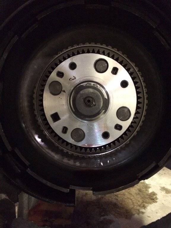

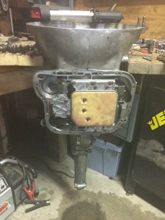

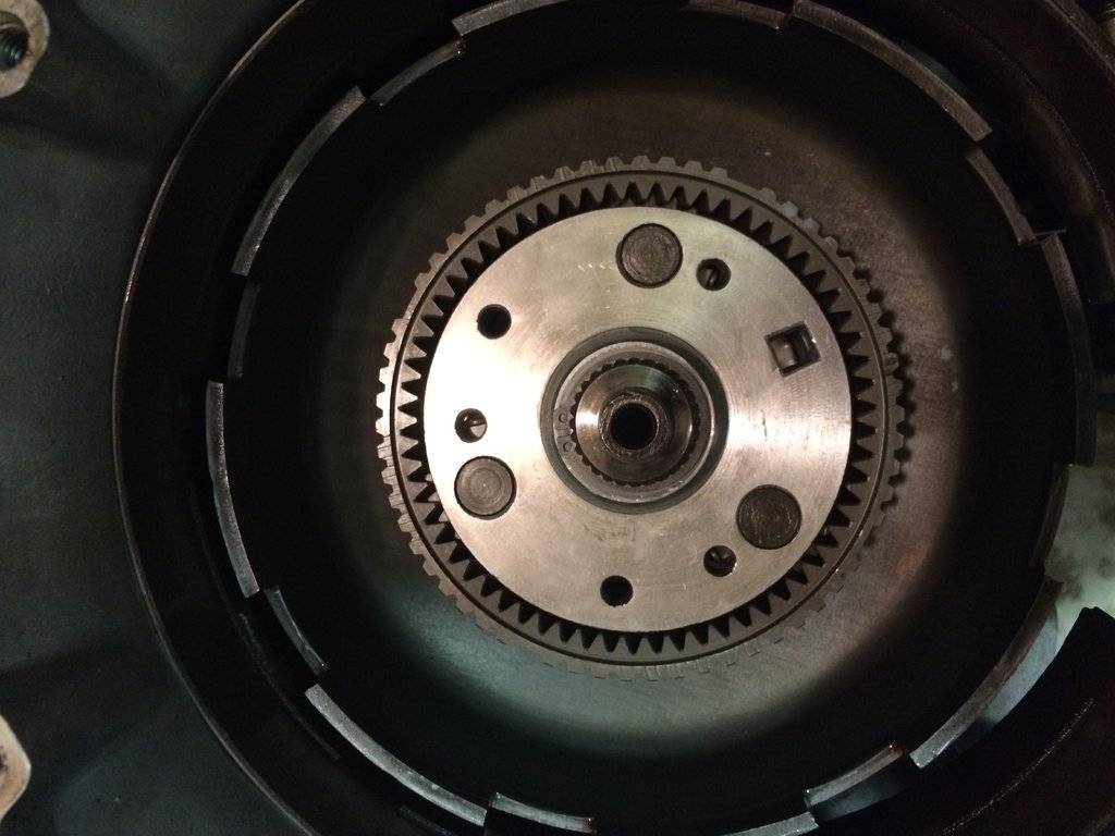

    Didn't end up doing a rebuild. The clutches and disks looked to be in good shape per my transmission buddy. So for now I've got a front transmission reassembly under my belt. The question is did I screw up?lol we will find out soon. I did swap the 2.9 kick lever for a 3.8. Hopefully I can feel a bit of a difference. These tfs aren't as intimidating as I once thought. Now let's shove it back in the fury.
