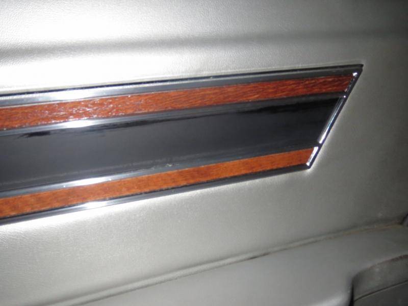

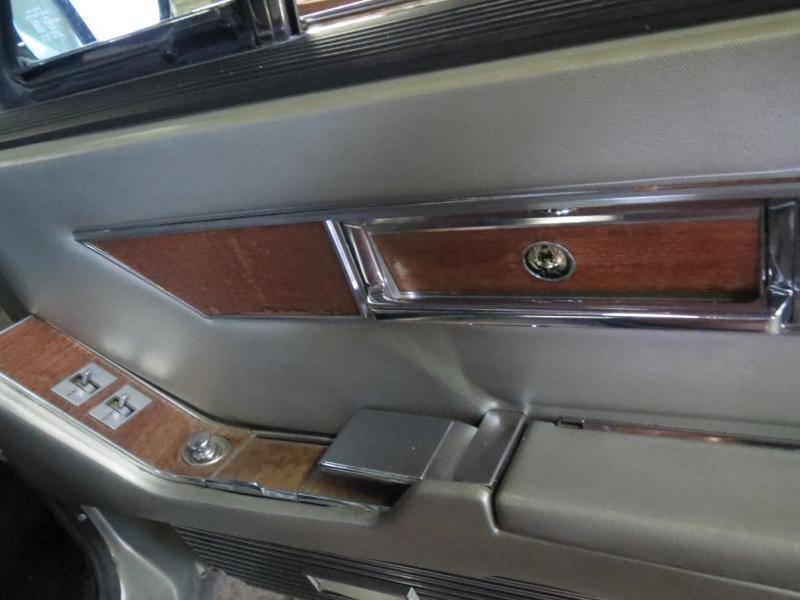

I'd been wanting to try this for some time and I finally took the time yesterday while I was installing my newly modernized old radio. I had the rear seat out so I could run the speaker wire and get at the package tray but before I put it back I figured I'd do some cleaning and that's when I decided to try it.

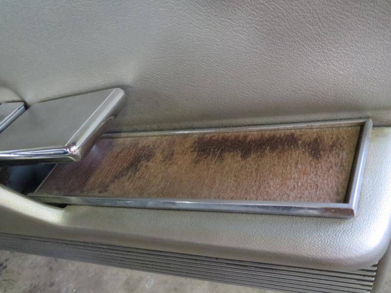

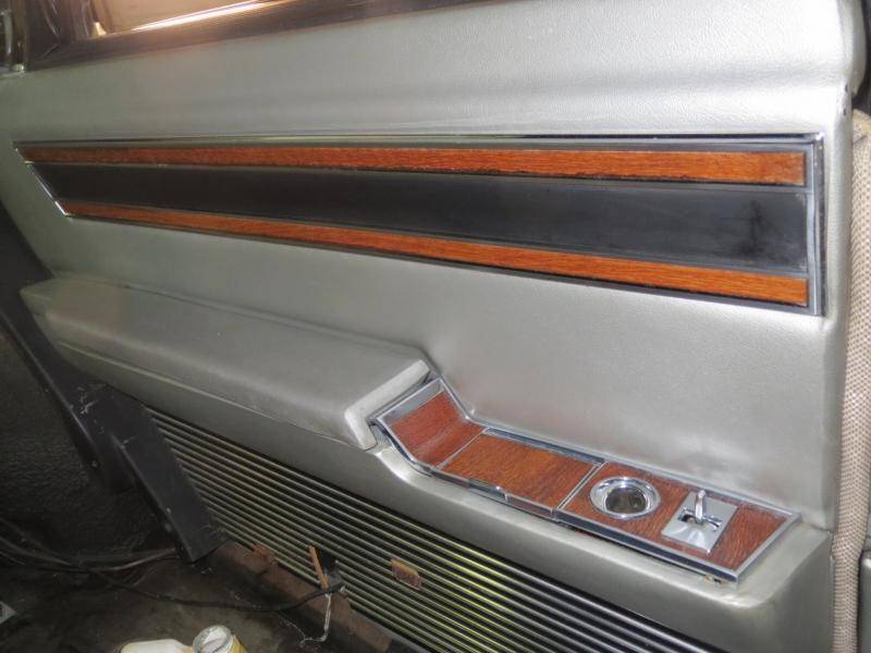

I like to use tung oil or other natural oils on some of my furniture projects. It's pure and all natural, you can even rub it in with your bare hands and its good for them. I figured it would be a good thing to rejuvenate the dried up and faded veneer in my Imperial but I didn't think it would work as well as it did! Here are some before pics.
Anybody with a boat could have told you that. LOL. J/K. Looks great.

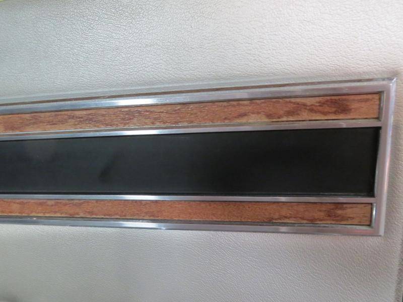

My friend Lance "The Destroyer" taught me a trick on the FAKE veneer.
Minwax Polyshade.

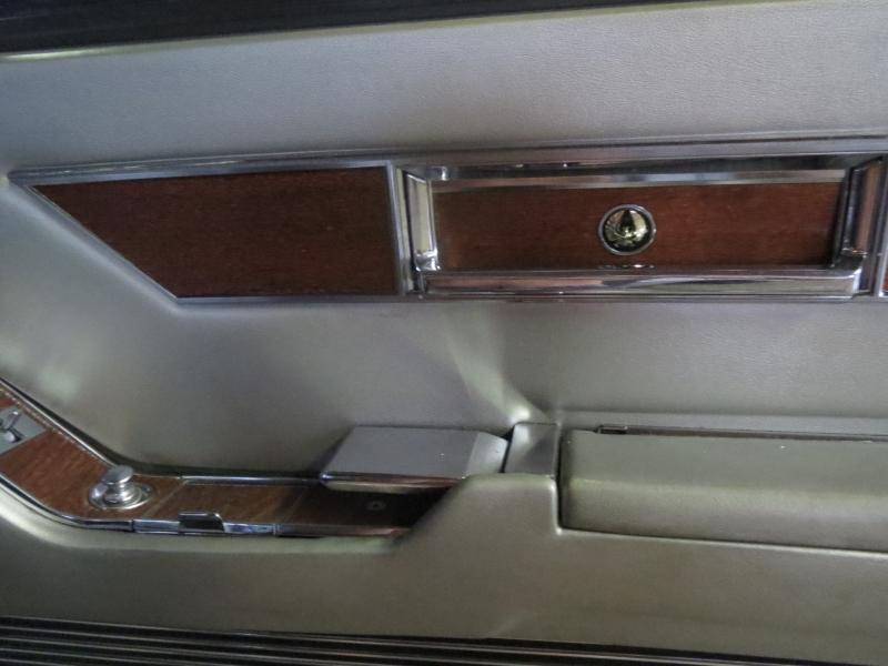

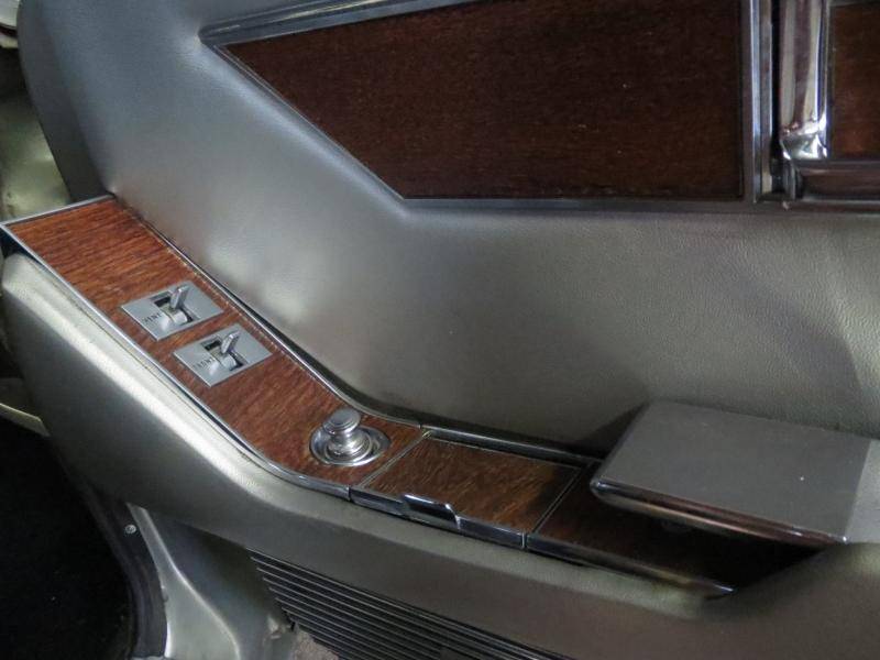

And here are some after pics. I'll post more after I finish the rest but it literally only took more about 45 minutes to do everything but the dash. Go to a good local hardware or home center and get a small container of 100% tung oil. Online at Amazon would be a good choice too. Just give it a quick cleaning with a damp rag and let it dry for a little while before putting the oil on. I used a small cotton rag, wrapped it around my finger and dipped it in the oil and rubbed it into the wood. The transformation is instant and the wood looks almost like new again. I had a clean rag handy to wipe off the excess after I was finished wiping it on. I don't even think you need to mask anything I was just careful not to get it on the vinyl door panels but wasn't worried at all about getting it on the surrounding chrome or painted trim as it wipes right off.
