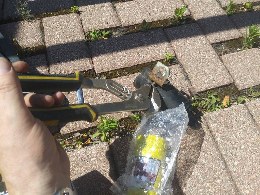

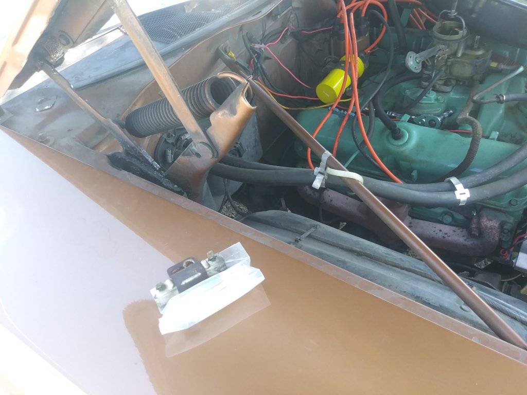

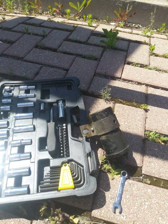

After I put the phone down, I decided to change out the coil and ballast resistor.
Both looked very old and with the loose wire there is a possibility the coil was shorting out based on the nasty backfiring.

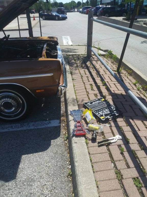

So when ya think ya had everything...
My tool kit does not have a flathead screwdriver bit!!
Dammit!
Whats a poor stranded Hoser to do??
Channelocks will do just fine...
Don't care at this point if I wreck the threads on the coil bracket screw. It in the middle anyways..
Coil installed and pulled ballast resistor out from its residential glove box living quarters.
