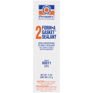

I like Big_Johns Permatex #1 suggestion, but I have used a lot of #2
Either one would work well.
