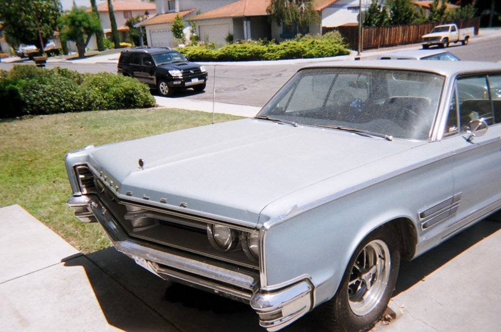

    Here is a 15x6 wheel with a 225/75R15. Looks great.
    A 7” wide wheel is too wide for a 75 series tire, plus they are bit heavier.

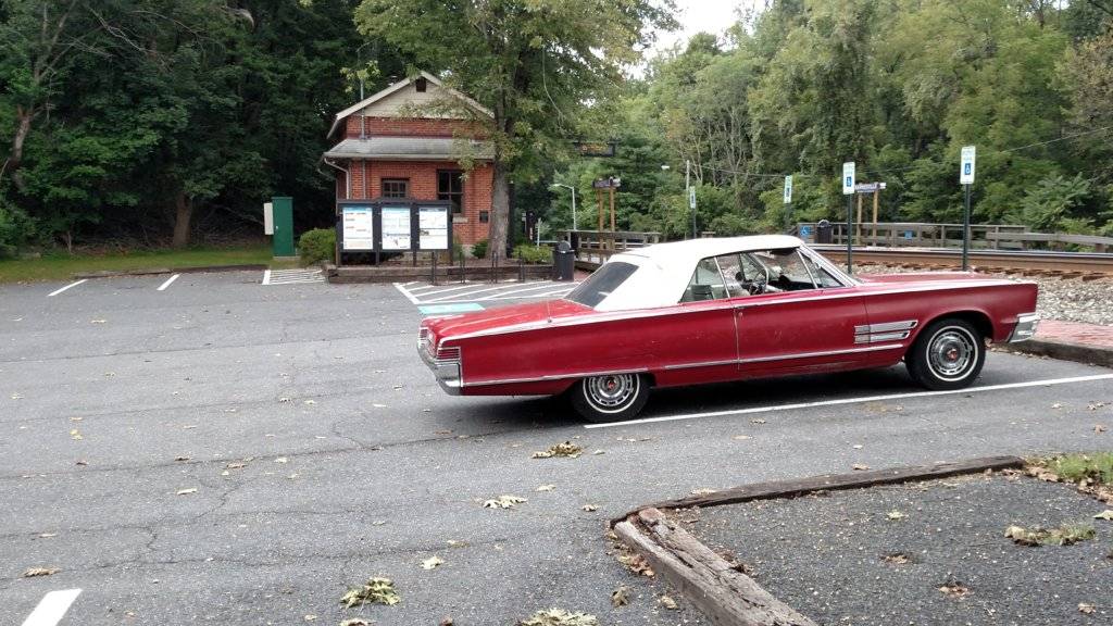

    Fred:
    Here are a couple of pictures I took of my car after installing the 15 X 7 wheels and 235/75-15 tires:

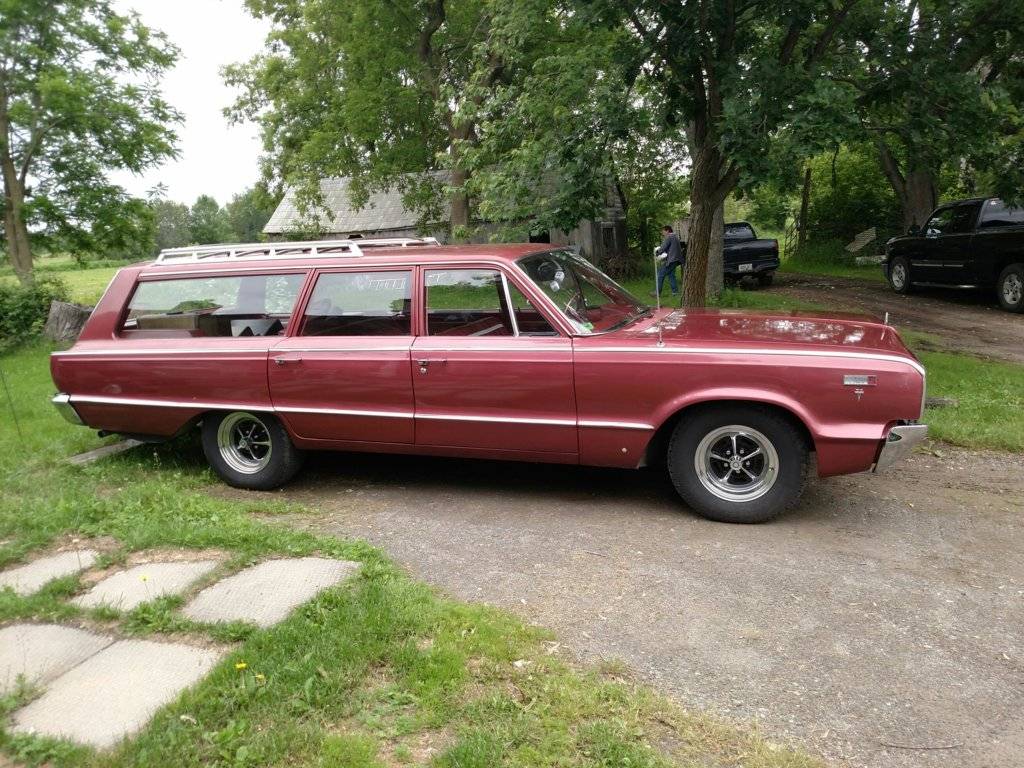

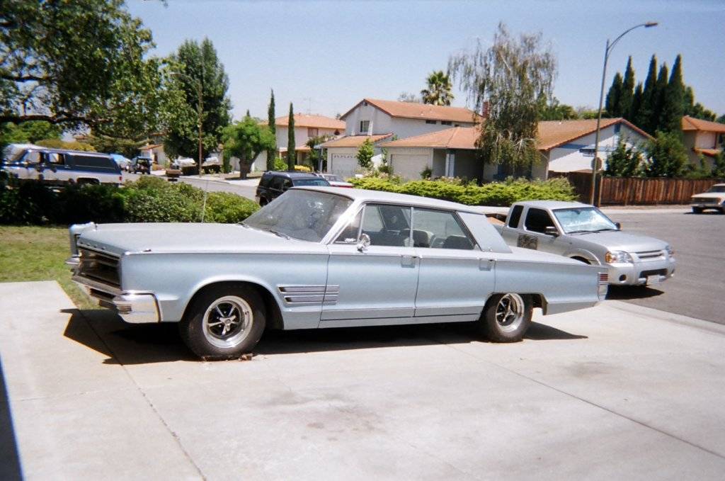

    from 14x6 to 15x8 with 275/60's , skits needed some mods t lock in place . 05170010.jpg 05170012.jpg 05170013.jpg 05170014.jpg

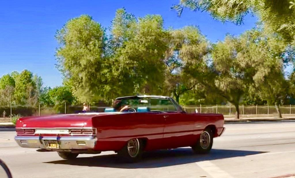

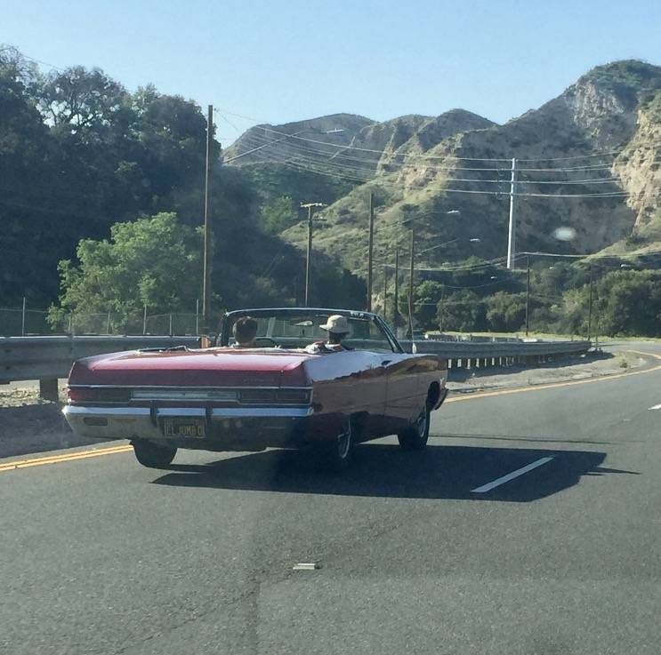

    I run 235 70 15 on my factory 15x6 inch wheels. And I do mean RUN, it’s all canyon up here but I’m not an idiot so they do just fine. Sorry I’ll never be a white wall guy. Maybe on an Imperial someday if I get lucky but not on my other stuff.
    My dad did me and my brother a huge favor one time and took our 1970 383 pistol grip 4 speed air grabber Roadrunner to work when his car wouldn’t start. He came home late and said go check out your ride I put new tires on it for you!!!! We ran outside and there it sat on 4 white wall tires.
    Thanks Dad !!!
    We painted them black by the end of the week...
    You can see from the road pics that the car rides well & tires clear but also FILL UP the wheel wells. I think taller is more important than wider for the correct look.

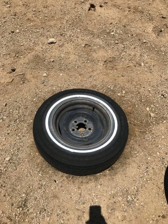

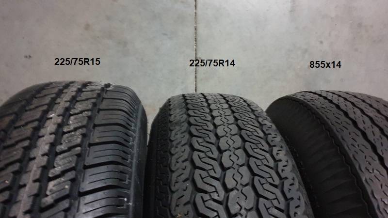

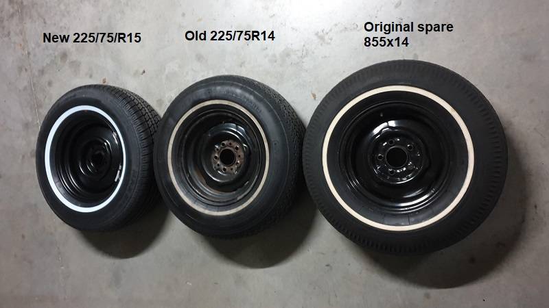

    I finally went with 15x6, 225/75R15. I haven't done a picture of the full car with the new tires and hubcaps, but that will come soon.

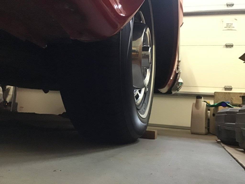

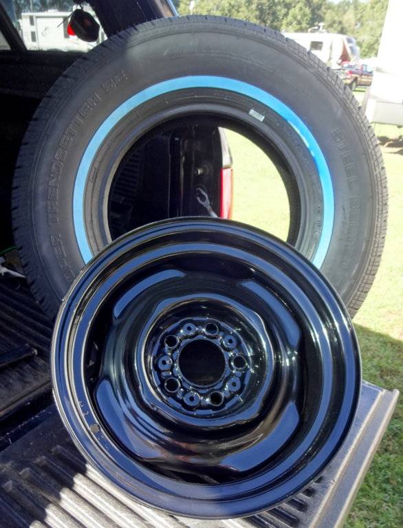

    In the meantime, I've made a couple pictures showing the three sizes (original, 14" radial, 15" radial) and the height difference. As mentioned by cbody67, the 225/75R14 was the exact replacement for the original 855x14. Next to each other, they have the same height. The 15" is obviously 1 inch taller. On the car, with the disc brake hubcaps, it looks good.
    The first picture, from left to right: the new 15" (Maxxis, only tire I could find here with the narrow whitewall), the outdated 14" (DOT code ends with 3 digits, therefore it was a pre-2000 tire, so most probably 1995: 25 years), and the original spare, that I am keeping in the garage.
    The second picture: tires aligned on one edge, to see the height diffrence. 225/75R14 are exact match for 855x14. Too bad they don't exist anymore.
    And... the bonus picture : I know now that the 4 tires I had cost 49.95$ each with mounting and balancing, as the receipt was in the rear right tire.... That was an unexpected finding! I'm keeping that as well. It survived thousands of miles over 25 years, no way I can trash it. On its back, hand written, one can read 225...14.
