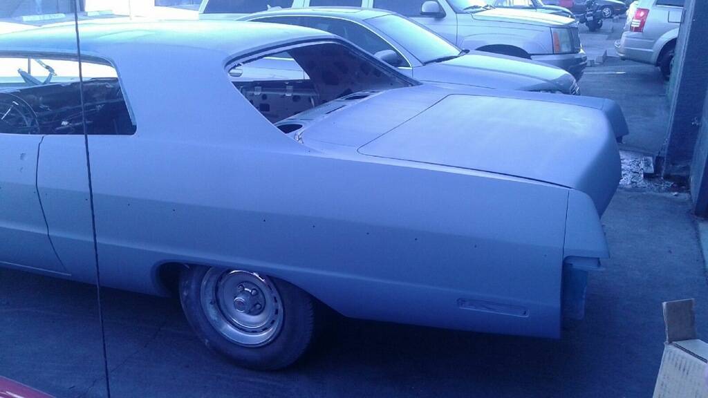

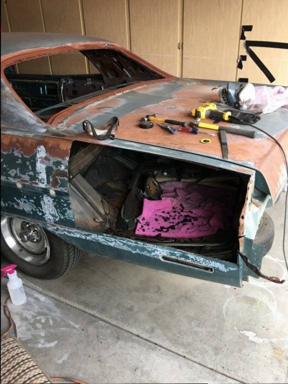

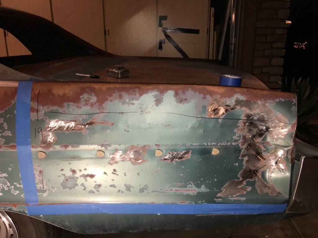

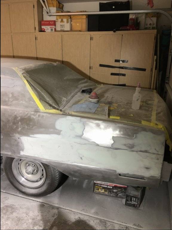

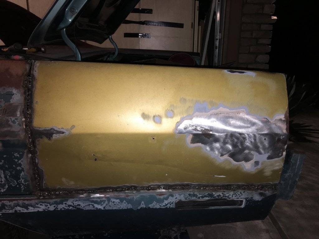

Getting close to paint....
middle:
after:

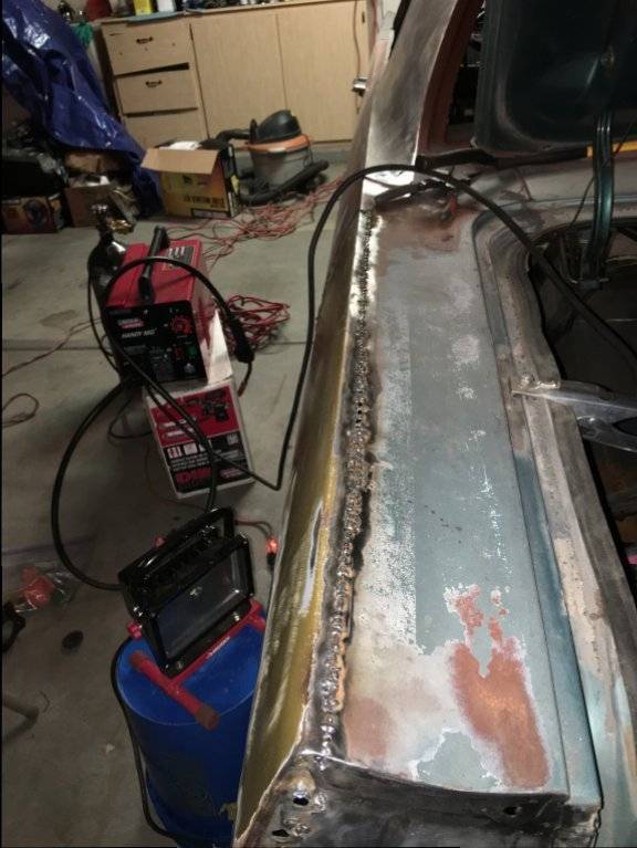

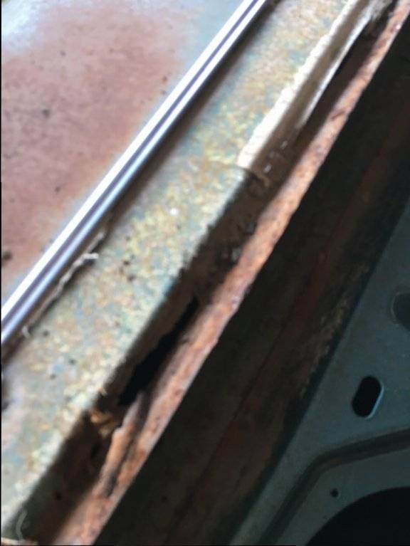

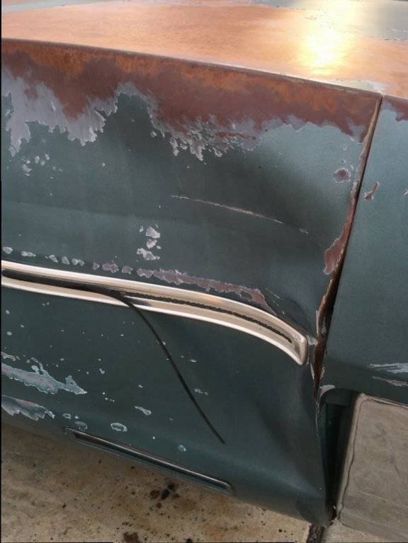

I had to weld in new pieces for about half of the lower channel, including both corners. The upper and sides were fine. Just have to take your time making templates with cardboard. I found using a dremel to help with more precise cuts on the pieces.Did you have to fabricate a new rear window channel for the lower part of it? If so who did you have build it for you? These cars always seem to be rusted there.
Yes it was. Looking forward to seeing it back in it's former glory with white vinyl top.Was your Fury FP6(?) Frosted Teal Metallic originally?
