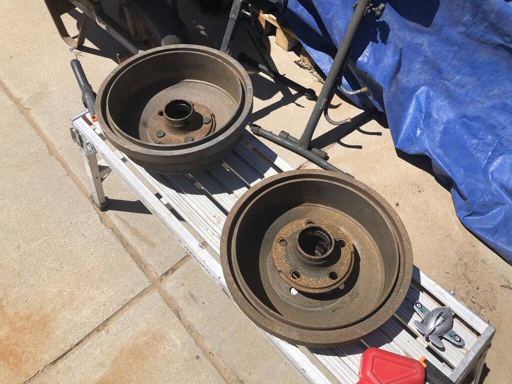

Hey all!! I’m looking to purchase new 11x3 front brake drums for my 68 New Yorker. Anyone know where I can buy them?

Thanks Craig! It looks like a few people have said my drums look good enough to be turned and used yet again. I'll roll with them, but definitely contact you if anything else happens!

Looking at the pictures of those drums, they DO look pretty thin.....
Remember , 11.000 " is NEW, 11.090" is Discard .....
