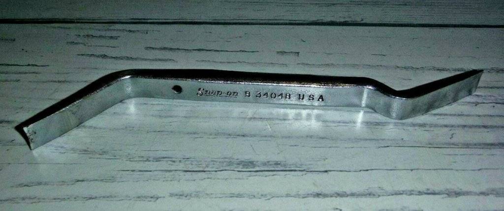

You may need to use a screw driver to push the self adjuster away and hold it there while loosening the adjuster. A little tricky but doable. Also some have the access holes on the brake drum.On the back side of the backing plate at the bottom you should find two rectangular rubber plugs. Remove them and with a brake tool loosen the adjuster ("star wheel") then remove the drum in the normal fashion.
