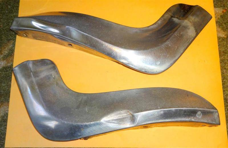

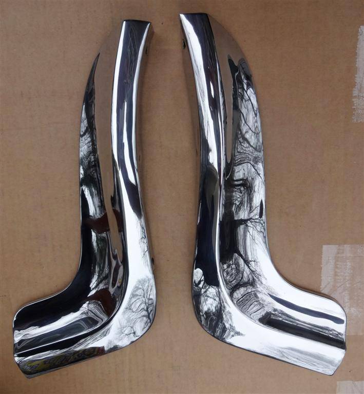

I've got a source here in Birmingham Al for stainless & aluminum restoration if anyone is interested also. He's been doing it for almost 40 years.
Here are before and after pictures of a pair of 1960 chrysler stone shields he recently did for me .... cost .... $75.00 each. They were junk to start with, now worth $3-400.00
