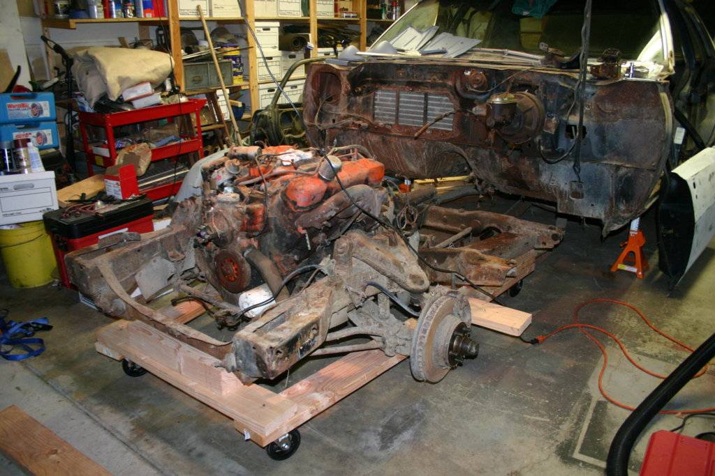

Yes. First remove or disconnect wiring from motor to the uni-body part of the car. Remove steering column from steering box. Disconnect brake lines from brake master cylinder, as well as rear brake line from proportioning valve. Disconnect speedo cable from trans. If a/c car discharge system and disconnect. My understanding is you want to roll out the frame with trans and motor on it. You do not need to remove trans cross member. All you need to do is un bolt the frame from the uni body and roll it out.
When you roll it out, it'll look something like this...except the engine/ trans will still be on it.

BEFORE you do anything, you'd probably need to design a "holding fixture" for that assembled "stuff". Something "on wheels" as pictured. Having a body contact lift would be an asset! But it can be done without one, IF you have enough muscle from assistants, in a coordinated effort.
At the assembly plant, on unibody cars (of any year or make), the front "frames" went up from the bottom as one assembled unit. So think of that as you decide how to make things work. Then "reverse" the procedure to remove the item from the vehicle. Doing things in the "unit assembly" orientation is much better than "by the piece", whether stub frames or instrument panels.
Also take note of the style of bolt that holds things to the body. Keep them all labeled so they can go back into the same holes, for good measure. Plus the mountings insulators, too. Might want to get a large piece of cardboard with a graphic of the stubframe and its mount locations?
Work safely!

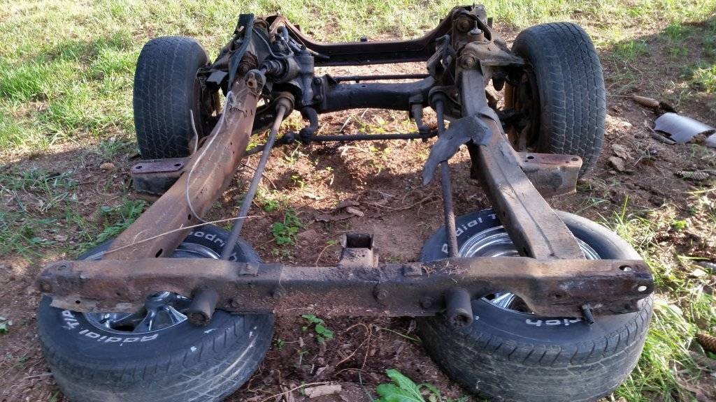

There will usually be some steel shims between the body mount and the stub, note the position of those shims as they will need to go back in the same spot once the stub has been cleaned up. (You can see one on MrC's post above.)
