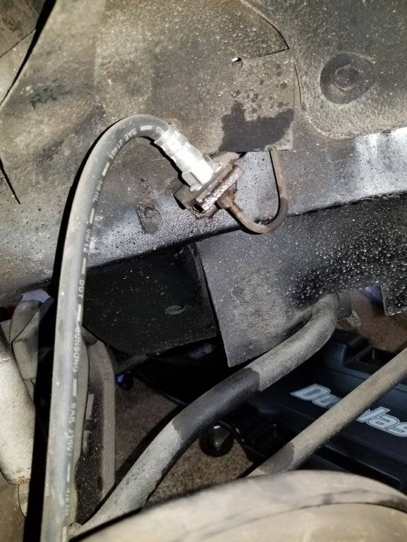

    I'm swapping to discs on my 66 Monaco. I've attached a pictur showing the line from the master connecting to the line attached to the drum. I have no clue how to undo it. How do I?

    Just loosen the smaller fitting and remove. The larger hose fitting will be held in place by the bracket but a wrench on it is good insurance. Apply plenty of penetrant to the steel line and fitting and use line wrenches not regular open end type.

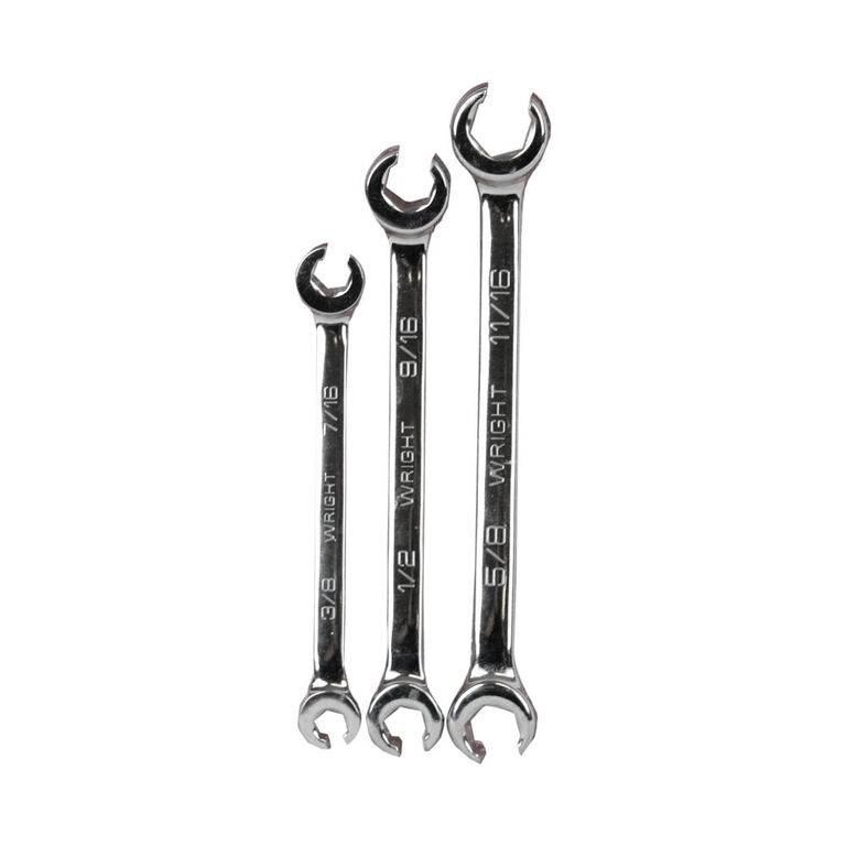

    This is the type of wench you want. Sometimes these are also called flare nut wrenches.
    • Agree Agree x 4

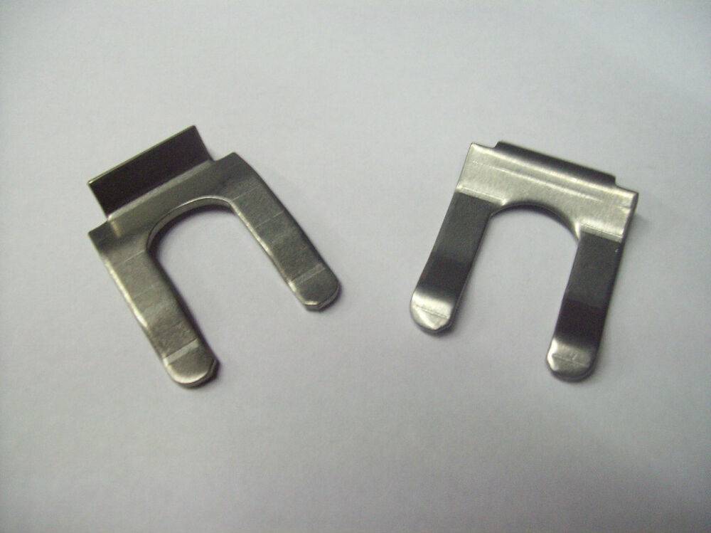

    There's also a clip that holds the hose to the tab. Looks like this:
    • Agree Agree x 2
    • Like Like x 1
