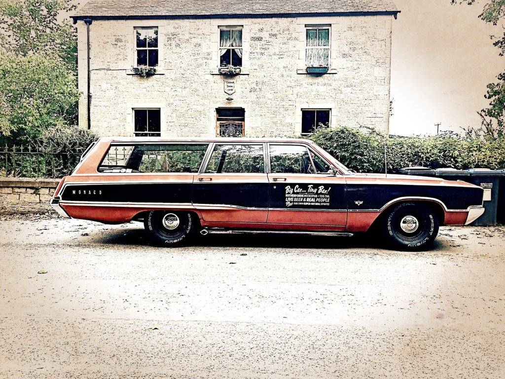

    Hi there... me again in Scotland.

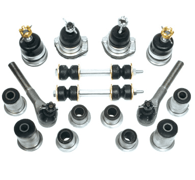

    I’m struggling to find lower ball joints for my ‘67 Monaco Wagon 383 2BBL
    Kanter Auto has the whole kit for $852 plus shipping to UK & is exchange only.
    I have been quoted £1,192 for the kit here in the UK!!!
    Upper ball joints easily available.
    Joints seem fine, but rubber boots perished so no grease holding or dust/weatherproofing. Someone advised elsewhere on the forum that 99 Dakota boots are the same but not what model & if it was successful.
    *** > Mine has the factory 4 pot Budd Disc front Brakes.
    Once again, any help & advice would be greatly appreciated.
    I’d rather replace with new but my savings are almost gone on my beloved mopar & I don’t want to have to take off road or god forbid sell her..... which doesn’t bear thinking about!!!

    The Budd disc brake only lower ball joints are hideously expensive unfortunately.

    As Ross mentioned the lower BJ's for disc brake cars are expensive....If your lowers are in OK shape but just need new boots then I would go that route and get a few more years out of them.
    I have stashed away old NOS moog lowers for my wagon, but I had a PST front end kit and decided to use those up first even after hearing the lowers were not of the best quality. Even if I only got a few years out of them it's still more time that those rare NOS pieces can sit waiting for their time to shine, so far it's been almost 10 years. ;)

    The " C " Body with Disc (1967 - 1968) Lower Ball Joints are sadly R & R -- only --- (as in rebuild and return)
    One of the front end outfits in California opens them up --- puts in New balls and sockets --- and closes them back up....
    They have NO "Cores" however; yours or somebody's units would have to be rebuilt....
    The drum brake ones DO NOT fit --- they do not go
    "around" the 4 - piston caliper......
