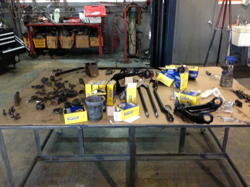

<img src="http://www.forcbodiesonly.com/mopar-forum/attachment.php?attachmentid=10926"/>
Here is my lay out table before assembly

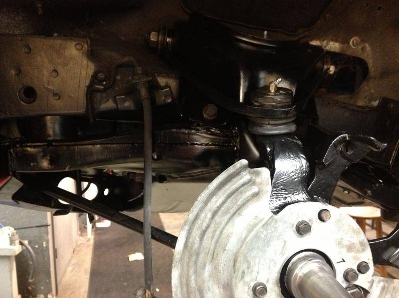

<img src="http://www.forcbodiesonly.com/mopar-forum/attachment.php?attachmentid=10928"/>
Upper ball joints also proved a challenge getting them to torque up to spec. Previous repairs had stripped out the threads. Ended up brazing in some bronze and then cutting the threads with one of the old ball joints... Worked out real well and tight.

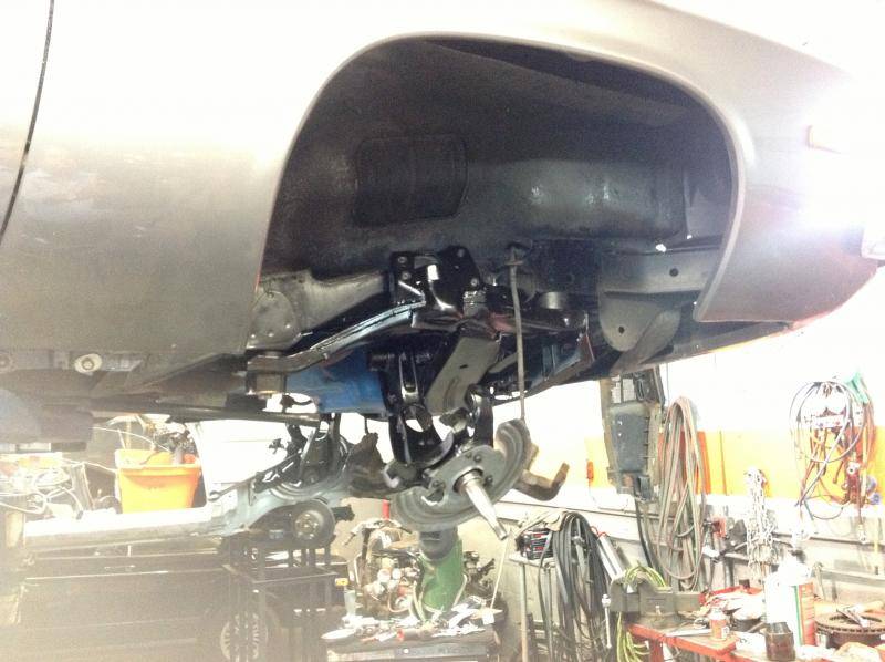

<img src="http://www.forcbodiesonly.com/mopar-forum/attachment.php?attachmentid=10929"/>
You may want to also look at you brake lines and shocks. Mine were shot... And again.... The new ones look and work so much better.
