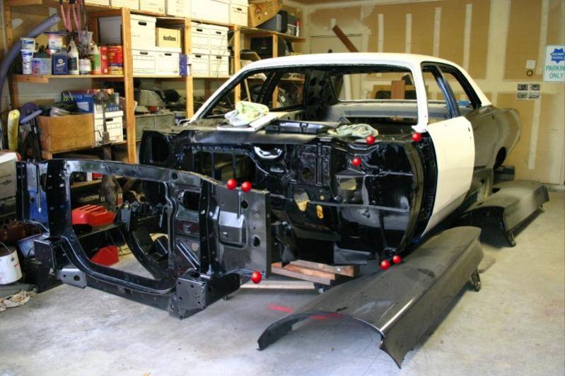

Fronts are bolted on and the rear quarter panels are welded in place.
This shows the 8 bolts that hold the fender on (both sides are the same)
The wheel liner has about 6 bolts into the fender, the fenders can be taken off with the liners in place.

Hi Robert, There is two tube braces on each side also. The two in the engine bay and one under the fender that connects from the fender to the firewall. That one is behind the wheel well. g
