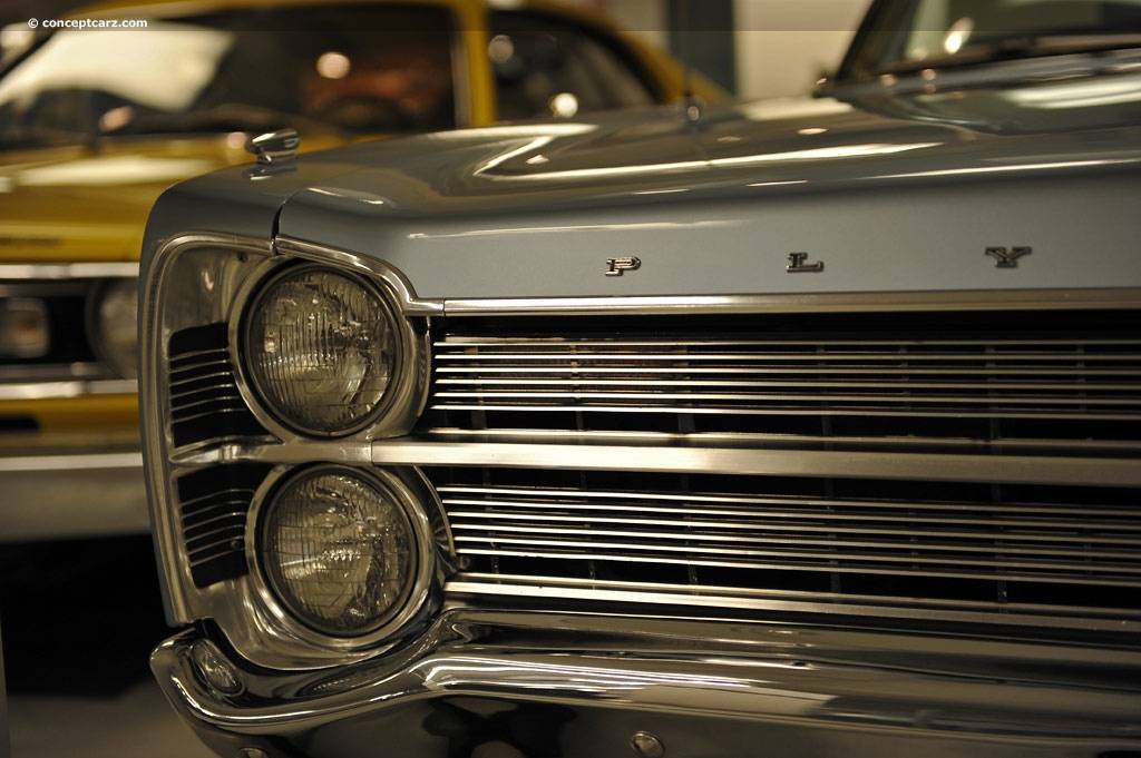

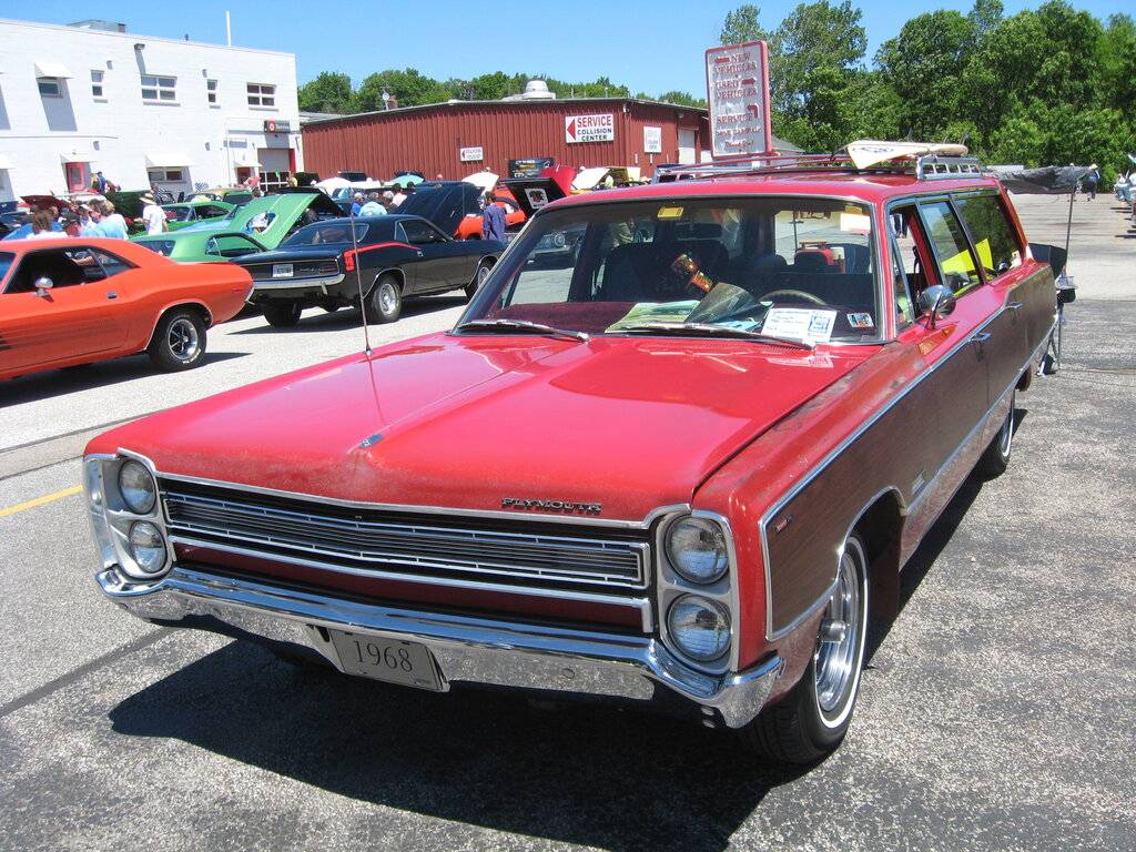

    • The 67 grille is a 1 piece grille vs the 68 which is 2 the grille and the mesh screen under the grille. The 67 headlight bezels are different the outside area next to the headlight is serrated and painted black, the 68 bezels are smooth in that area and painted argent colored. The 68 bezels also overlap to the grille and the mesh panel. Top pic is 67 front end bottom. is 68. The hood trim is the same on both years. Not sure if all the attaching points are the same between the two styles. View attachment 410589

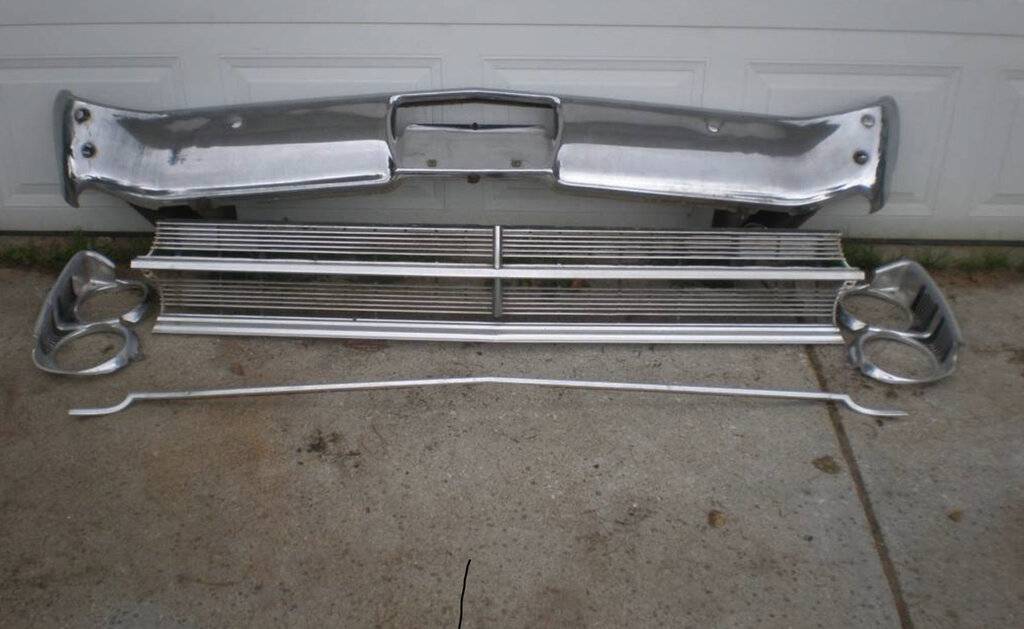

    Hamburg Germany
