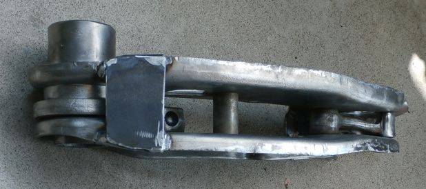

I would not use poly on the upper control arm bushings. They, like the lower bushings, flex too much. I thought that if you go with poly lower bushings that you needed to also go with the greasable pivot shaft? I'm still sorting out a problem with my PS gearbox, and maybe I won't feel this way after I get that fixed, but looking back I might have installed the offset UCA bushings instead of the regular bushings (to get more caster). I did weld a small extra plate (3/16) to the LCA to where I think it will do the most good:

The reason I would not put polyurethane bushings in the LCA is that eventually, they can fracture and break. Time, impacts, and similar. Any bushing or anything made of rubber or plastic, the oils in them will evaporate over time, which can degrade their location abilities.
With rubber, the rubber can visibly crack and "settle", but not break, as it ages and dries out. With the polyurethane sway bar link bolt grommets, over a long time, I have had to replace several of them that broke and disappeared, even the softer Moog ones.
On the Chrysler LCA bushings, if a polyurethane busing might fracture, it might be well-enough contained that the fracture would not result in a portion of the fractured item leaving its installed location. As this location is also related to the torsion bar adjustment, that might be something else to consider, to me.
When installing the poly link bolt grommets, I noticed that they would compress a bit, just as rubber will. But I also suspect this compression can be what can also make them fail if over-compressed for too long. In this case, splitting and leaving their location.
On the rear suspension, impact forces can be less than on a front components, to me. Forces would not be spiked, but forces reach their peak on a more gradual progression, than on the front end suspension. As the upper control arm bushings are about "location" and "pivot", that is why I would consider poly being better at that location than on any LCA location.
