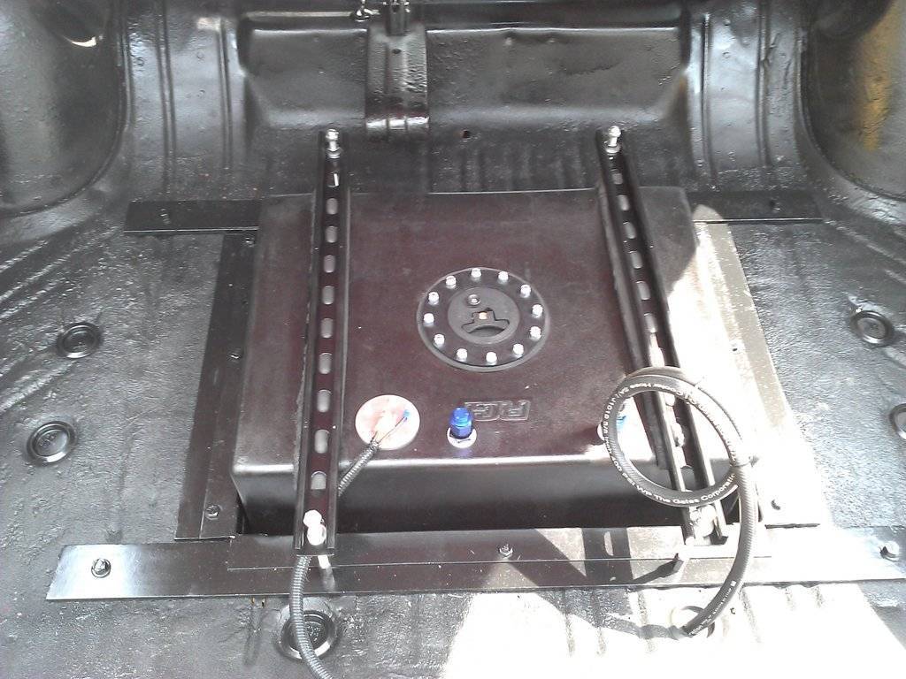

I have took the stock tank to try and get it repaired but it has rotted out to far to fix. Has anybody put a fuel cell in a 66 sport fury or tried putting a tank that measures 40 1/2 long. I found one that is the same size but almost 2 inch's longer. The width and depth is the same

Well after weeks of looking for a tank and talking to all the tank people on the web, I also measured for all the tanks to fit and none do. I cut the small are of rust out in the center and set the fuel cell done about 4 inch's and braced it to the rails on each side. If I ever find a tank to go back in I can because I save the straps and filler neck. This will work until I find one.
If you measured your tank and it was a lot different than Spectra's tank I suspect a previous owner may have put in a B-body tank. They are smaller but the same general shape and can be made to fit.
Most of these phone support people wouldn't know a Plymouth from an electric toaster so if you asked if their 67 Chrysler tank will fit a 66 the answer will be no.
Nice neat installation BTW.
I put one in my New Yorker because it was half the price of the replacement tank at the time. (Summit clearance aisle)

The car was bought new by my uncle then gave to my grandfather with 34,000 miles on it and it now has about 174,000. so I know the tank was original to the car. I will keep looking but it is great it is back on the road again. Thanks' for the comment on the install. Tracy
