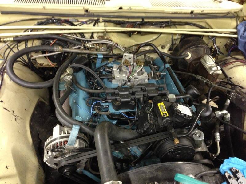

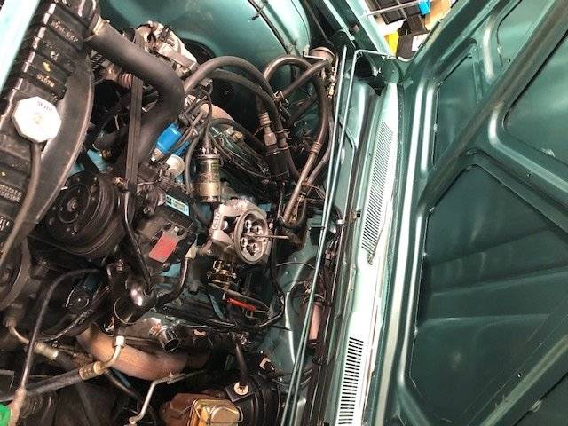

I have done 3 fuel injection installs on my fleet along with and wasted spark ignition.
One on the ford motor home with a 390. Has great power so it does not help with fuel economy. And two installs on both my 67 440s. One with MegaSquirt the other with MSD's Atomic EFI systems. All TBI installations.
Drove the MegaSquirt 440 about 360 miles last week and got a solid 19 MPG (Imperial). Great start and cold idle. Good power performance.

Have you posted any other information about the MS build? I'm interested on how you trigger the wasted spark. Crank trigger or cam. I've been thinking about using the jeep cam sensor to trigger coil on plug.
