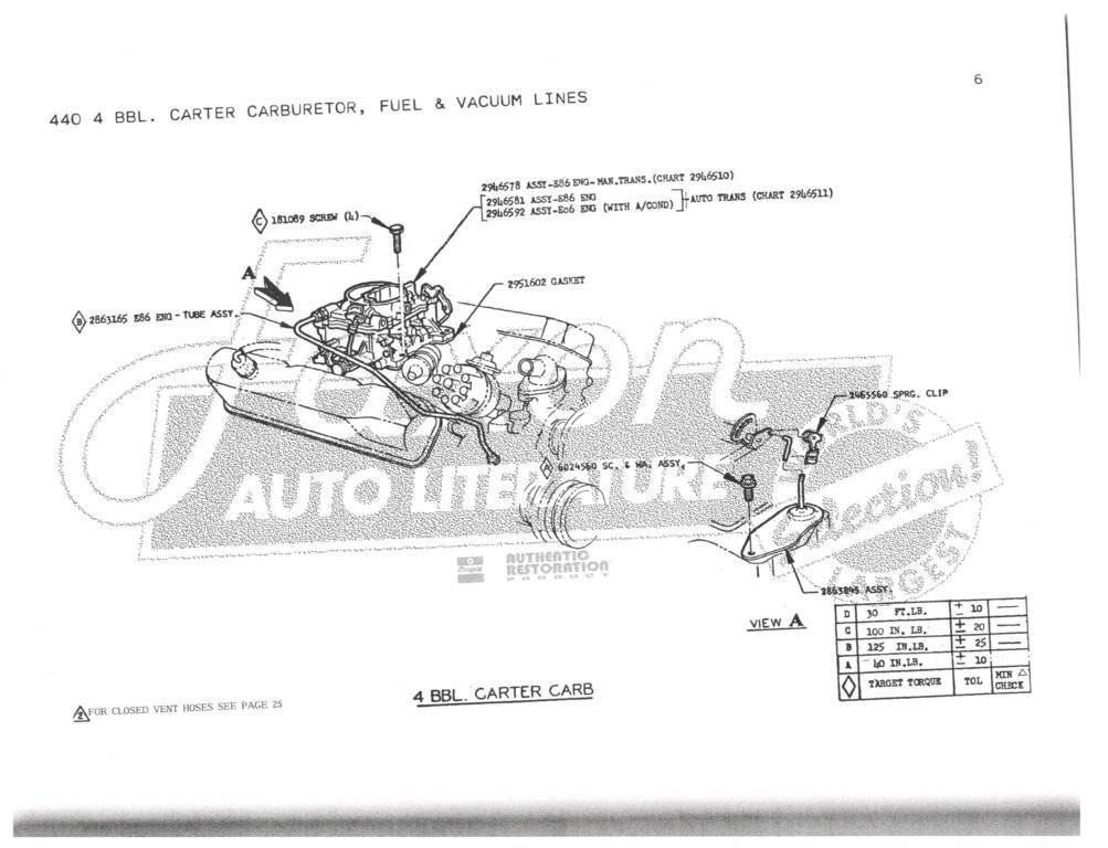

    Does anyone have a picture of how the hard line runs from the carb (Holley 4360) down to the filter on a '70 Sport Fury GT ?
    Everyone and his brother-in-law has a re-pop fuel line for the AVS equipped 440's, but the Holley equipped lines don't seem to exist. I had reached out to one vendor who lists them for 440/Holley A/B/E bodies and he says they are different for a C body.
    Why they would be, I have no idea. :wtf:

    These images are from the 69 Plymouth Engine Equipment Assembly Manual for all Fury's I through VIP and SW.
    Carter Image
    Holley Image
    • Thanks! Thanks! x 2
    • Like Like x 1
    • Agree Agree x 1

    Yep that second one looks identical to what is currently on the green 67 imperial coupe.
