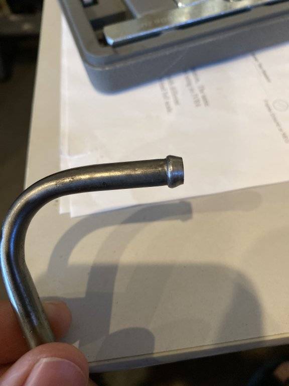

What type of tool do I need to re create the rubber hose barb on a steel fuel line?

This is what I want to re-create.

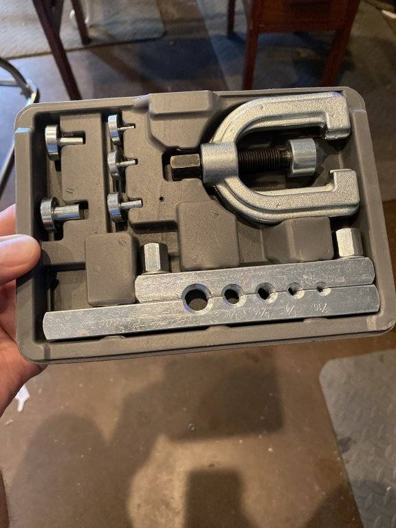

This kit won’t do it.

I think a buble flair will make that. Go to a shop in the area cant be much.

I've never seen a hand held tool that will do that barb. It might be out there, but I've never seen it.
What I've done, is to start doing a double flare, and then not complete the second part of the operation.
Ends up looking like a bubble flare.
when you use the double flare kit just do step one with that little adapter disc...that will bulge out the end of the tube...it won't look exactly like the factory one you have pictured but will be good enough to keep the line from sliding off...i have both double and bubble kits and cant remember which one does it better....and a properly clamped line wont slide off a square cut tube either
