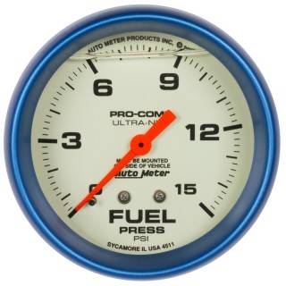

    I run this one, it also sucks. Sometimes it sticks on zero and needs a flick.

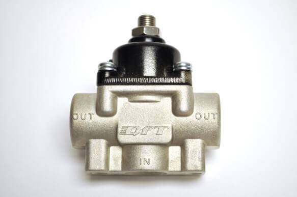

    This is what I currently run on my wagon. It has the Edelbrock big block fuel pump. It works well for me. I have it mounted on the frame near the core support and away from the engine heat. It has held steady PSI for 8 months so far
    Quick Fuel 30-803QFT Pressure Regulator

    I thought so too. But, as someone has mentioned, the Edelbrock carbs are sensitive to fuel pressure and my new 650 AVS II was acting up. I added a gauge and regulator and the issue went away.
