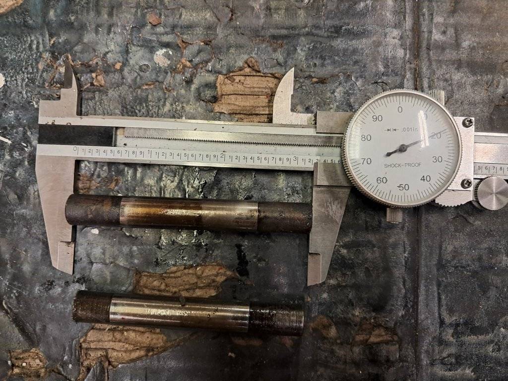

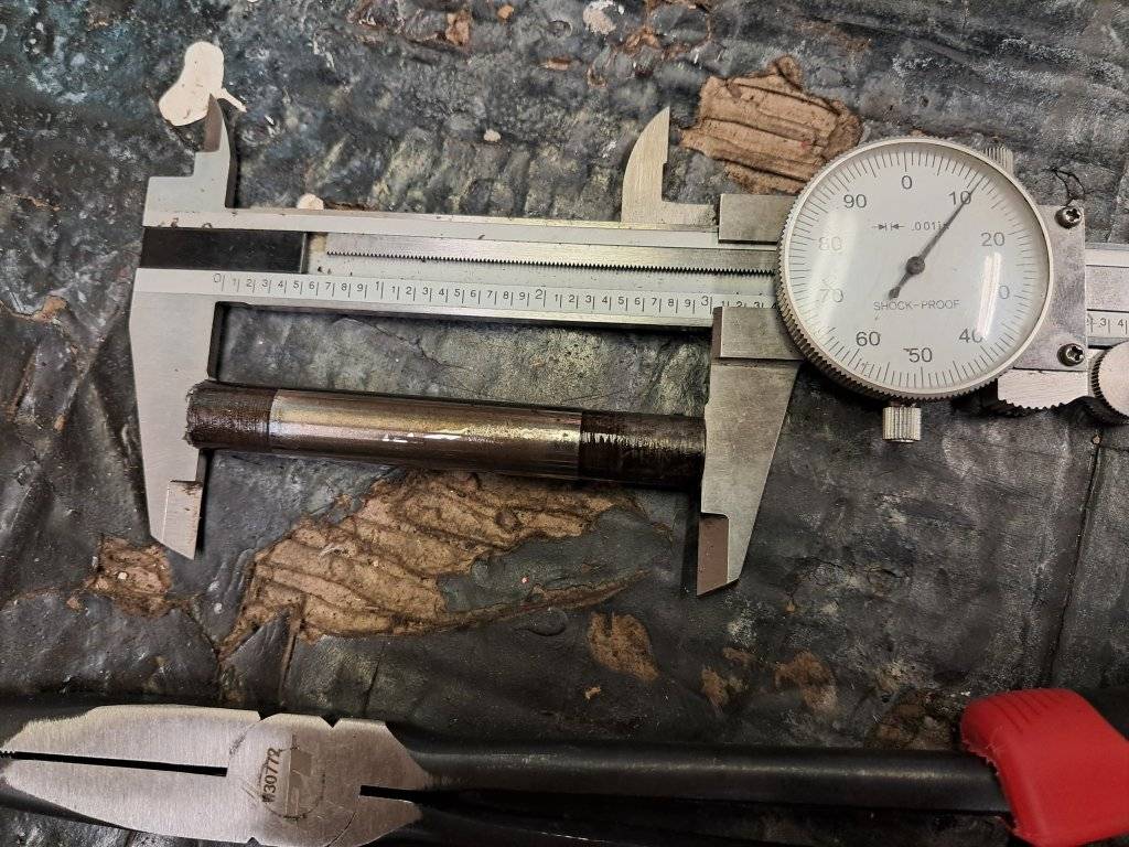

In April, I had an OEM fuel pump pushrod grind down. ***** to get out, because of metal ridging on ground end. Caused hard starting, 7 inches of vacuum only. Couldn't push fuel past the fuel filter. Cam lobe OK, fortunately fuel pump pushrods are made softer than cam lobes.
But look at the difference:
Ground end at left.
Here's a good OEM pushrod. 3.220" is correct length
