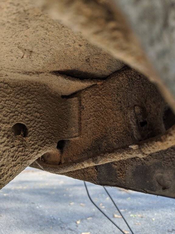

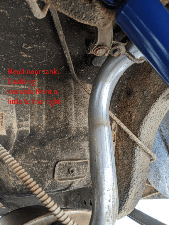

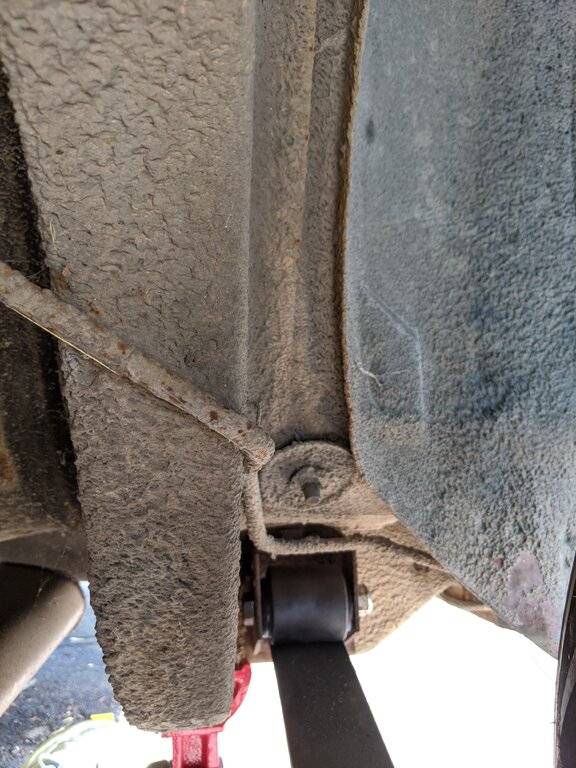

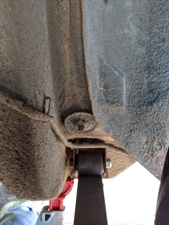

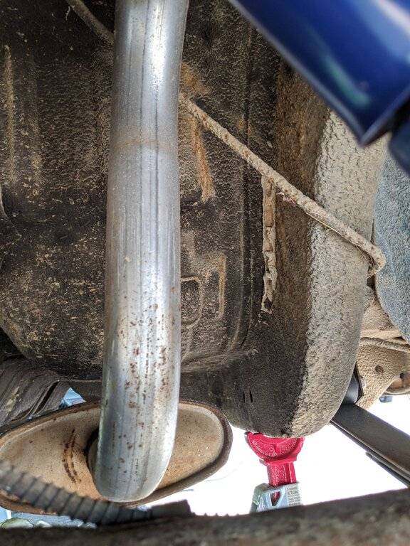

I have inserted some pictures below of my car. Hopefully they aren't too confusing to figure out the angle of the photo. The Fuel line goes out towards the passenger side, then runs on the outside of the frame , then more towards the middle of the car it comes back inside the frame

I'll agree with Dave and then say I've done it the diy/hack way for 11 years now. My fury has the oem 5/16" line with the CA emissions vapor line as the return.
Walbro 255 pump hanging in front of the leaf spring mount.
It feeds my efi turbocharged 383.

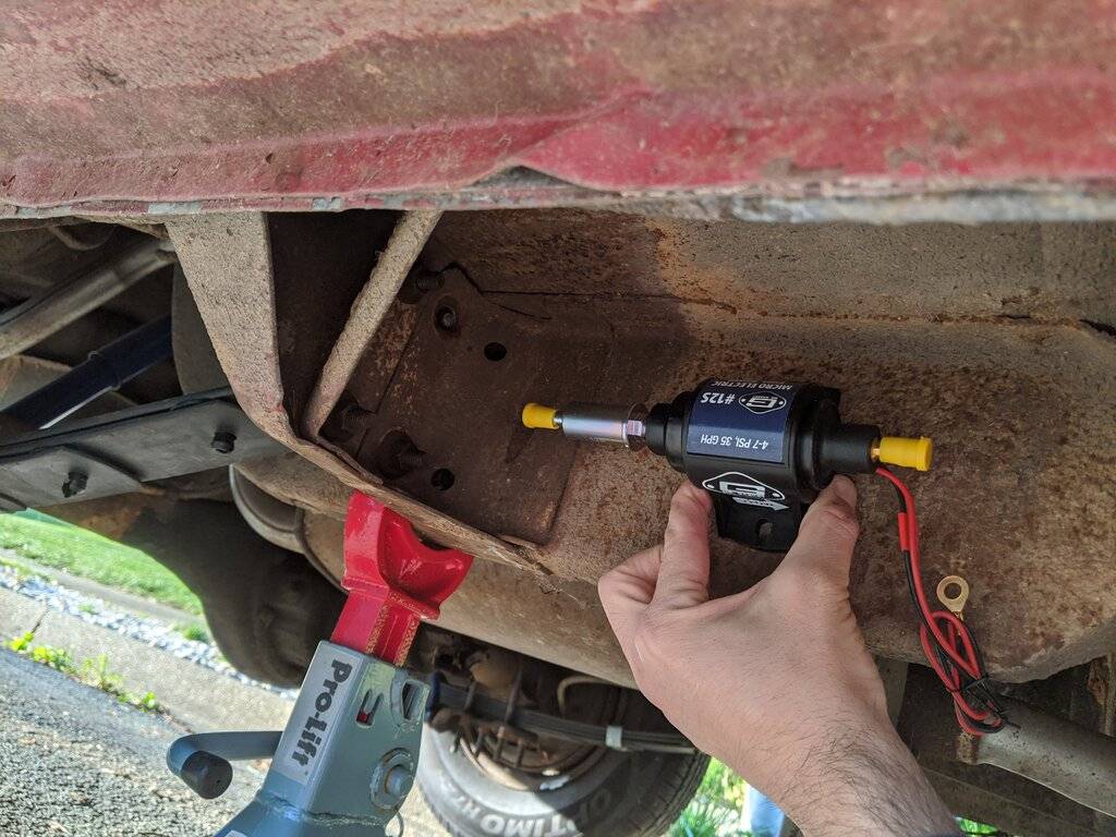

I was under the car looking for a good mounting place again. Can you mount these small pumps sideways like this or does it have to lay flat?
My walbro doesn't care because it's a slip fit into it's bracket. I wouldn't think yours would care either
