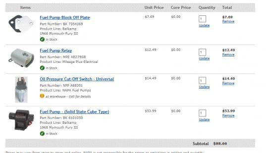

damn I don't want to have to put an electric fuel pump on my car.

im looking at electric pumps, but don't know if that will fix it. my gut says no.
