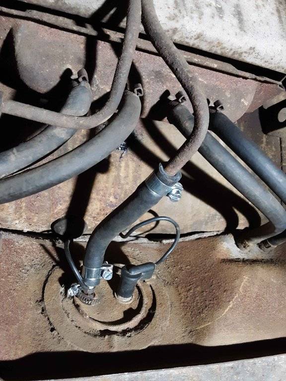

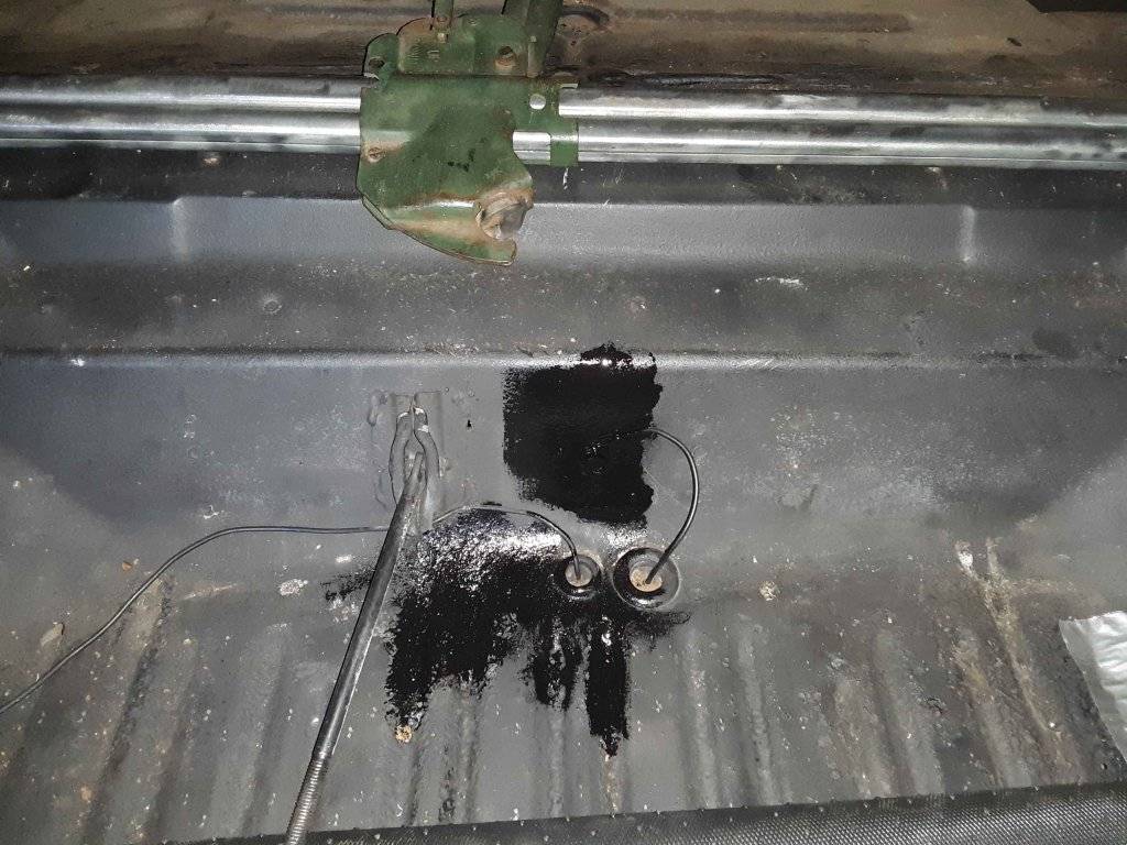

Sep 22, 2022 #2 1970FuryConv Old Man with a Hat Joined Aug 8, 2014 Messages 5,762 Reaction score 5,484 Location Richmond, VA This is what I did on my 72 Fury Opposite end of ground wire in trunk With the sending unit off the car, other members have soldered on a spade at the sending unit base.
