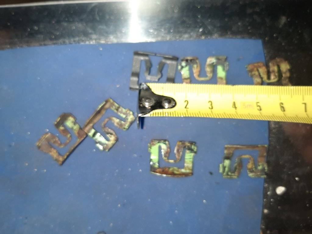

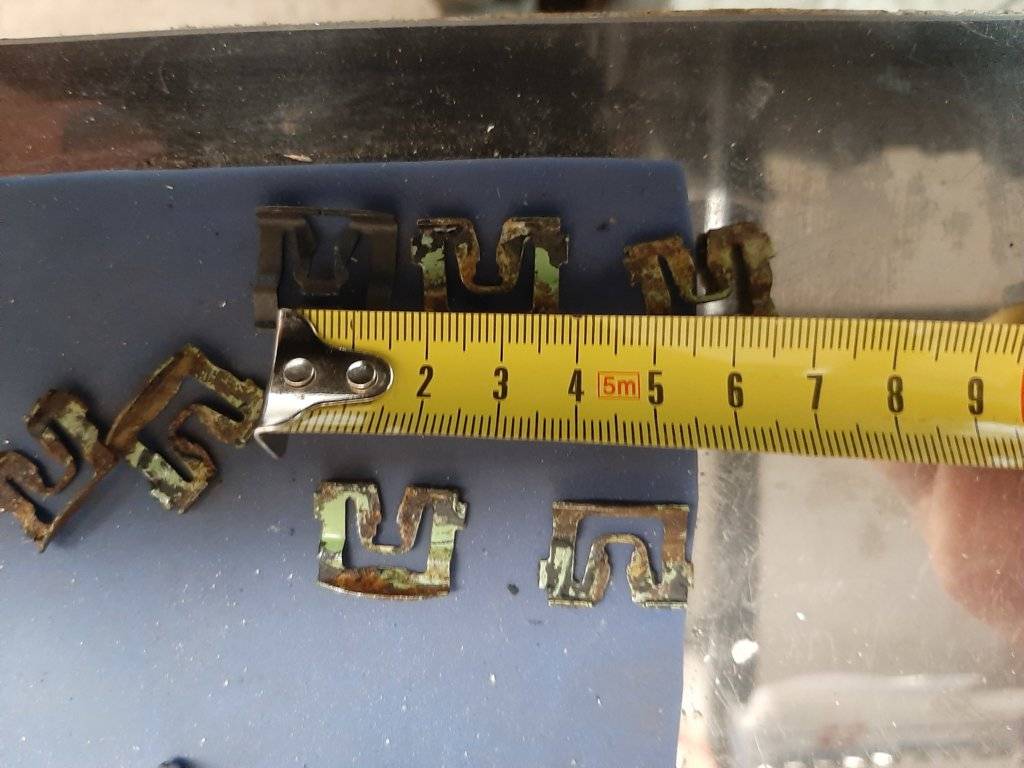

Installed a new windshield. But some of the clips for chrome moldings are lost. Ordered clips from METRO wf231. But they didn't fit. The black clip is new. It is a little, but differs in size.
The photosshows old original molding retainer/clips. Can someone tell their order number on the site rockauto.com? Thanks,
Stepan
Based on your pic and measuring tape,I checked my Auveco catalogue.
The following numbers are very good match.
Check them out
10622
11611
9882
8941
Homepage
Any parts supplier carries Auveco including NAPA
BTW,speaking from experience,I install the clips BEFORE installing the glas,FYI much easier.
