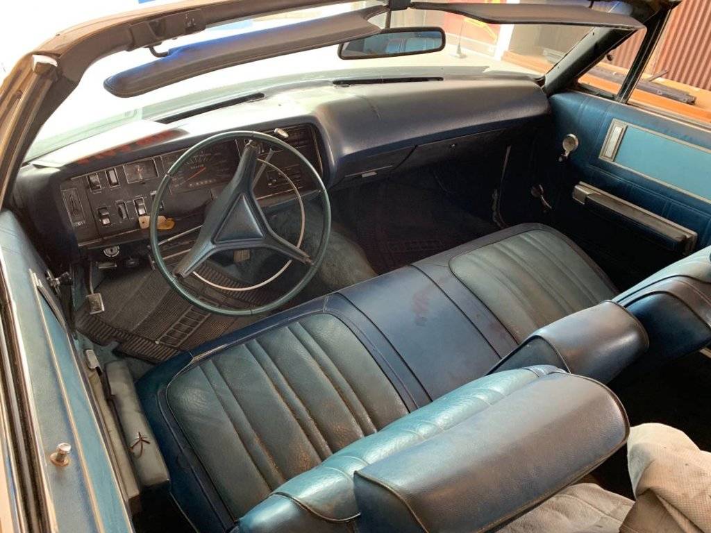

    Sorry, here is a pic of the interior. The fender tag pic didn't turn out. Not many codes listed.

    I have parted 3, 69 Fury III Convertible in collecting parts to restore mine. Mechanically everything can be bought easily. Interior wise the seat covers are reproduced by Legendary. Carpet can be bought from ACC, and other bits and pieces are attainable

    www.abcmoparts.com has the replacement arm rests and pads. www.justdashes.com does dashpad restorations. www.smsautofabrics.com does the door cards and has the seat fabric materials. www.convertibletopguys.com has the top kits.

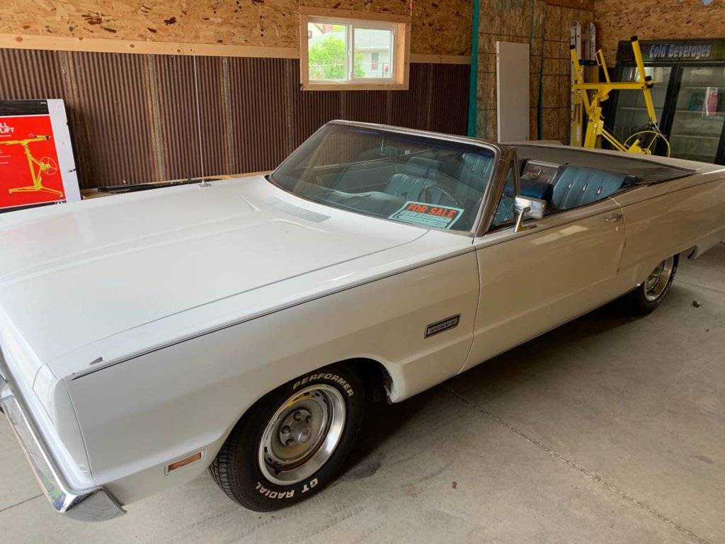

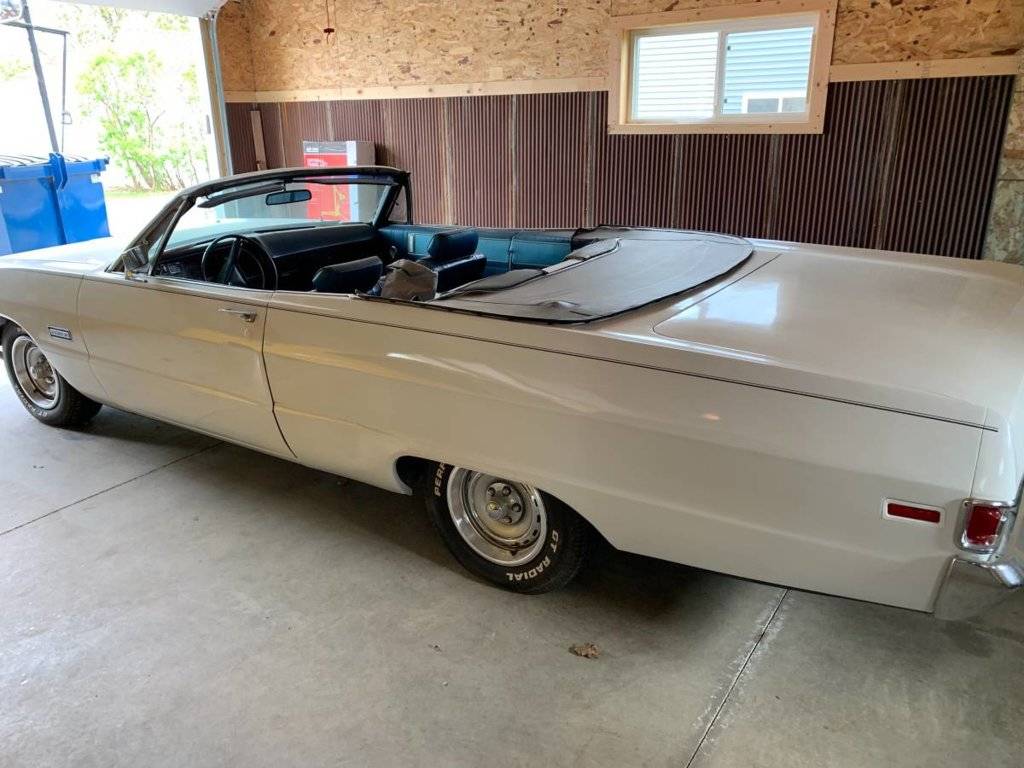

    Thanks everyone for the knowledge drop. That's helping to curtail some of the fears I had of repair/replacing the top. And I completely spaced popping the trunk. I had an instructor tell us to never to restore a convertible, they're a money pit, never get your money back out of them.
    I'll share a few photos from seller ad. When I took a look it wasn't this clean, had alot of gravel dust over the whole body and interior. Again sorry my phone won't let me post the pics I took of the dent and fender tag. If I do purchase her I'll get them with a real camera.

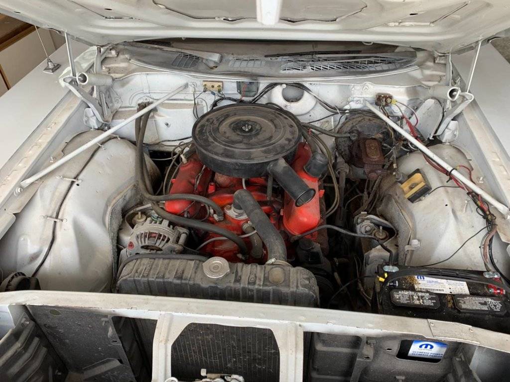

    i see white paint over everything under the hood so that would make me a little wary before handing over any $.

    I am guessing somebody probably took this car to Miracle for one of their cheepo paint jobs. The paint work under the hood is about as bad as it gets and all of that mess will probably peel in the not to distant future. Makes me suspicious as to what the fresh paint is hiding. 318 car with few options, I would give it a value with a solid floor set of about $3800 due to the rotten top and crappy paint. To do a fair evaluation, one needs to get eyes underneath to check floors and frame rails; also needs to have the top frame checked out, as long as it is not rusted out or badly broken, that can usually be repaired. If the frame, top frame and floors are rusted, this is about a $2.5k car or less.
    Dave

    when you check for rust, check the floors, trunk floor including the rear rails, lower quarters , lower fenders, edge of the trunk lid and cowl around the wiper motor area. these areas are all repairable, but it might help with negotiations. the under hood wiring looks suspect but it is hard to tell from pictures.
