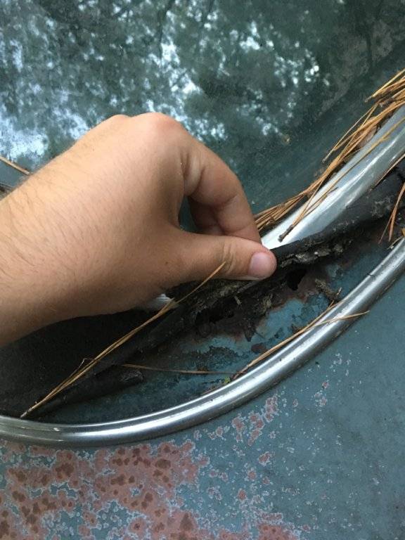

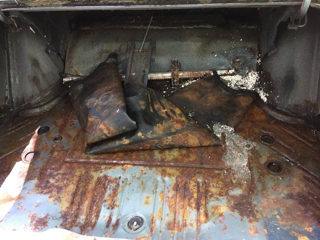

    024BA078-EF1D-4059-AD74-E1FB32AF73D4.jpeg A1548B66-21D9-47E4-9020-A59FBD3EFA6F.jpeg
    When I cleaned out my trunk, I noticed a bit of sunlight towards the front of the trunk. Sure enough, there were rot holes where the vinyl was coming up under the rear window. Took some spray foam and duct tape and made a temporary patch.

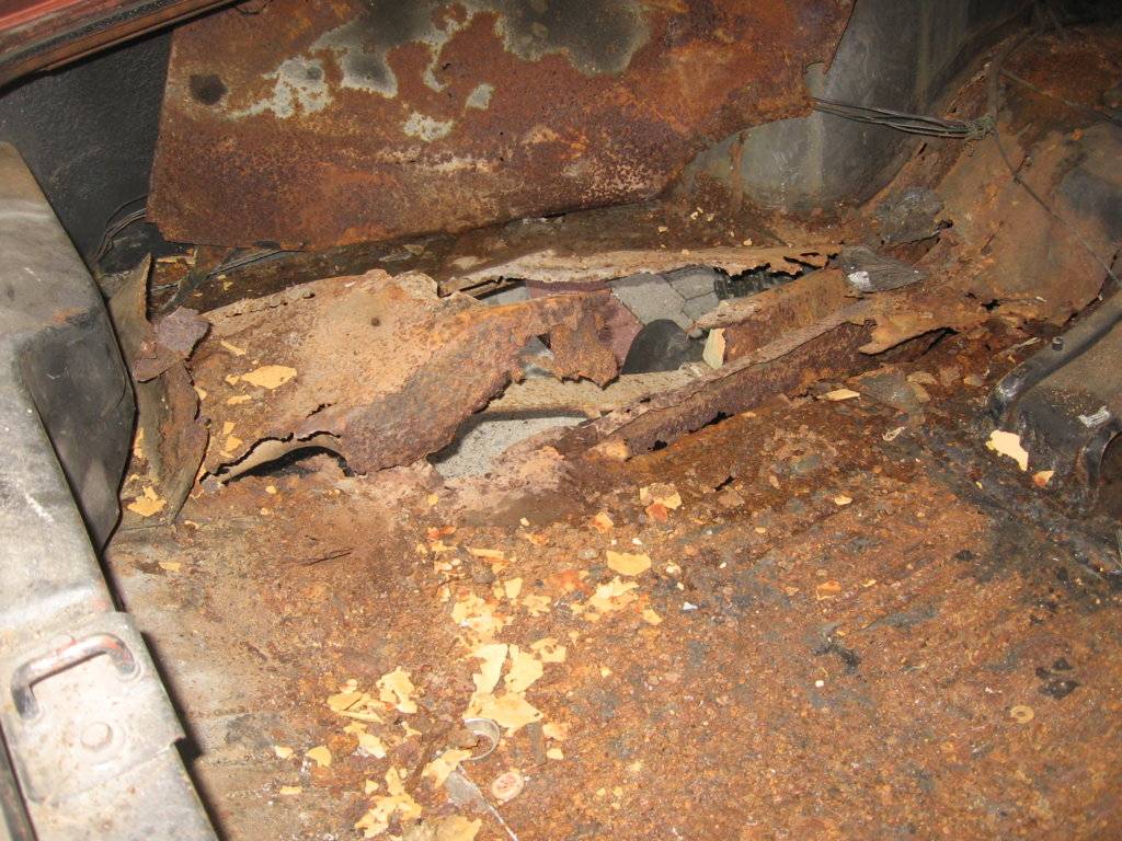

  18. cbarge
    cbarge World Famous Barge in a Budget FCBO Gold Member
    Messages:
    3,299
    Likes Received:
    3707
    Joined:
    Nov 22, 2010
    Location:
    Kingston Ontario Eh?
    This is what happens when a rear window leak goes untreated. Sister Donor Car...RIP

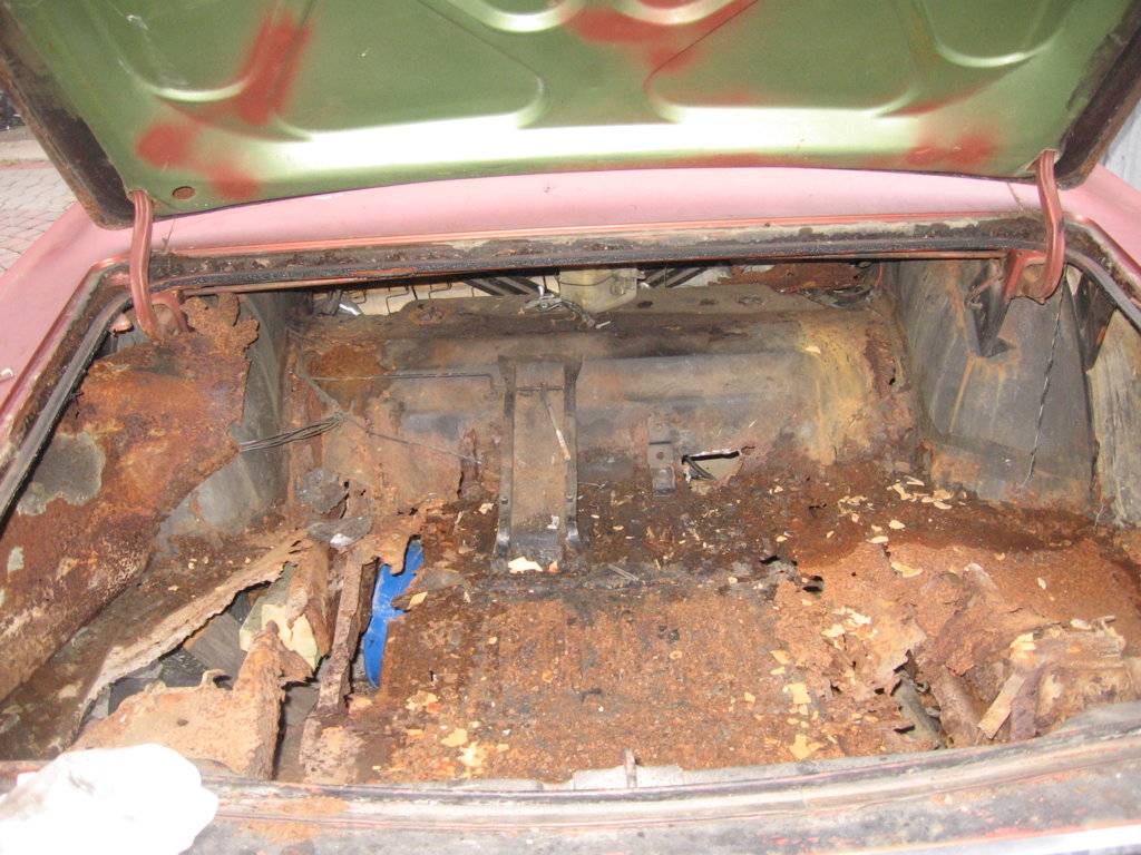

  19. Dodgy Dick
    Dodgy Dick Active Member
    Messages:
    245
    Likes Received:
    59
    Joined:
    Mar 13, 2016
    Location:
    Queensland, Australia
    YIKES, Would want be a very rare specimen to tackle that sort of rust challenge, Bravo!! Pics please of completed job?

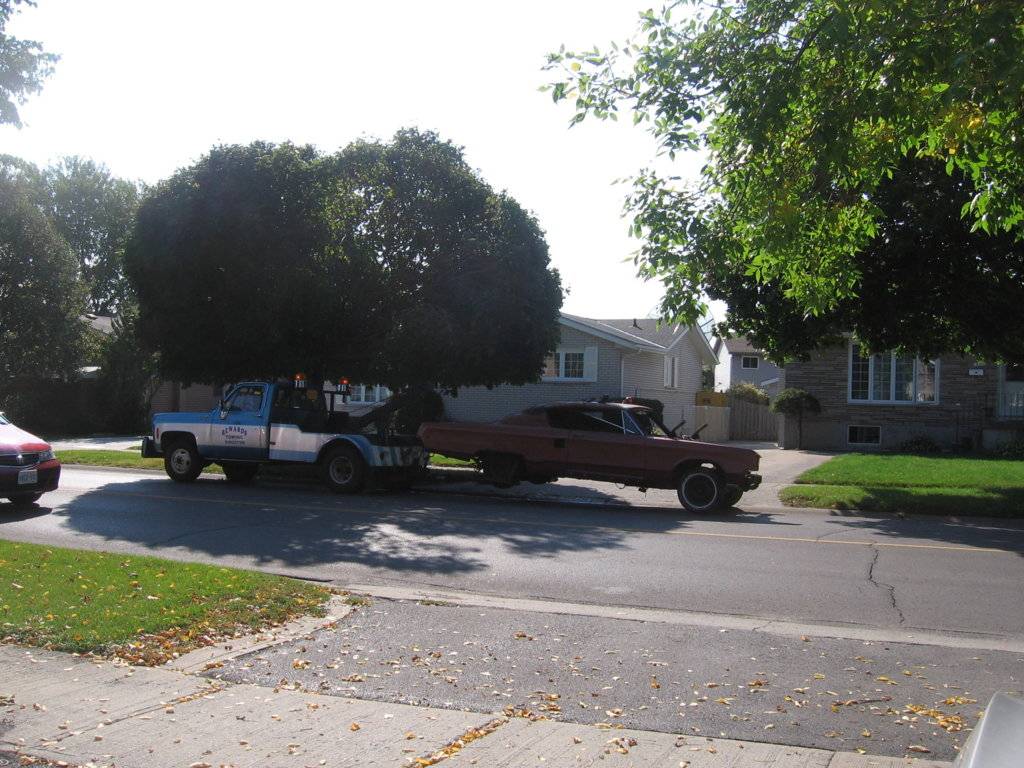

  20. cbarge
    Messages:
    3,299
    Likes Received:
    3707
    Joined:
    Nov 22, 2010
    Location:
    I parted it out got towed.
