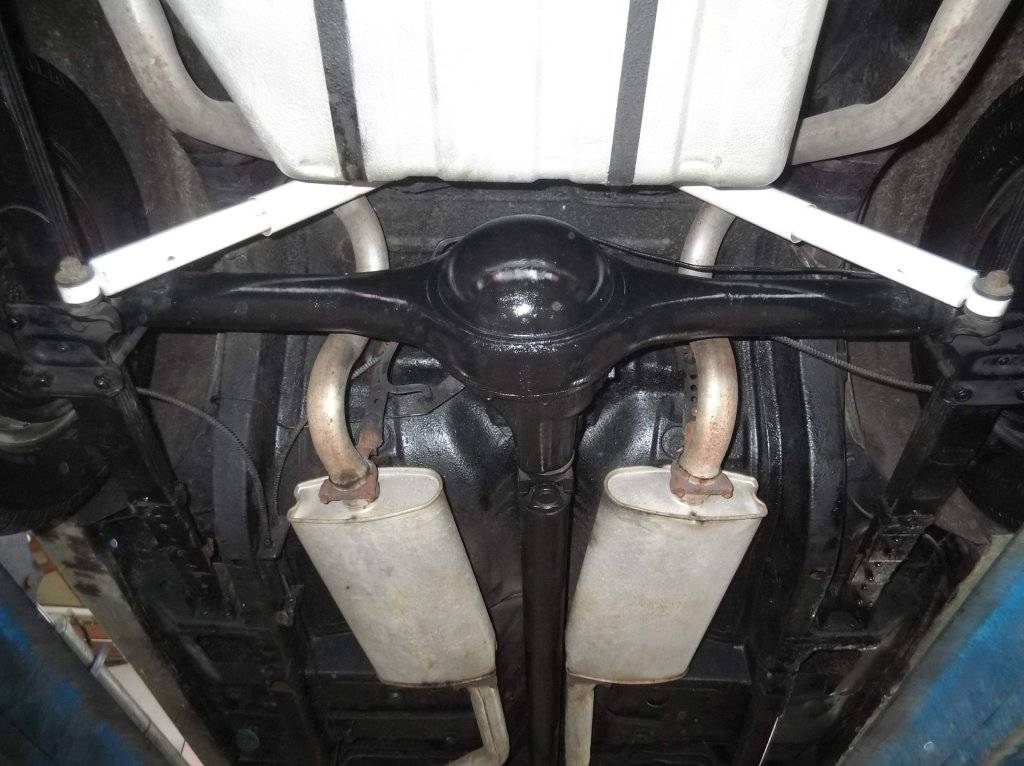

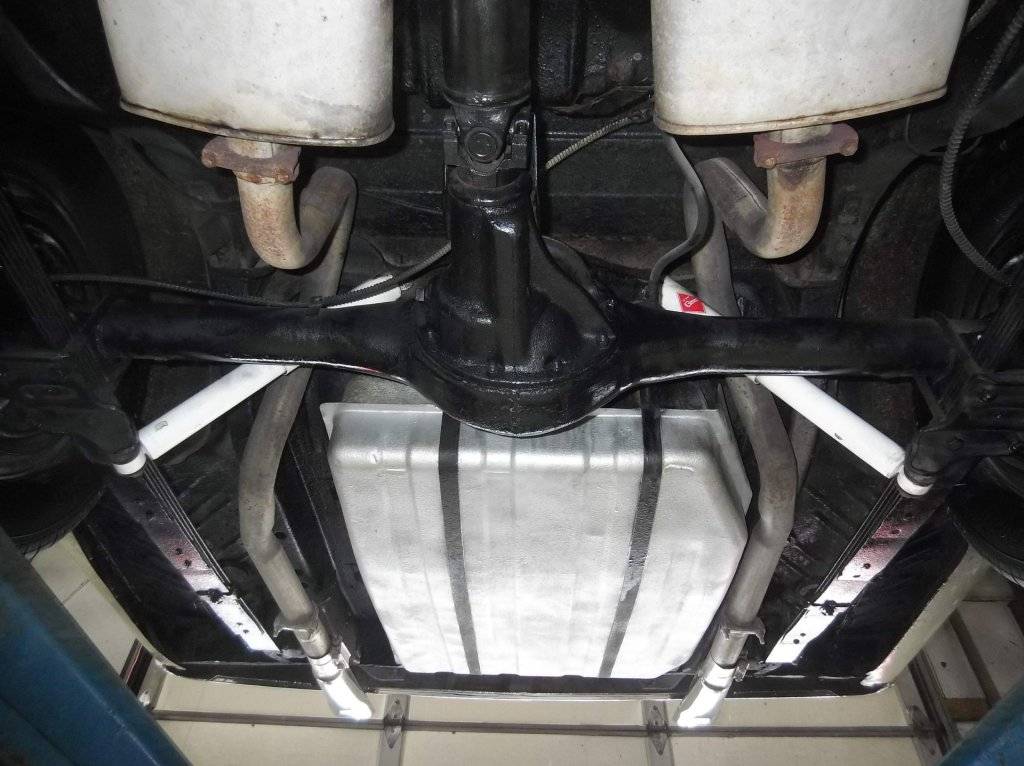

As an old dude from the 70s, I've had & ran both. Spoiler alert they use to be made by the same company. My personal opinion is this ... an air shock is an air shock. Downturn the air lines by exhaust the results are not good. We always ran the air lines inside the trunk. We put their T behind the license plate for easy access. We ran the air lines through a rubber grommet to get into trunk. Also from experience, carry a Bic stick pen with you. As you have never lived till pulled over for bumper height tape measuring. Just use pen end lower shocks. Air back up asap.hope that helps

ok thanks. I see the munroe's are $80 cheaper... both have plastic air valves now...
I see what you mean.. (images are for reference only, not my car)
