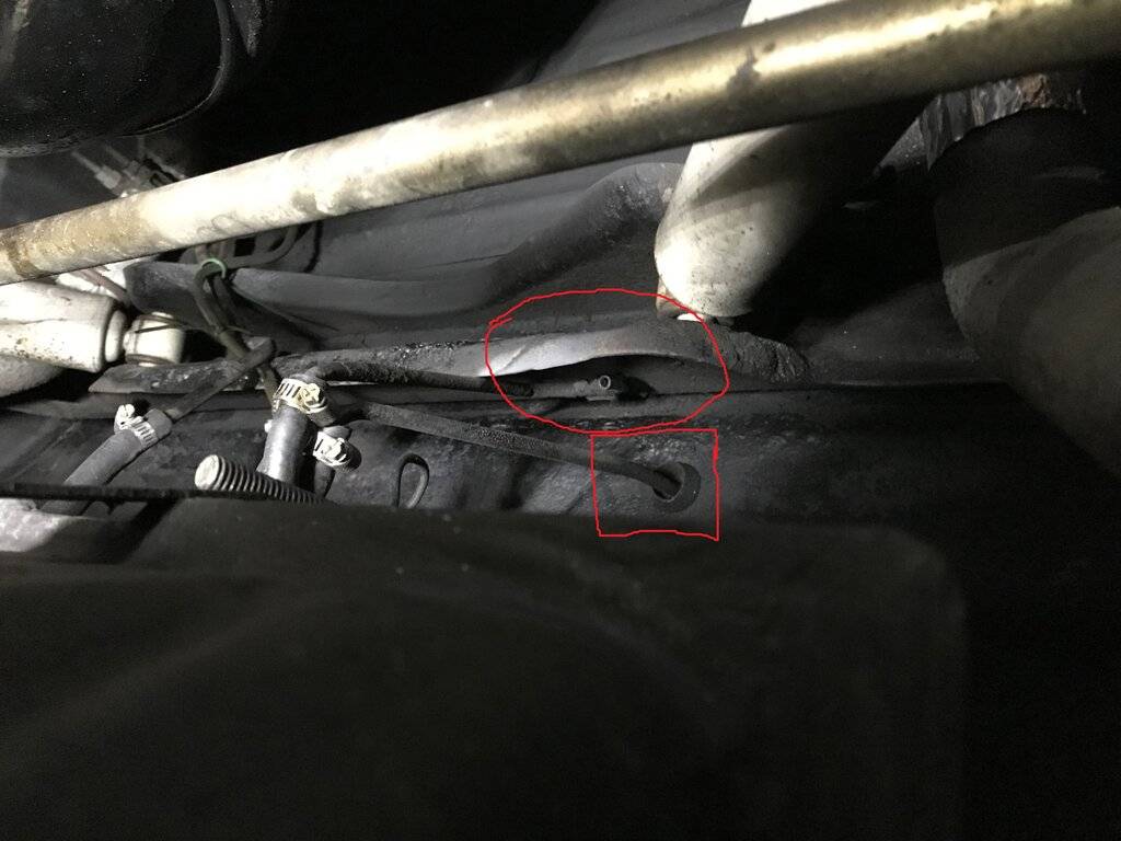

Bought 1970 300 Hurst without fuel tank and installed a 1972 Newport gas tank. Runs good, nothing leaks when driving. Only happens when gas tank is more than 1/2 full. After approx 1 minute of it being parked, I hear gas tank percolating like a coffee pot and fuel comes out of one of the vents for about 10 seconds. It makes approx 6" round puddle. When percolating happens, I removed non-vented cap but no difference, no vacuum sound.
Maybe I put them on wrong? Circled is the vent where the gas bubbles out. Square is the 2nd vent that goes into the trunk and comes back out under car but I couldn't see exactly where. Looks like it comes out above the exhaust but doesn't leak. 3rd line is fuel to carb. 4th is return vapor line from carb to fuel tank. (pretty sure its only vapor going thru this line from carb)
Ignore loose cheap chinese stripped clamp. There's another one on there.

You might try attaching a COILED tube to the leaking one, to give some length of tube over which the petrol vapor might cool and condense back to a liquid state. If the vapor condenses in the tube, it may then be sucked back into the tank as liquid later when the contents cool and settle to a less agitated state.
I drive a '66 Newport with 2 vents on the tank. Be SURE that BOTH vent lines have their openings WELL ABOVE the top level of the tank, to further minimize the likelihood of agitated gasoline dripping out in some quantity under the stationary car. Living in 110F heat and driving in some of the worst of it, I too must attend closely to this issue.

No, you can't cap one. That will make the problem worse. Better to somehow add a few to the top of the tank and have them go "somewhere", but that's not quite do-able.
I have this same problem of "vent bubbling" of gas when the tank is over half-full, particularly in hot weather. My '70 300 has two vents. For discussion purposes, there is a short one just outside the tank and clips to the crossmember, and a long one that goes up into the trunk and then back down into the frame rail. Both are in perfect condition and fully open to airflow (meaning no mud dauber wasp plugging them up).
However, my exhaust system was custom made (second owner) and it runs very close to the gas tank on both sides. THAT is the problem. The gas gets too warm, vents off, bubbles out. Sometime a little, sometimes a lot. Sometimes never when the airflow on the highway keeps thing cool enough or the weather is unusually cool, but creeping in traffic and/or shutting the car off is a sure way to get gas on the ground. :mad:
A coiled tube (moonshine, anyone? :D) won't work. There's too much gas and vapor when things get hot. Our giant, flat tanks allow for lots of sloshing to force raw fuel into the vent piping, then the expanding vapor from the heat pushes it out. Interestingly, my long tube into the frame is the worst culprit, opposite of what you'd normally think. So....maybe once that long tube is full of gas, a siphoning effect takes place with air INTO the tank coming from the short tube. No proof, just a thought.

Thanks for the quick responses. You guys have some great ideas. Ugh, I thought this was going to be an easy fix. My gas tank doesn't get hot at all. The 72 gas tank is more narrow, so exhaust is not near it. I think bubbling is only happening after I park it. Maybe from gas coming back into tank from gas line or vapors being released from return line. I'm afraid if I buy vented gas cap and cap 1st vent line which is the one leaking, gas will flow thru 2nd vent line which has its dump out tube over exhaust before it comes out the vented gas cap (because vented gas caps need a certain amount of pressure to open, correct?).
I don't want any liquid fuel escaping at all, so I'm going to drill a hole in my trunk to extend up the 1st vent line and second hole far away from any heat or electrical to vent. But there is pressure behind the fuel, so this probably won't work either. I don't know. I have a marketing degree, I'm not an engineer, but after working with auto engineers for 20yrs, they're not that smart either.
How do you know your tank doesn't get hot enough to vaporize gas excessively? You said it only happens when parked and above 1/2 full, and you can hear percolating.....like a coffee pot. Hmmmm....last I checked, percolating means "hot"!
As for gas coming back into the tank from the gas line or the return line, that's what those lines do, and it's a big tank compared to the few ounces in those lines. You mentioned that you might have the vents on the wrong tank nipples. The vents in the tank have different "locations" inside the tank, so swap them around and see if that helps.

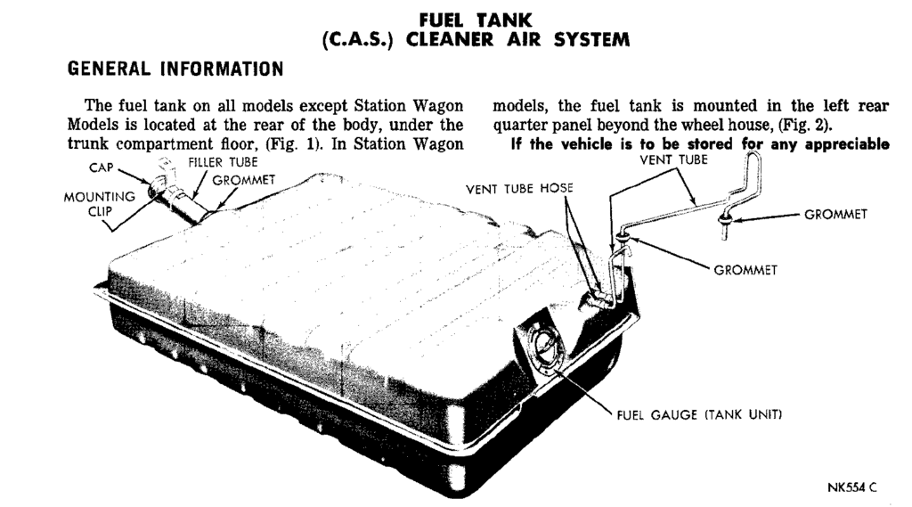

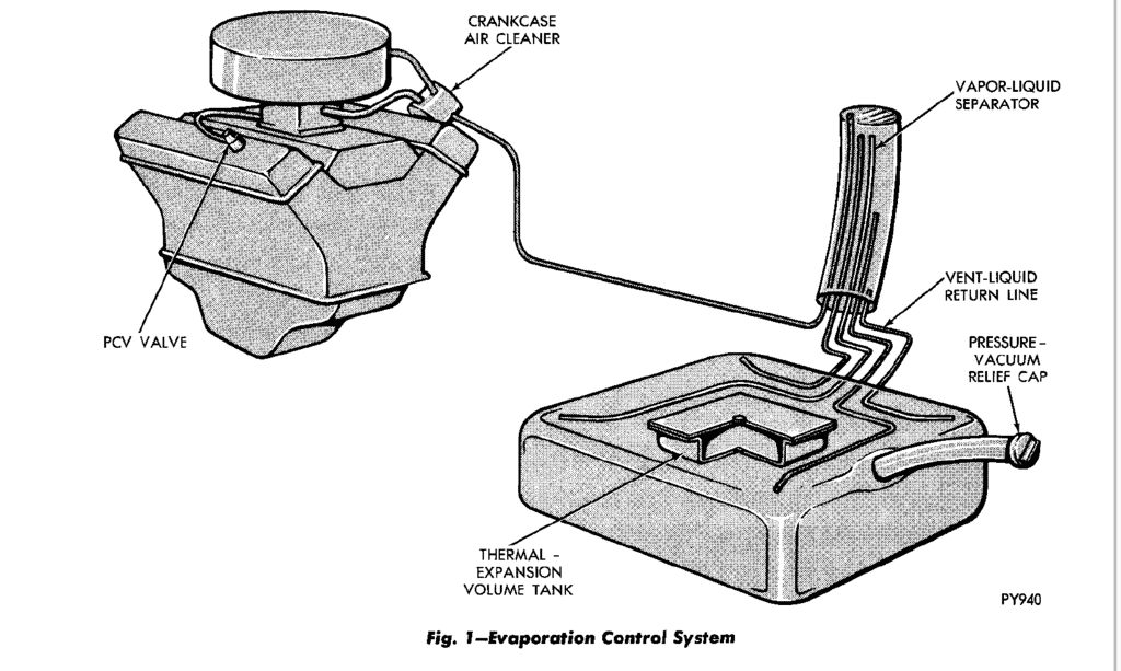

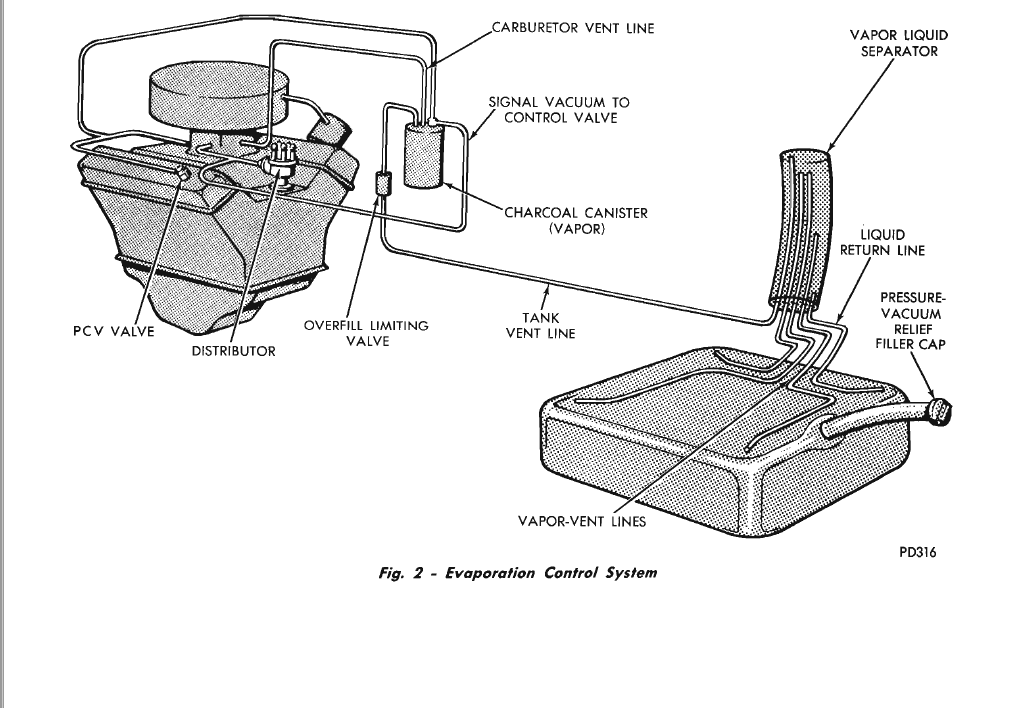

Fuel systems were changing on a yearly basis in the late 60's and 70's to address changing vapor emissions laws. Seems like your car might have had a single vent system originally, but your 72 tank has extra vents for the later vapor separator system. There should be no vents on the 72 tank open to atmosphere- they all need a hose going to somewhere. The trick is to determine what remains of your original system, and adapt your later tank accordingly.
Samples of the different systems-
1970 CAS system
1970 ECS system
1972 system
If your car does not have the vapor seperator (it would be located in the "hump" over the rear axle), you can cap off the extra vents in the tank.
First, this is a very good post for general thinking about various fuel vent arrangements over the 68-to-72 years.
The 70 Hursts (and I would think all 300s but maybe not California cars) had the two vents that I describe in Post 4, and no Evaporation Control System (the funny looking thing in the trunk). From the 70 FSM, it states "Certain Chrysler vehicles are equipped with....." whereas the 71 FSM has "All Chrysler vehicles are equipped with.....", so yes indeed, we can see the changing times on a yearly basis exactly as you mentioned. Interesting that some cars in 70 got closed systems/vapor recovery/carb vents back to the crankcase/etc and others didn't. Again, I believe this was due to Cali.
But back to the 72 tank (which is definitely an ECS tank) installed in a 70 (definitely without the ECS plumbing), the OP might find success by studying his three vents, determining which one would have been the "return line" that goes forward to the engine, capping just THAT one, and opening the other two. Or, maybe just using the "return line" and capping the other two. Hell....my car pukes gas so what do I know? :(

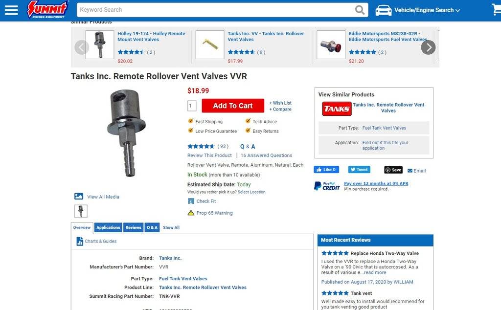

Would a fuel vent valve work? Would low pressure vapor escape but keep approx 5-10 seconds of puking higher pressure liquid gas in?
No. It's just a vent, like the bare end of our existing vent tubes. The only difference is that it's like a snorkel valve that keeps gas in the tank if you're upside down, which means you have bigger problems than some gas on the ground on a hot day.
