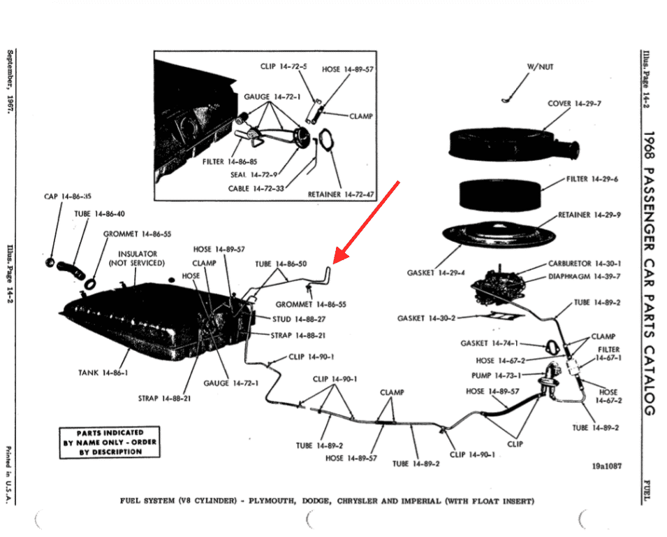

Great question @Big_John
I was wondering about the gas cap as it doesn't appear to be vented. When I take the cap off to fuel up it does release pressure. How would I know if it is the right cap?
I don't see fuel around the vents but I also don't know where the second vent tube is routed. One vent is short and shaped like an upside down U. The other one looks like it goes up into the body somewhere. Will get some pictures when I get back in the garage.
When I replaced the tank I did replace the short rubber lines that connect to the vent tubes but I don't know where the second vent tube is routed.
The vent I am curious about is the one with the red arrow in the attached. I reconnected this with new rubber line when I installed the new tank but I have no idea where it is routed.
The second tube goes into the frame rail. If you overfill the tank, gas will drip out of that tube and onto the ground, just in front of the left rear wheel.
I don't believe the cap is vented with your car.

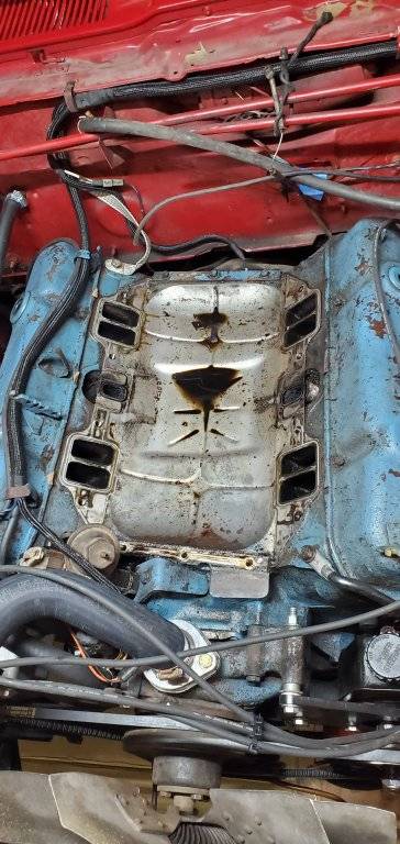

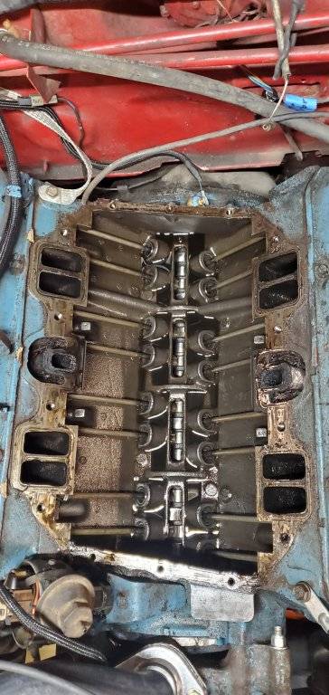

Took the intake off to investigate the oil on top of the valley pan. Considering how little I have driven the car, there was a good amount of oil on top of the valley pan.
I don't see any cracks in the oil pan although there was no gasket, very little gasket maker around the ports or near the end plates and every bolt holding the intake down had oil covering the threads. Aside from very minor scoring on the cam and some carbon build up on the exhaust crossover ports it looks clean which is a welcome relief.
I did notice however when I removed the carb that all four bolts had worked themselves loose. I am wondering if this might be related to the smell of fuel.
I am going to replace the valley pan and reinstall everything and will report back.

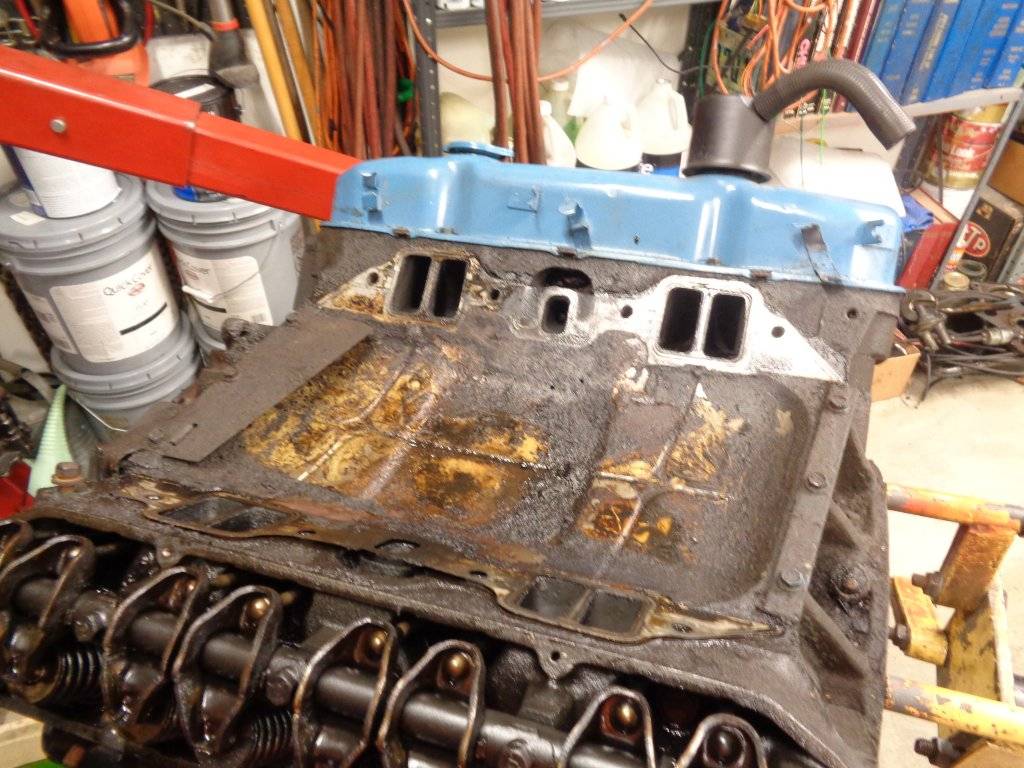

Some will disagree, but I'd replace it with a valley pan with a blocked crossover. I believe the Fel-Pro part # is 1215 (double check that). That may help with your hot starts.

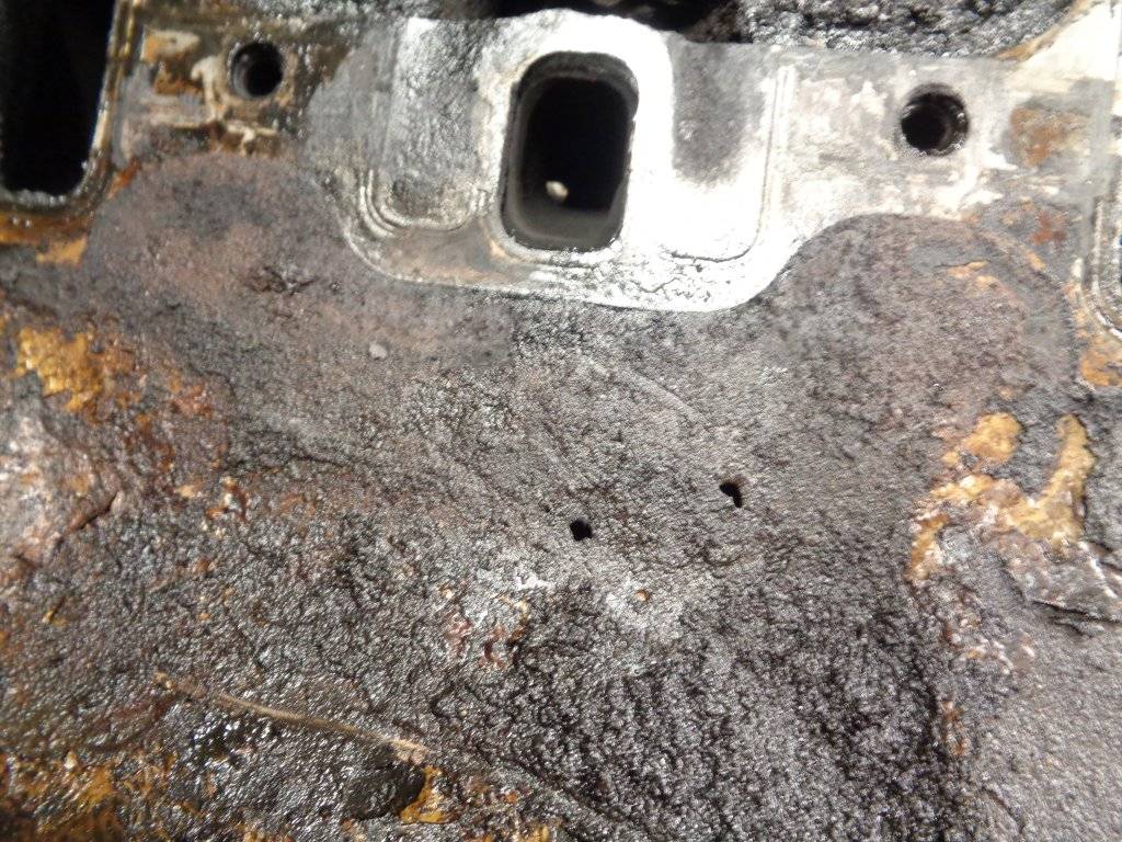

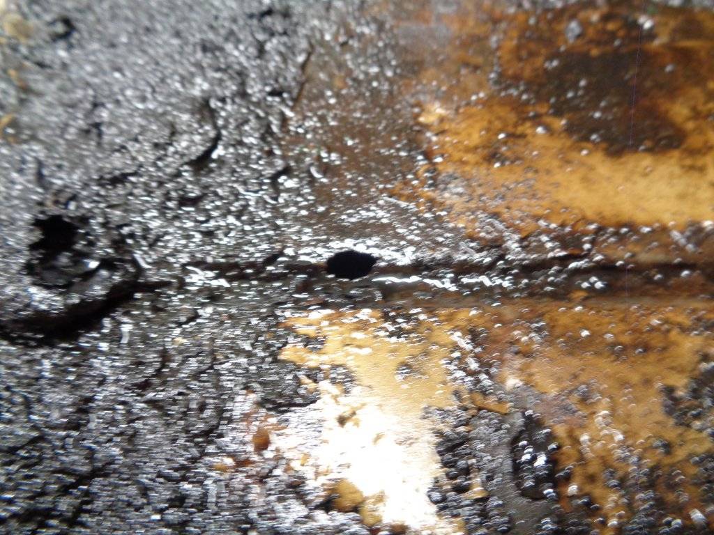

There is also the possibility that the Intake gasket/ valley pan could have a small perforation/ hole in it. Here is an example what can happen.

I installed one of the Fel-Pro valley pan with the blocked crossover on the 'Party Barge' for a couple of reasons. Hot restarts was one and it also saves scorching the paint of the intake manifold.
Word of caution, if you are using the original style choke thermostat (manifold mounted), then your choke will need to be re-calibrated. I replaced mine with an electric choke. Easy to install and you can calibrate it without having to remove it.
The 'down side' is that it is not stock looking.
The 383 starts fine and time that it takes to achieve curb idle is much faster.
