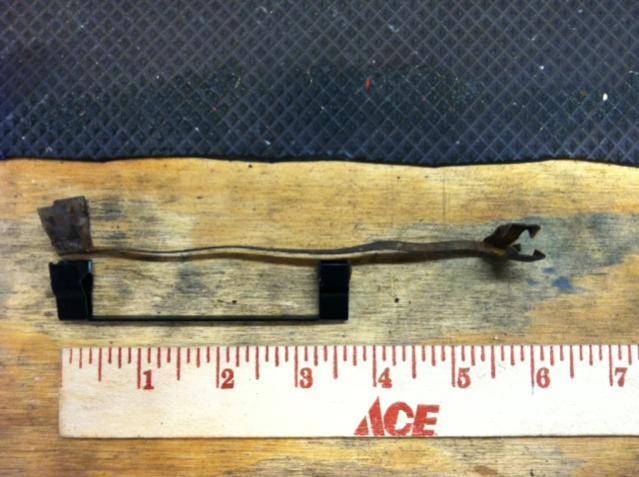

If you decide to replace the ground strap, make sure you get the right size. I made the mistake of purchasing one assuming they were of the "one size fits all" philosophy. The photo below shows the one from my 73' Polara and one I purchased from an aftermarket vendor that specializes in A/B/E body Mopars. The differences are obvious.

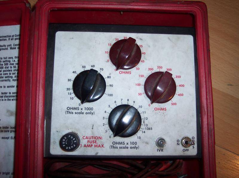

Take some time to diagnose the wiring. A test light connected to the sending unit wire to ground should flash on and off. That's the regulator working. Use an DVM to measure the resistance of the sending unit. About 10 ohms full and 70 ohms or so empty. You can also use a variable resistor box. If you don't have on you can also use a volume resistor or may be the resistor part of a headlight switch. Connected from sending unit wire and chassis ground back at the tank. With the ignition switch in the on position, if the wiring to the gauge is good you should be able to make the gauge move from full to empty.
Hope this helps. Remember to disconnect the distributor wire so you don't burn your points while you have the ignition switch in the on position and enging not running.
