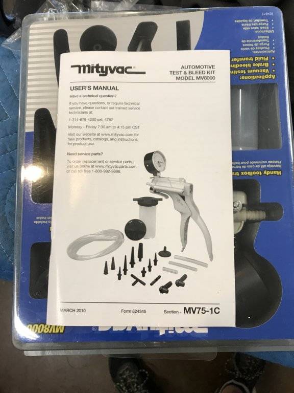

    Have you blown any air through your lines disconnected from fuel tank to the fuel pump? You said you replaced all the rubber lines, so unless a clamp is loose you shouldn’t be sucking air through there. Also I believe there is a check valve in the fuel pump that is supposed to prevent the fuel from draining back to the tank. I believe the manual at least 68’ talks about how to check it. A small hand pump vacuum gauge could be your friend. As said above. Try it with your cap off or loose first.
    I think $45 at Oreilly

    It depends on where the pumps are made, I have some first hand knowledge of the Chinese made pumps as I had two of them fail over winter before I switched to Real Gas in the resting cars, I also quit using those pumps. Never had that problem with Carter pumps. Most modern diaphragm pumps have ethanol compatible rubber parts, that does not mean the metal parts such as the check valve will not corrode. If you decide to invest in a small vac pump, you can try blocking the rubber hose where it hooks into the sending unit for the tank. Pump the fuel pump end up to about 15psi vacuum and see if it will hold vacuum. If the vacuum drops off fast, that probably means you have a pin hole from rust in one of the steel lines. There was a section of steel line that runs thru the back of the stub and cars in the rust belt were notorious for a rusty line in that location.
