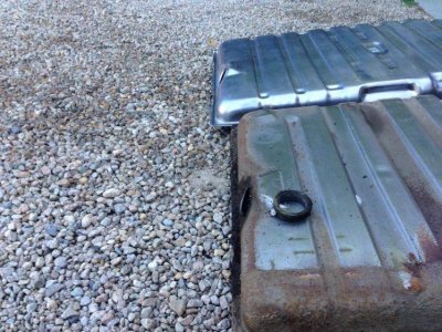

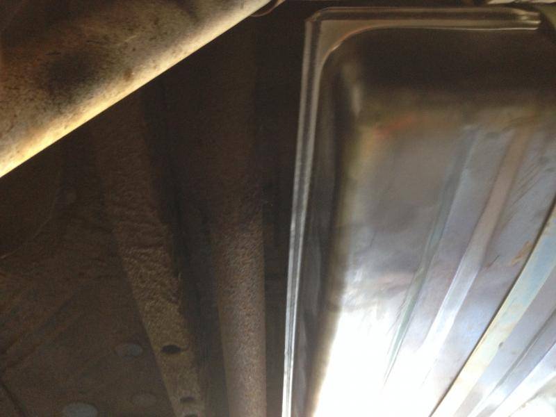

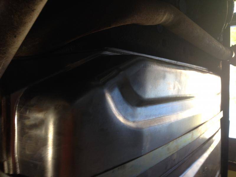

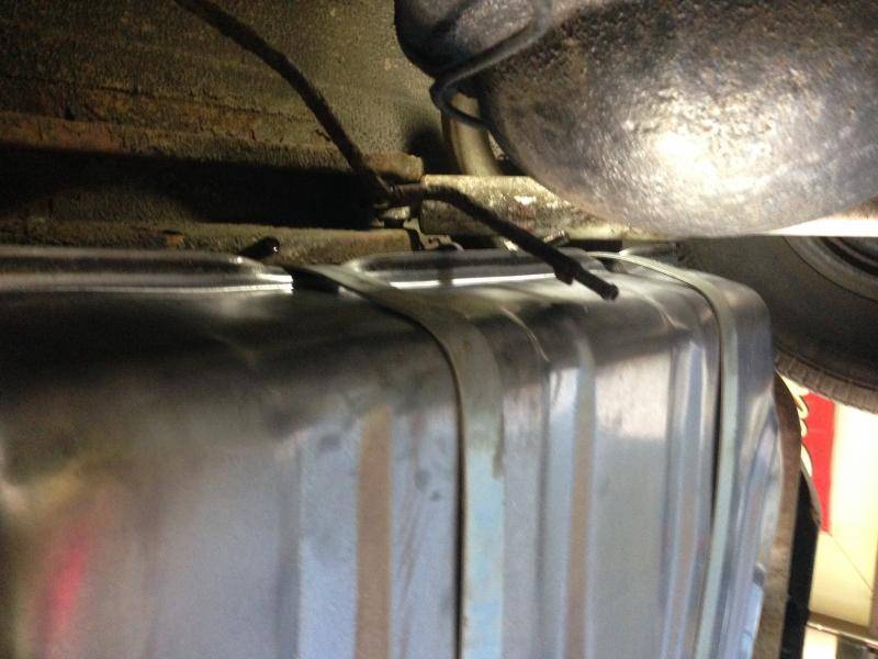

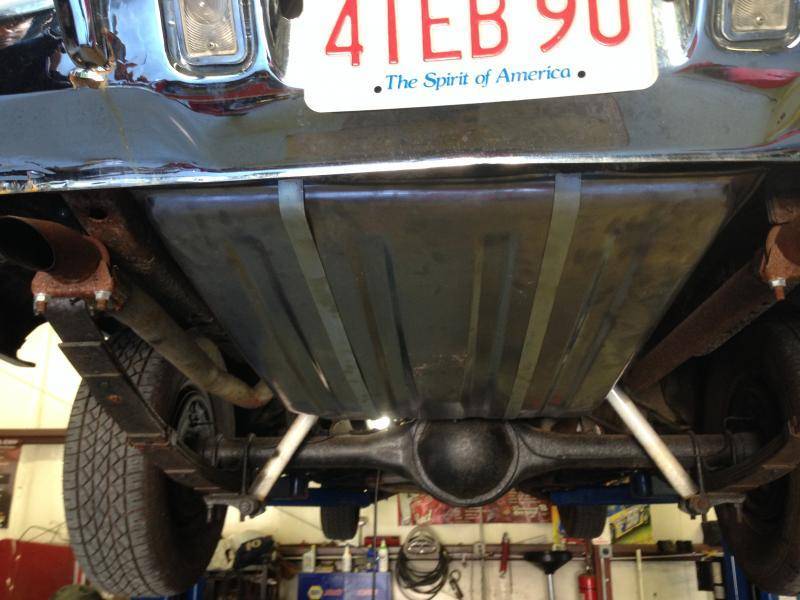

    new tank is in
    • Like Like x 1
  15. Joeharley01
    Joeharley01 New Member
    0   0   0
    Messages:
    20
    Likes Received:
    8
    Joined:
    Jul 9, 2015
    Location:

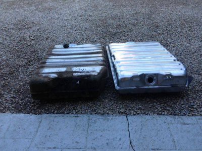

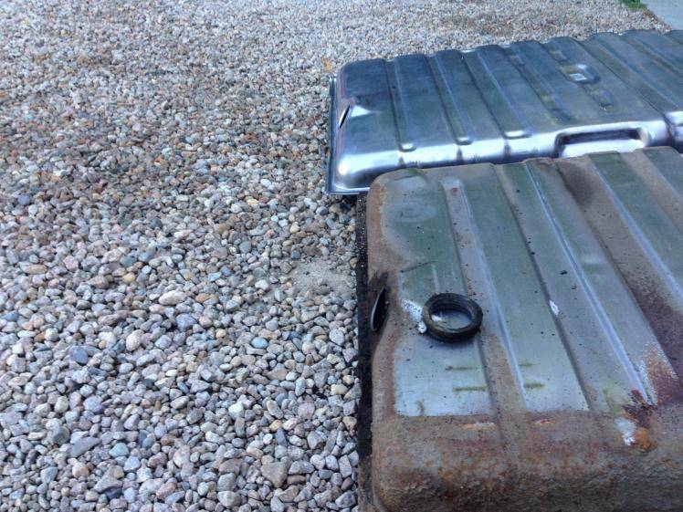

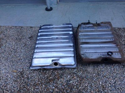

    New Bedford,Ma
    As you can see in the pics. new tank was 2 inches longer,but fit in same location without any modifications.Tank was supposedly for 67-73 C-body only,would not fit 65 or 66. IMG_0931.jpg IMG_0939.jpg IMG_0940.jpg IMG_0941.jpg
    • Like Like x 1

  17. 300rag
    300rag Waiting out the storm FCBO Gold Member
    Rating - 100%
    1   0   0
    Messages:
    12,937
    Likes Received:
    14580
    Joined:
    Dec 4, 2010
    Location:
    Calgary, Alberta, Canada
    How did the extra length affect the straps?
  18. commando1
    commando1 Old Man With a Hat on the Porch FCBO Gold Member
    0   0   0
    Messages:
    34,977
    Likes Received:
    19581
    Joined:
    Mar 10, 2011
    Location:
    FUHOA Reservation, Sebring, Florida
    I'm guessing the J-hooks had enough thread on them?
  19. Joeharley01
    0   0   0
    Messages:
    20
    Likes Received:
    8
    Joined:
    Jul 9, 2015
    Location:
    New Bedford,Ma
    The extra 2 inches weren't a factor at all.Everything went back together without any issues,and we ended up replacing the fuel line all the way to the pump just for added insurance.Only problem we did have was the gas gauge is now working but its not accurate.We started with 5 gallons of gas and I figured it would probably read about 1/4 of a tank.Instead it was reading 3/4.We did use a new sending unit that was marked for 65-66 C-bodies with 5/16 line.
