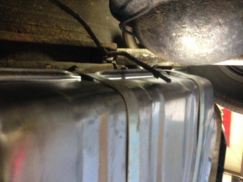

That '65 tank is pretty unique looking. Thanks for all of the pictures, very informative. Did you use new straps, and if so were they for a '65 or '67-73 ?
I did use new straps and they were for 65-66 C-bodies,but I didn't use the original mat,probably should have gone with a rubber one.

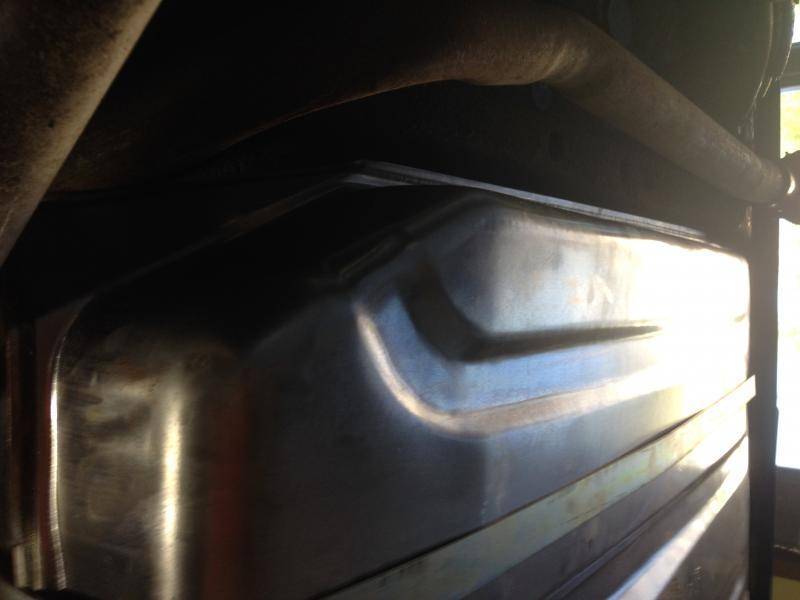

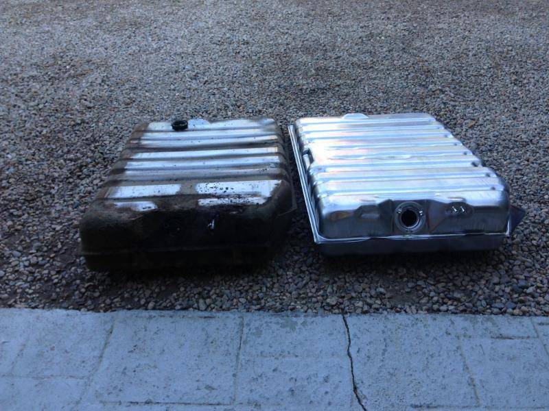

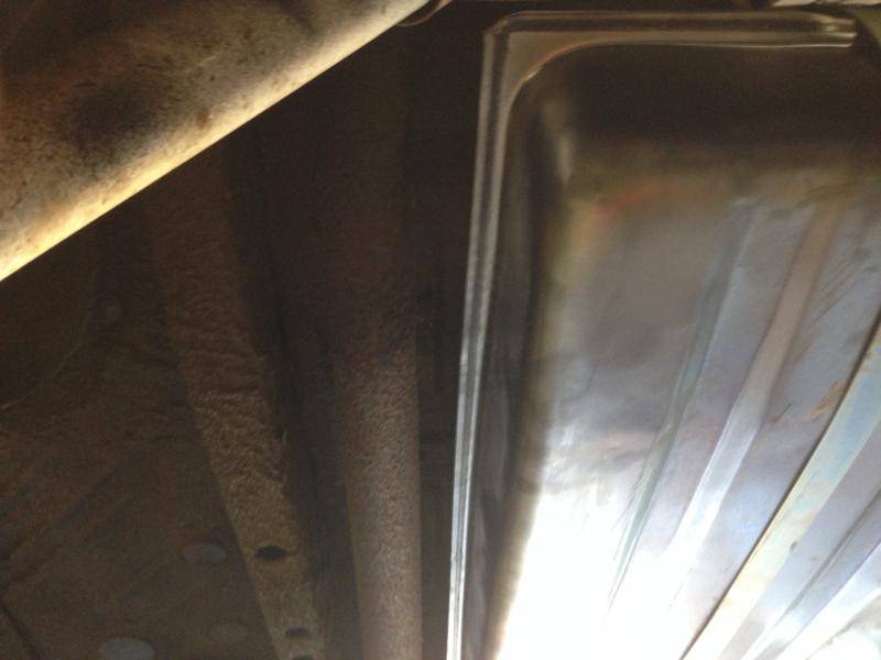

As you can see in the pics. new tank was 2 inches longer,but fit in same location without any modifications.Tank was supposedly for 67-73 C-body only,would not fit 65 or 66.View attachment 56724View attachment 56725View attachment 56726View attachment 56727
That "looks" like the correct tank for a '65 Polara/Monaco.
