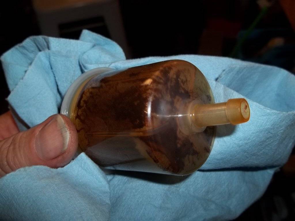

Picture's worth a thousand words right? This is filter number 3 or 4 within the last month.

It looks like rust scale...I would attempt to wash it out with metal prep...that should remove most if not all the rust...and agree with back flushing the lines.
I always try saving them, for the sake of originality and cost savings. My '70 Newport convertible was sitting for twenty years (with a few yearly firings and the odd jerry can thrown in). It's fuel looked just like yours. I didn't remove the tank just the sender, sucked out all I could, back flushed the line, replaced old sender, new filter (clear one), filled 1/4 tank. Drive with sloshing in mind, lots of hard starts, stops and corners, hit some train tracks for good measure, inspect and replace filter when needed. Keep filling quarter tank at a time. I went through about three filters in 300 miles. Once it was running clear for a few hundred more miles, I replaced the sender, all hoses, pump and filter (steel one). That was 5-6 thousand miles ago. Every scenario is different. It worked for me, but it could have been an exercise in futility. I usually do things the hard way though, family trait. Should have mentioned, when I replaced the steel filter 3000 miles later there wasn't any signs of rust!
