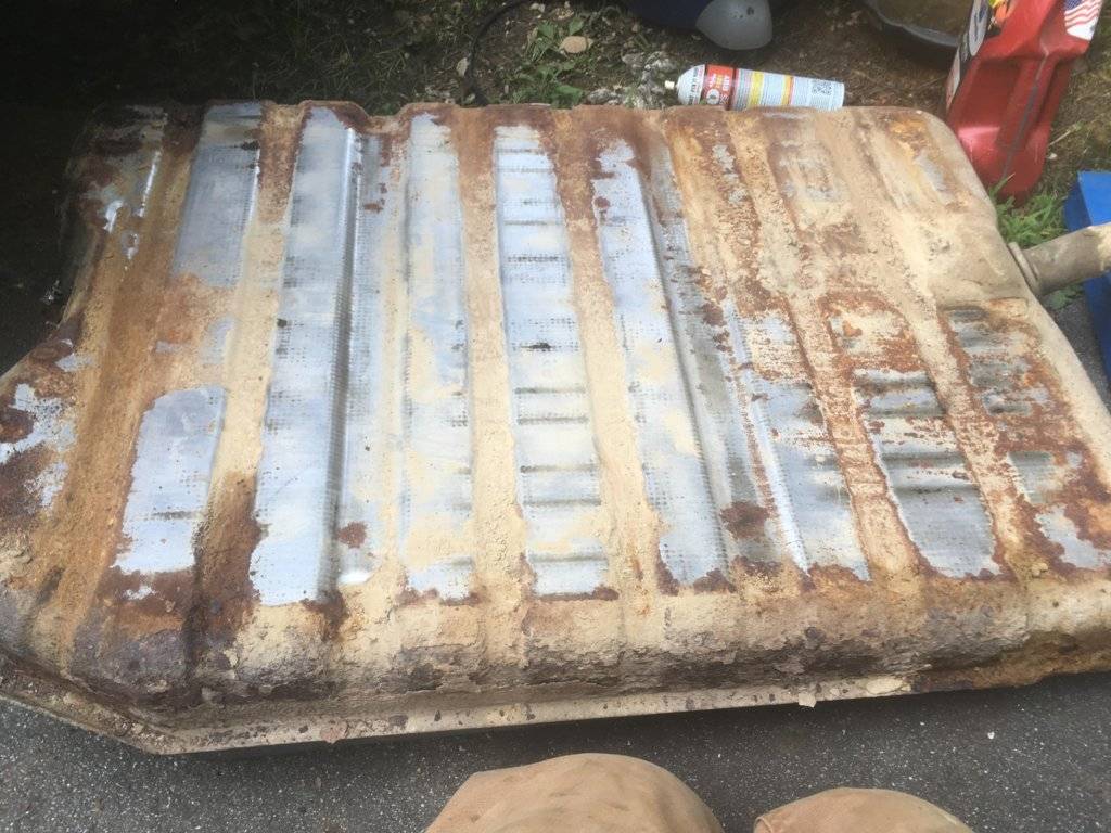

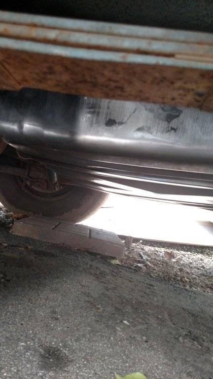

If you can I would replace tank like Big John recommends. In my case there was rust throughout system and worked it's way to the carb. Everything replaced including lines and carb.
I guess for a couple hundred bucks it would be easier to replace the tank. I will have a few hours into cleaning and recoating it and probably still have junk when I am done. Thanks guys.

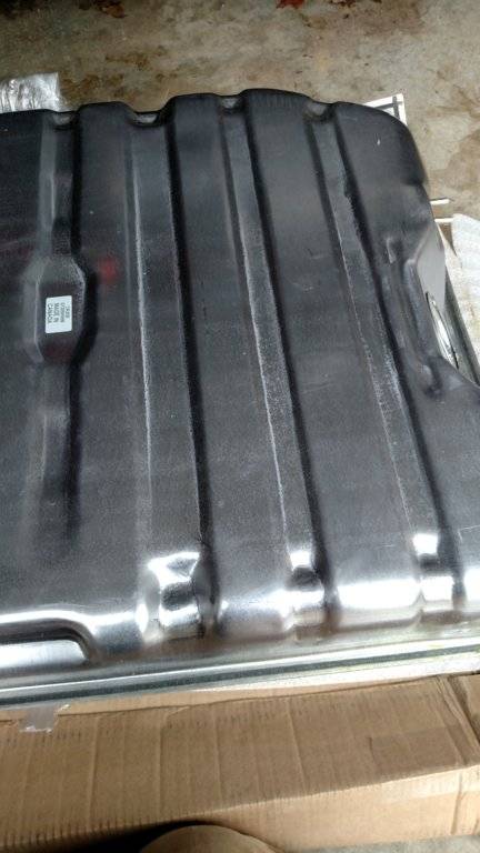

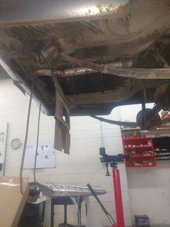

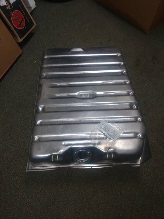

This is second new tank photo going in from 2018 shop photos on the 4 door. Shop says it's installed. I don't believe any problems during install. The new tank put in the 72 coupe leaked at the sending unit so they fixed that after a small hurdle. Works great now...no leaks.
Usually want to keep the old metal lock ring, the new ones that come with the new tank are a POS.

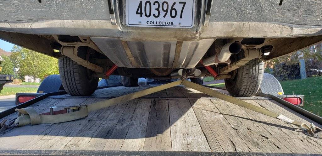

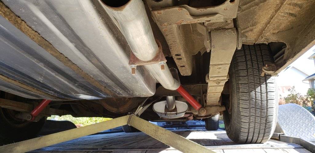

I'll be dropping the tank from my NYer sometime this month, and replacing it with a new one.
The prices on new tanks will vary by year, but if you have any AutoZone stores in your area, you should check their website.
If they have the tank you need, you should call them to place your order. My local AutoZone prices seem better for the tank I need, that what they are selling for on eBay. Might save you a few bucks.
I just ordered a Spectra 4 vent tank, for $279, through AutoZone, and it will be delivered to their store w/o any shipping fees.
New tank went in Sunday. Didn't take long at all. Fuel gauge isn't working now, but I'm not too worried about it at the moment. Getting ready to pull the worn out 383.
