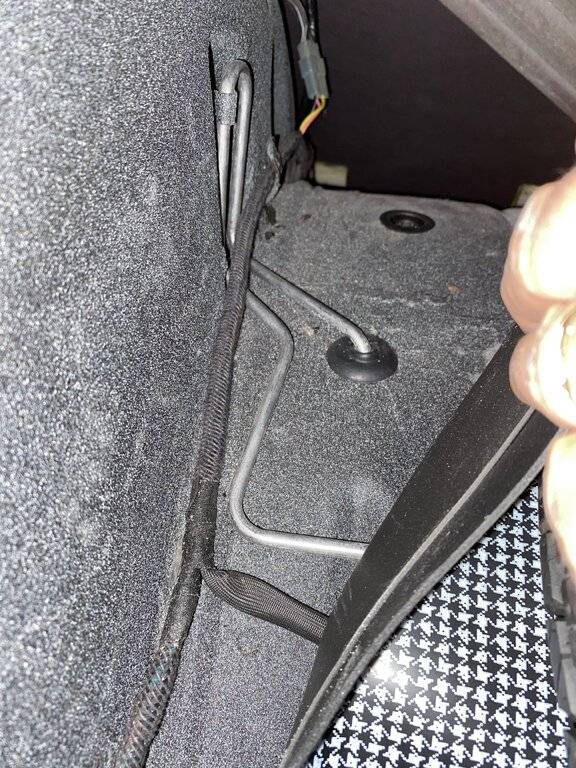

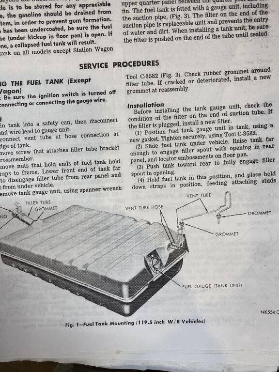

From the FSM. Goes up into the trunk across the hump under your spare tire, over to the left rear fender well, up the fender well about 3” then loops down back through the trunk floor and into your frame rail. You cannot see the end of this one unless you pull the line out of the trunk. If you take the small rubber hose off at the fuel tank you may be able to blow it out with an air hose if it is blocked. You didn’t say how new or old your fuel tank is. Also could be varnished over from fuel sitting for every. Get your fuel level down low and lightly blow into the tank to make sure both are open.
Also make sure the vents are hooked up to the proper vent tube. If I recall one is at the rear of the the tank and the other at the top front of the tank which could be submersed when you hit your brakes. I had pictures of the inside of the tank somewhere. But if you use the service manual picture as a reference you should be ok.

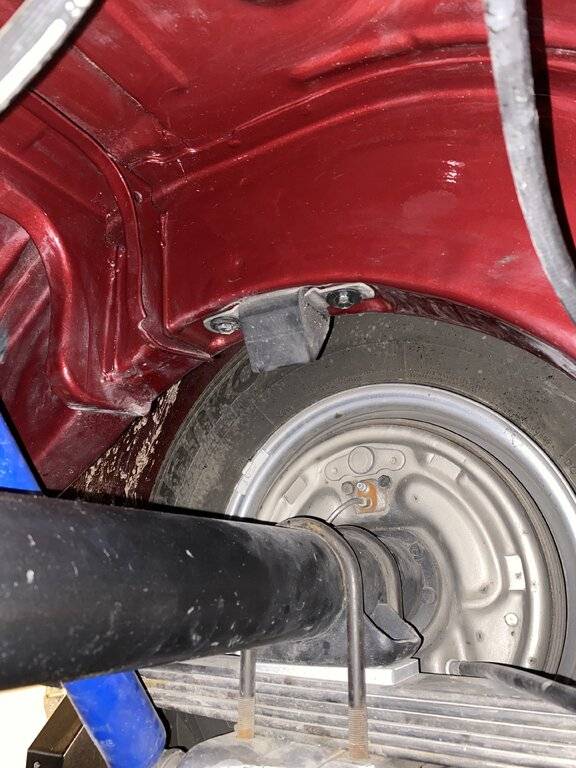

The trunk one comes out in the frame just above the axle bumper.
I need to check/clean out this vent tube, as mine still leaks gas out the short vent occasionally after fill-ups... thanks for the pics!

Thanks for the service procedure, photos and advice everyone. I appreciate it. I removed the long vent tube in the trunk last night. Blew on one end…it’s wide open. Thought perhaps it could be bottoming out on frame rail (and blocking open end) but it isn’t. I inserted a long thin stiff wire to measure distance from trunk sheet metal to bottom of frame rail…it’s way longer than the vent tube end that goes downward. Now I’ve got to get under car again and make sure the short tube/nipple is open on gas tank side. The other (short) vent tube has to be open because that’s the one puking gasoline every time I shut engine down. They’re hooked up correctly according to photo on service procedure…thank you, very helpful. Strange happenings here. The car has been doing this ever since I bought it 5+ years ago.
