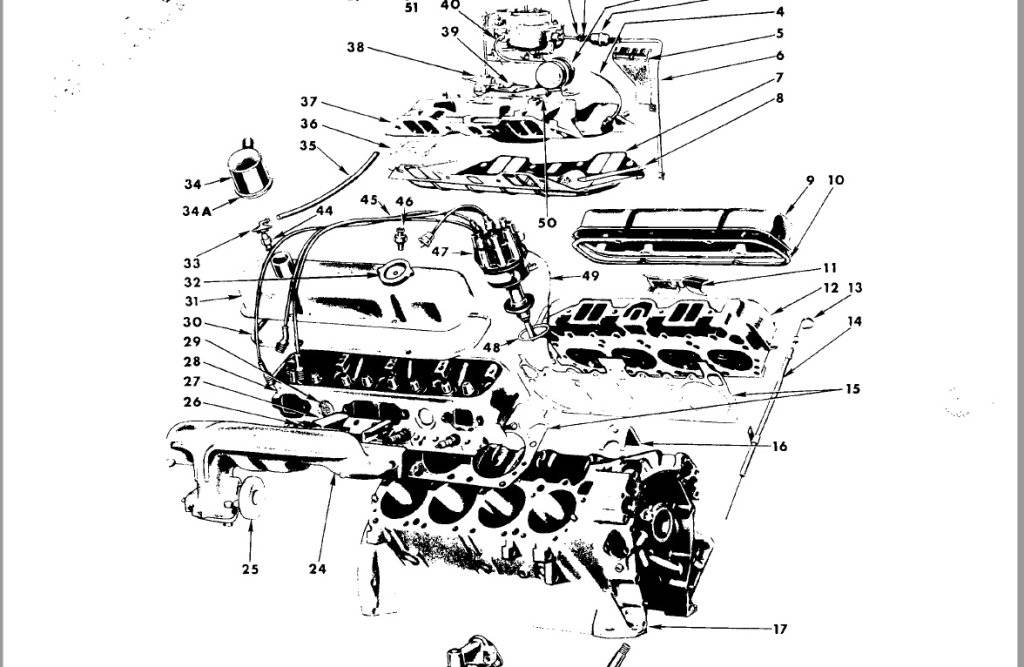

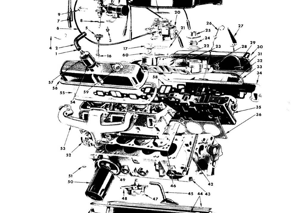

From everything I've ever seen, the big blocks didn't use a gasket and the small blocks did.
From the 70 parts manual:
Small block, note gasket.
Big Block, note no gasket shown

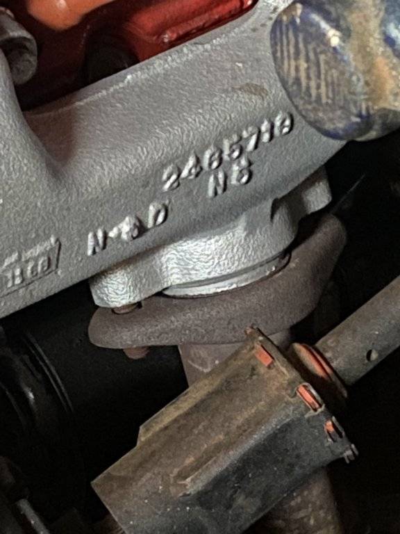

Still wrestling with this exhaust leak problem. Thinking now it could be at connections between exhaust manifolds and crossover pipe. There was nothing in either connection when I took apart. In another thread I saw you guys talking about remflex graphite gaskets and some very good results. Perhaps this is my problem now? I put exhaust manifold gaskets in between heads and exhaust manifolds. I’m reasonably confident all is good there now…but still hearing the tick tick tick. Hate that sound! To me…the connections to the pipes look like ball and socket type that don’t use gaskets. Ive attached photos of each side…passenger side doesn’t show much but driver side does.

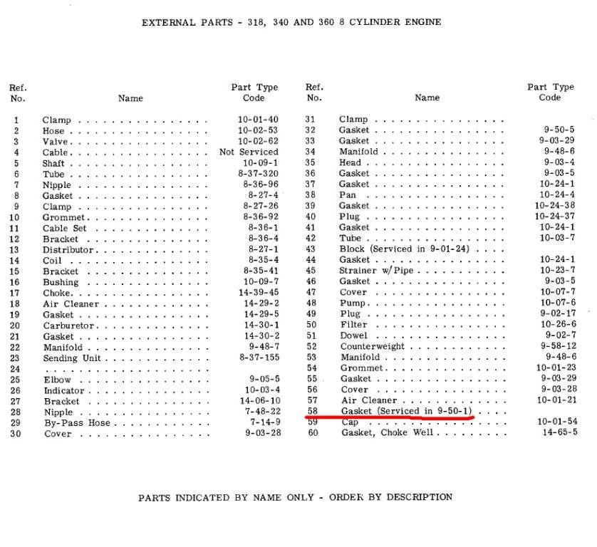

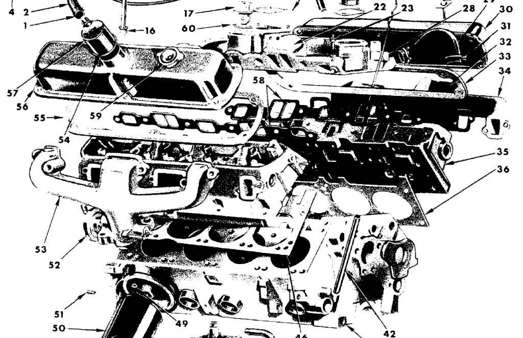

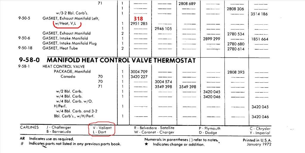

Welp during this mornings eyesight check John (him or me) I don't see any exhaust gasket in the parts illustration, I hope he isn't confusing #58 which is the intake manifold gasket.
Now the fun part of deciphering parts manual numbers, #58 just mentions gasket but a reference to 9-50-1,
onward to text page 9-16, 9-50-1 engine column shows GASKET SET, Intake Manifold (correct)

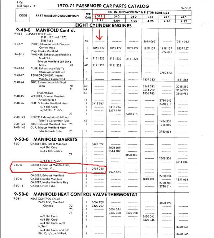

but if we scroll down we see that there if a 9-50-5 GASKET, Exhaust Manifold Left, in the 318 (column)
but notice the car line of V, L which stands for (scroll to bottom of page) the Valiant & Dart line. I don't know what the w/Heat stands for, Heat Riser? Interior Heat?
So it seems to be there is a factory exhaust gasket that is not shown in any illustration's that I can find but for only the left side for some reason and on two car lines. V8 in the small car line with a smaller engine compartment means more heat? Of course this I'm sure can vary by year.
Only MA Mopar will know (or any super duper parts guy).

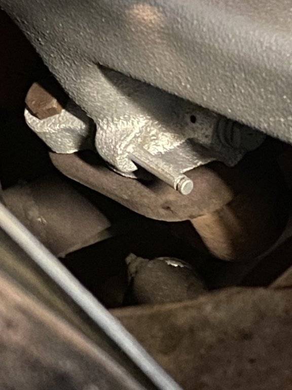

In this picture it doesn't appear to be much 'meat' of the Y-Pipe bell end above the flange clamp. If I remember all I saw in the old days there would be a visible substantial amount of metal above the clamp both in thickness and material.
Rust on the clamp and pipe appears that it is fairly old and maybe a poorer aftermarket quality and the clamp maybe distorted (pulled up) and not applying enough force to seal correctly.
Try another new quality Y-Pipe?
Plus also you can wiggle the Y-Pipe pipe up & down a little bit, maybe the rest of the exhaust isn't hanging right ie Midas shop non OEM hangers.
I was mistaking that... and looking at the illustration (and in my defense LOL) it could be confusing....

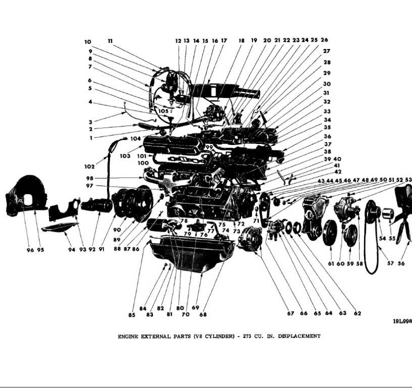

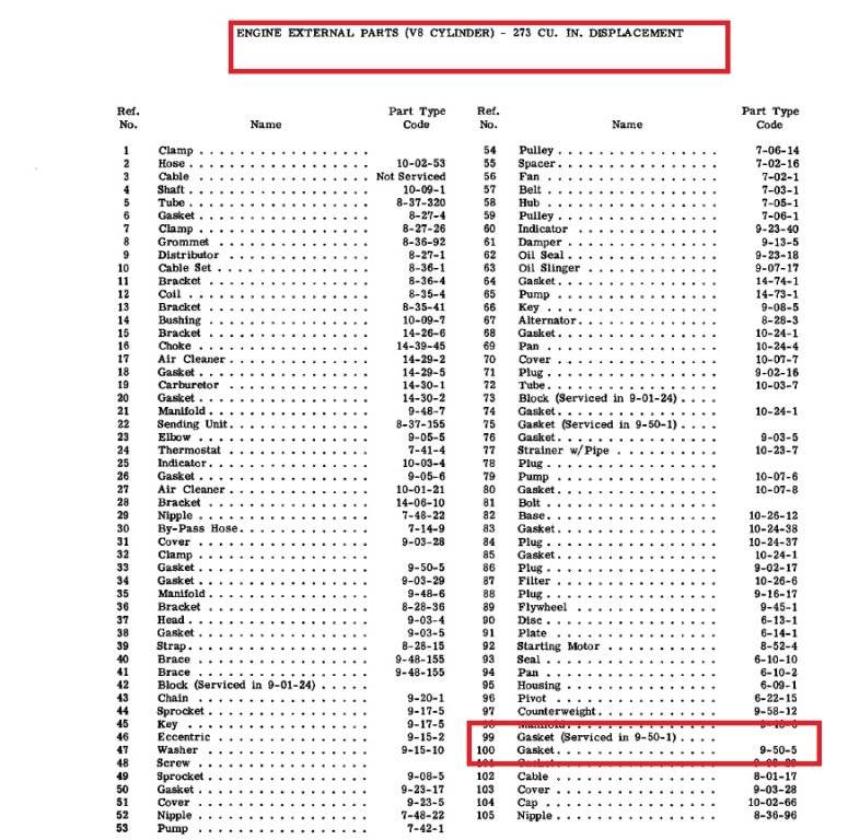

Of course, my 273 in my '65 Formula S Barracuda does list an exhaust gasket/spark plug shield and the other 273 cars use an exhaust gasket.
See #99 and #100 on the '65 parts manual. (you may not be able to see these after they got reduced in size). This is probably where I got that small blocks use a gasket. They must have stopped at some point before 1970.

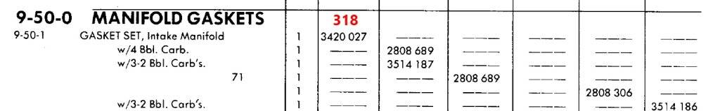

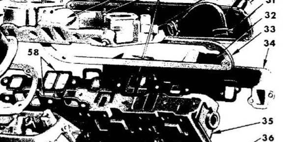

While it's difficult to see, it is in the pic. #58 is the intake gasket, #34 is the exhaust manifold, and #32 is the exhaust gasket. You can see the right most port of #34 is the same as shape as the one directly left of it:
I never use gaskets on iron heads but always use gaskets on aluminum heads. FelPro has some great gaskets that I use from a 69 high performance 440 application. Also FelPro has excellent valve cover gaskets from that application that are made out black fiber and never leak. I haven't had a small block but every small block does have the gaskets.
Oh yea there it is, I'll bet you can see it better in the original printed parts book as these .pdf scans are not all the best quality with the illustrations. Again though it appears to vary by car line and as the OP didn't post his exact application we have to do some detective work as to what car he is working on. Via his small profile pic I think I see a 1968 Fury HT but there is some mention of a 1970 and I don't remember the 1968's having the bell mouth flanges, all the ones I had were a flat flange with a gasket.
