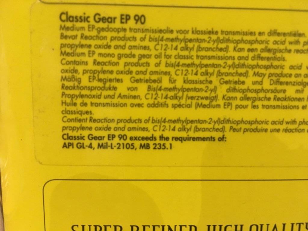

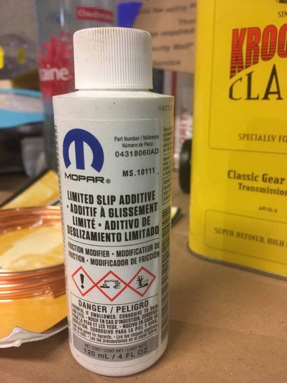

    8880C466-D09D-4CD9-86D1-FE3AA34C58CD.jpeg F19FEBC3-7248-45AE-B0D0-A6913D2F8371.jpeg 0EA387DD-1239-44EC-862C-C4451E0B19DF.jpeg Hi, i’m looking to replace the oil in the rear end of my ‘66 Fury.
    Question 1: I have 2 litres of EP90 gear oil, API GL-4, for classic car use. Can I use this or is GL-5 called for?
    Question 2: How much limited slip additive do I have to add (Mopar MS10111)?
    Any toughts?

    Never heard of that brand gear oil before.
    Is it for cars of the 20-30-40's?
    It appears to be a straight 90 weight not a multi viscosity type oil.
    Nothing special about the gear oil requirements for your car.
    80w90 and the conditioner is fine.
    GL5 synthetic 75w90 or 75w140 works too.
    Once you go synthetic you cannot go back to regular gear oil.

    Thanks for your answer.
    Kroon Oil is a Dutch oil company, they have a big classic car range and their products are distributed in Belgium as well.
    It’s a mineral monograde oil that should be compatible with old seals to prevent leaks.

    Doesn't it say how much to add on the bottle?

    The package says 2-5% by gear lubricant weight, which is quite a margin. I’ll probably go for 5%...

    The last one I filled up I used 75w90 and the whole 4oz bottle of friction modifier.

    I am wondering that too. And I had to look up the product mentioned because the can says "transmission oil", as suspected it's straight 90 weight and will be good. I also always use the full bottle of additive.

    It meets GL4 specs. If that rear calls for that oil Bob's yer uncle.

    I use a full bottle of conditioner.
    Although not necessary but have access to a hoist, i run the car at idle in gear on the hoist to circulate the conditioner.
    A good drive does the same.

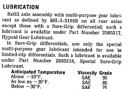

    Thanks for your replies!
    I’ve just bought some Castrol Syntrax Universal Plus 75w90. (As per your comments decided to use a more modern multigrade oil). The oil can be mixed with mineral oil and should not degrade any seals.
    I’ll also add a full bottle of conditioner.
    Enclosed you can find an excerpt of the FSM with the original requirements for completeness.
    Thanks again!
