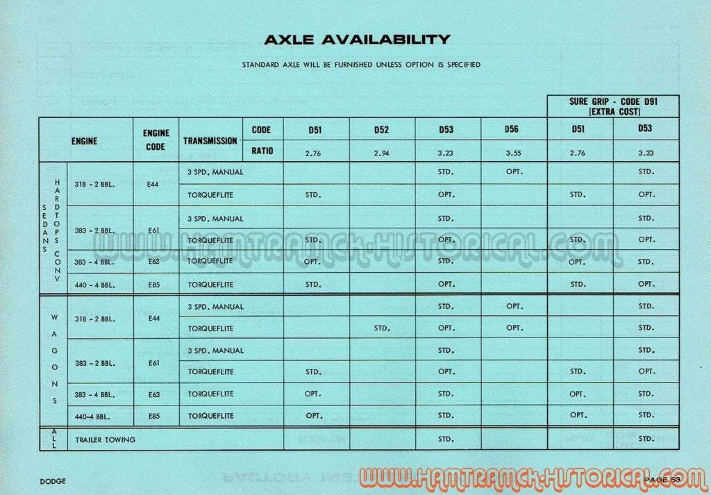

See attached from the 1970 Dodge Full-Size order information I just found at Hamtramck Historical.
